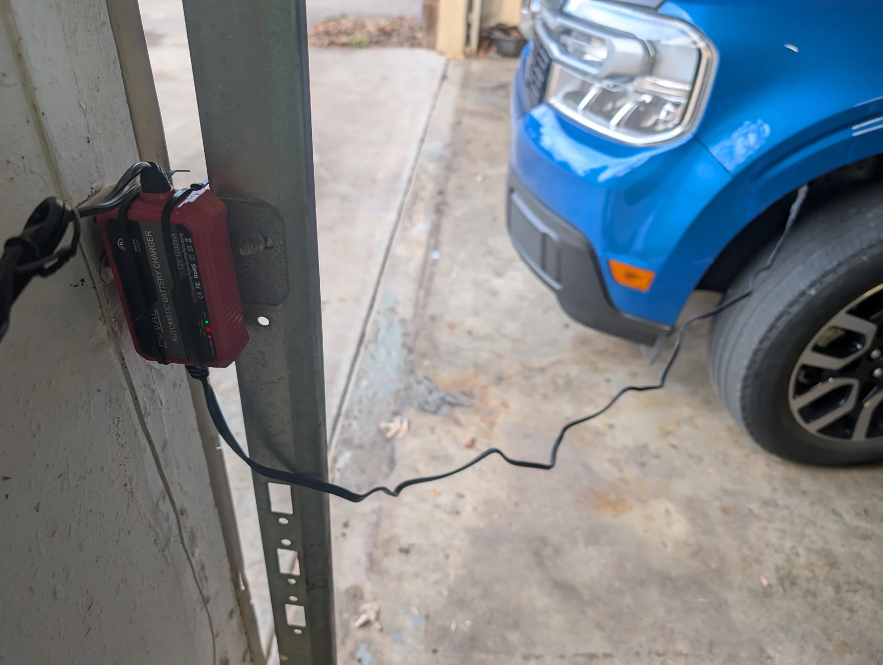

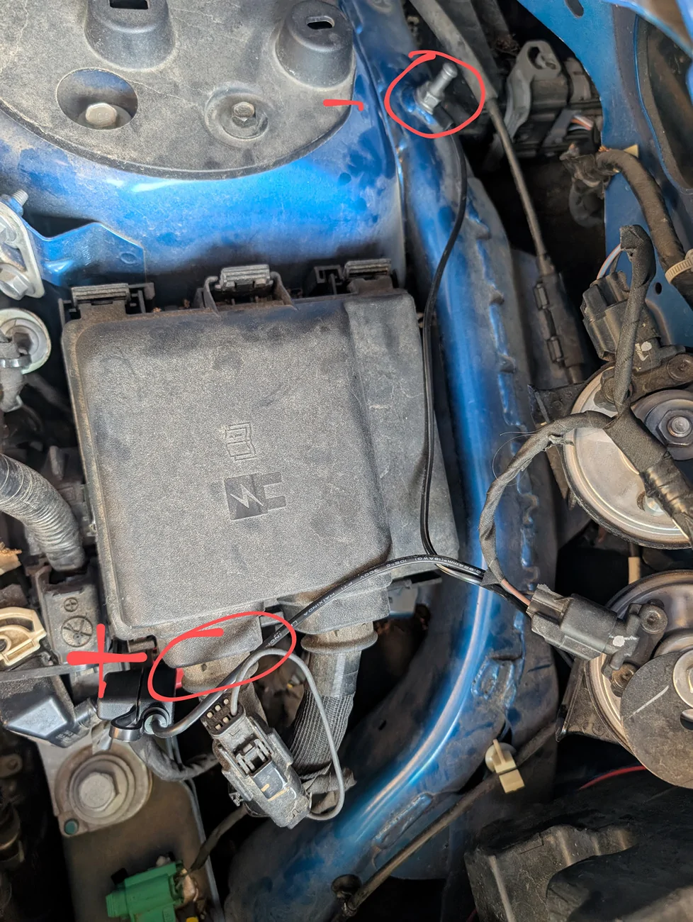

Hard wired a loop connector end of a $15 trickle charger to come out through a spot in the fender well. Plug it in once a month or so.

For the less aware of us, could you take a picture of how you connected to the battery? Not certain what you mean?
I connected the end of the charger attachment to the jump points under the hood. A nut on the positive connection, and the negative post comes off, attach connector then re tightnen.
Thanks! That makes sense now!
