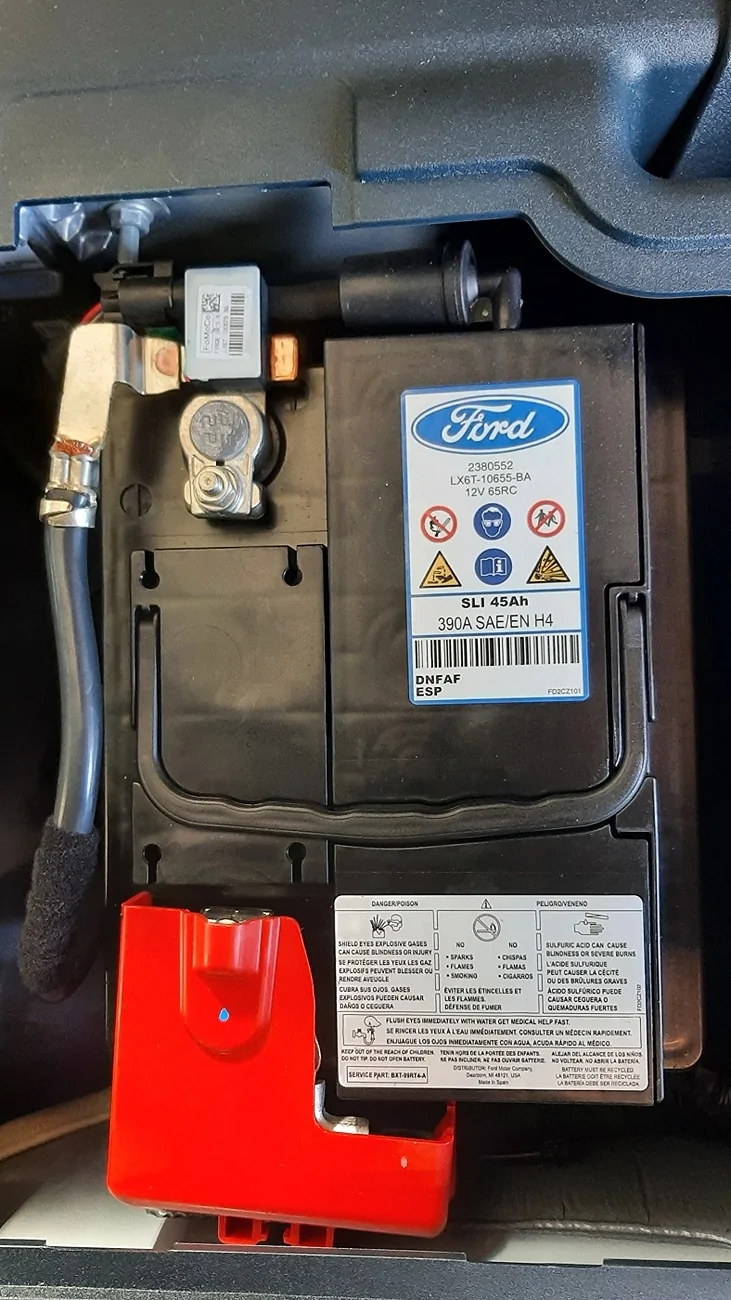

Finally got this forum to post images...I guess it doesn't work with Brave browser.
I do believe this is the original battery, but with all the warranty work due to recalls, I don't really know. Tempted to just try the AGM battery. Just drove the truck around for an hour or so, not sure it really helped. I need to pull fuse 11 still. I appreciate this forum and the information provided.
HeyBales
May 3, 2024
5,101
4,771
KC Metro area
That is.
Neg posts appears to say made 35th week of 2022 - really nice life, made in Spain like my 1st one was.
Mine made it 19 months since manufacturer date.
Oh - if you don't have a charger at home (because wall electric is cheaper than engine/HVB electric), you only need to let the truck be in Ready mode - don't need to drive a get tire wear and use even more fuel.
It's built in charger doesn't care if you are driving or not, nothing will change sitting or driving.
If like all those with scan tool logging - it went to float charge around 15 min. 1/2 amp.
It'll take hours and hours to fully charge that way - truck's charger, or wall charger.
May be easier to use the wall charger though.
