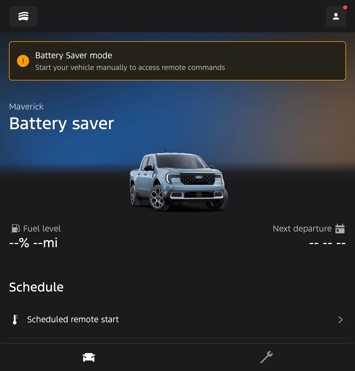

I've been to Ford three times, and the 12v battery still goes dead. I drove it 55 miles on the highway home and parked in my yard at 7:35am. It went into battery saver by lunch. I just started the truck and ran it with the accelerator to the floor board for 30 minutes at 7:30pm. That should have charged all batteries fully. The problem is getting worse with the cold weather.
This is an absolute POS engineering failure if you ask me. I'm considering a total revamp of Ford's design using one or two deep cycle batteries and a couple of relays. I might add an on board battery charger and a large inverter as well. I believe under the rear seat is about to look very different soon. The truck has bricked itself dead twice with only 6v in the 12v battery. Something needs to change for the better.
Don't waste your gas or your calf muscle.
You caused absolutely nothing different than if you just turned it On and let it sit.
It's a built in battery charger - not an alternator running off the engine. Power is coming from the HVB via the DCDC converter. ICE running or not doesn't even matter.
It's going to do it highest charge in about 7-12 min dropping from maybe 9 to 2 A, then it's going to float charge around 0.5 A from then on.
It's probably done attempting to charge above the 12.1 V line that starts the battery saving functions. Therefore it dropped quickly.
Which BTW - will save your battery for the next start, if doors are frequently getting opened/closed.
You probably need a BMS Relearn if you don't regularly get one.
Do you normally park it locked for 9 hr daily?
ETA:
Thanks for posting the new App error.
Boy did they change that up to something much more generic and less negative sounding.
Compared to prior errors.
Control customer expectations by how the errors sound - hope they didn't spend engineers time working on that one!
