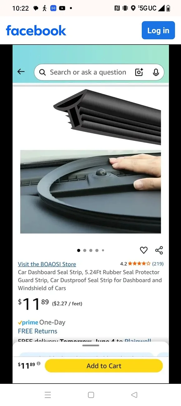

I decided I didn't want to take my maverick to the dealership over the rattle, too many horror stories from people. I saw someone else saying this worked on their maverick, tucking this into the gap between their windshield and dash as much as possible.
Tried to today, so far so good. I used to get really noticably thunking noises from the dashboard when driving over road imperfections. Took it for a short test drive of a few miles, dead silent.
You'll need to cut a small piece off the end but this seems to have done the trick. If you have rattles but are worried about your dealer making it worse, try this first.

I found it on Amazon:
BOAOSI Car Dashboard Seal Strip

Wishing you guys the best, drove it again and it was still being much quieter than that used to be. I pushed it basically flat so you basically don't even notice it. It sticks up a lot less than how it looks in that photo.
God knows I've called it too early with a lot of things, and who knows, maybe the rattle comes back a week from now. But early impressions are promising.

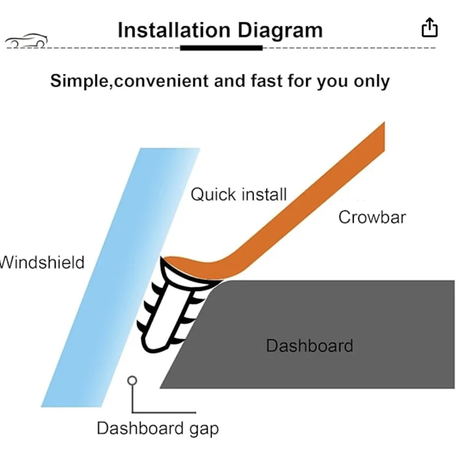

lol. i love how the 4th photo on amazon uses a "crowbar" to push it down. i dunno about that. :LOL:
Yeah the kit came with what looked like a mini crowbar which I didn't use. Using my fingers was more than enough to get the job done to my satisfaction. Oh boy that sounds suggestive...
If I had pushed it any further down I would have been basically impossible to take off if I wanted to in the future.
