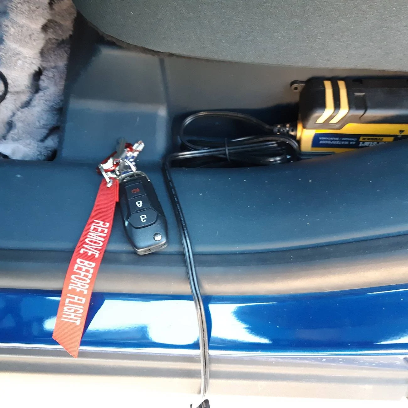

I put a reminder on my key fob.
I don't want to forget to disconnect the charger and drive off.
I'm old it happens. 🤷‍♂️

Do you leave the charger attached but unplugged ?
Yes I do.
I don't know about the OP.
since installing the charger I have only charged it overnight once. I turned off all the possible Communications with the truck and I pulled fuse 11/12.
It's been months and no low battery or problems. 🤞
Yes it's always connected. After the extension is disconnected I just close the seat over the charger.

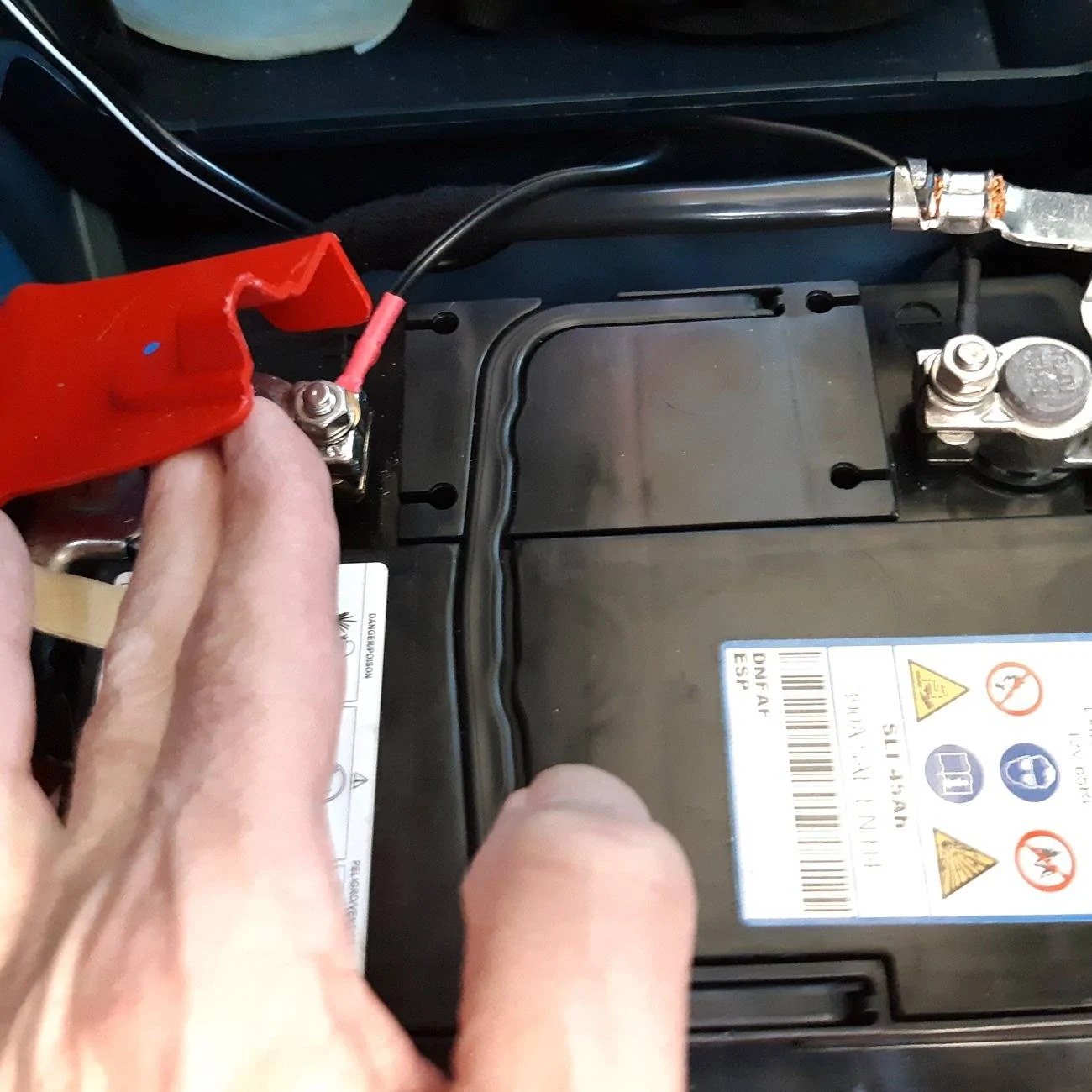

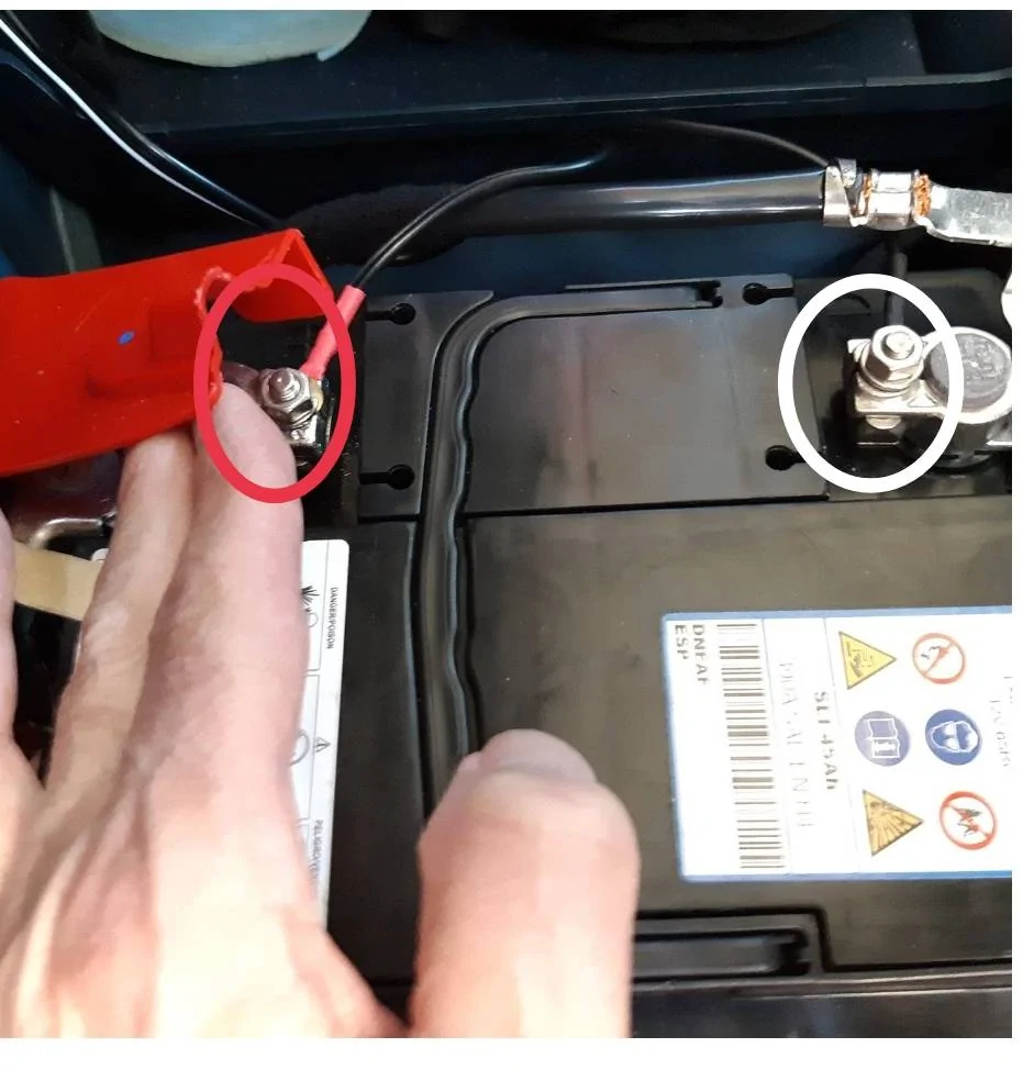

Hook the negative lead on after the BMS device so the vehicles system sees the charge.
Oops, I didn't hook it up that way. 😲
I hooked the charger leads directly to the battery terminals as shown in the picture.
It looked like a nice natural connection point and the easiest one. I chose the path of least resistance.🤷‍♂️
That was back in October. I only charged it once. Pulled fuse 11 and did the relearn. I have not experienced a low battery situation since.
I haven't had a problem. What could happen and wouldn't it have happened by now??

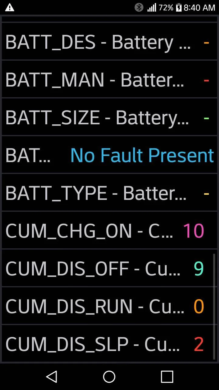

It doesn't log charged while key off.
So it doesn't matter.
Charge Ignition On.
Discharge Ignition Off.
Discharge Sleep mode.
Discharge Running.
But, it does mean you should get the BMS relearn process done after a charge up - 8hrs locked no accessories. Manual states this should be done after full charge.
Might confuse the BMS during it's test to see no battery discharge and think you've got one great battery there.
