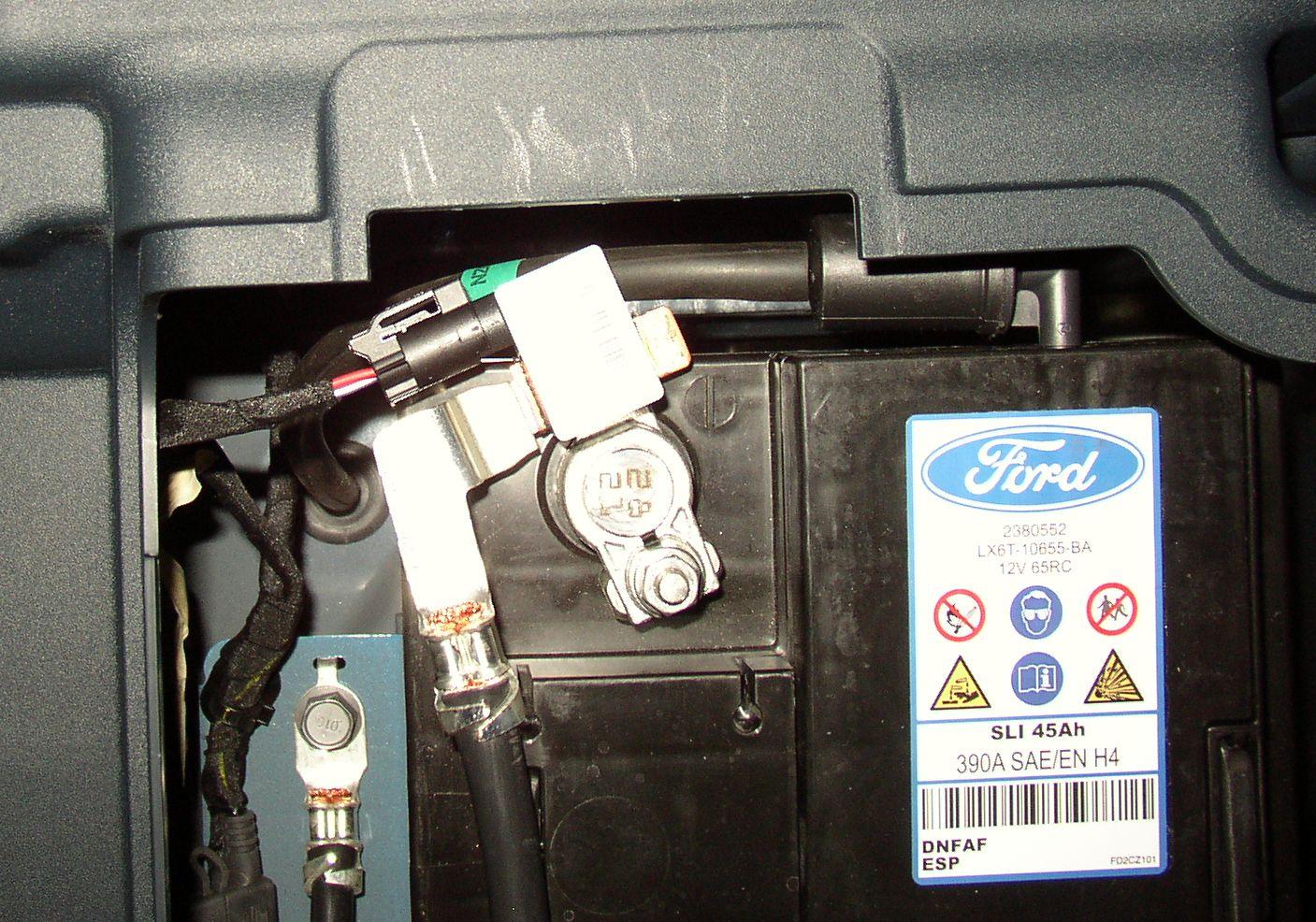

I have the Hybrid and am looking into running a 1500W/3000W start Inverter directly to battery to run what I need when camping and on the road.Have seen many threads saying it will fry a standard alternator,Local Ford tech says "should be fine" for whatever thats worth.Thanks for advice in advance for thoughts and Ideas.

Is it possible to hook it up to the spot where you jump your truck?
