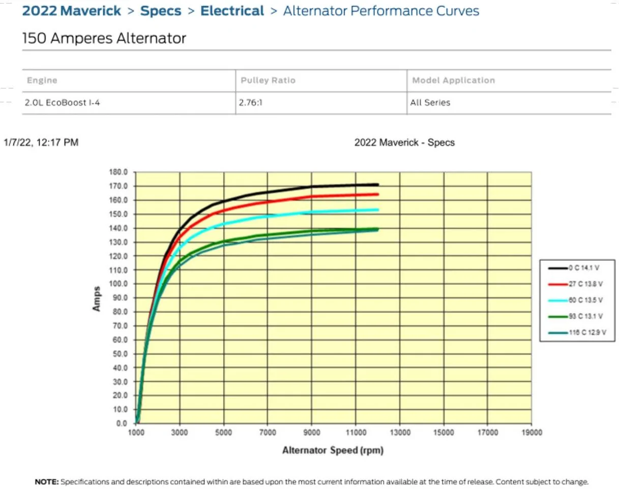

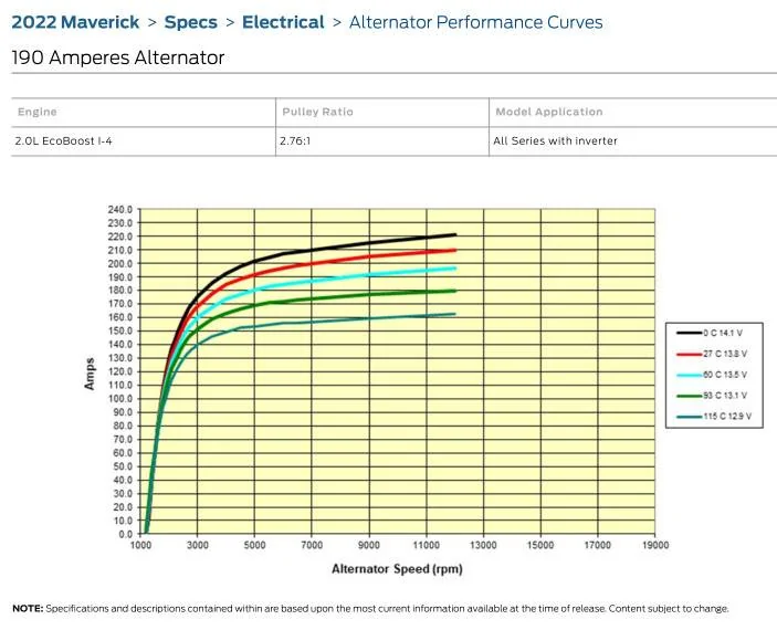

Seems the 2.0L alternator at idle speed would be the limiting factor.
My previous truck had dual 220A alternators.
2022 Maverick Specs:
Ford Maverick 3000 watt Inverter 2022 150A Alternator Curves
2.0L w 400W Inverter
Ford Maverick 3000 watt Inverter 2022 190A Alternator Curves
We usually put big inverters in our service trucks, and that has always been the limiting factor, the engine speed. So we put in 2500-3000 watt inverters, but if you're just idling at the job site and using too much from the inverter, the batteries get drawn down and then the inverter shuts off from the low voltage shutdown. On trucks with a PTO high idle, we turn that on and it helps quite a bit, but if the inverter load is big enough eventually it draws the voltage down if the alternator isn't keeping up.
