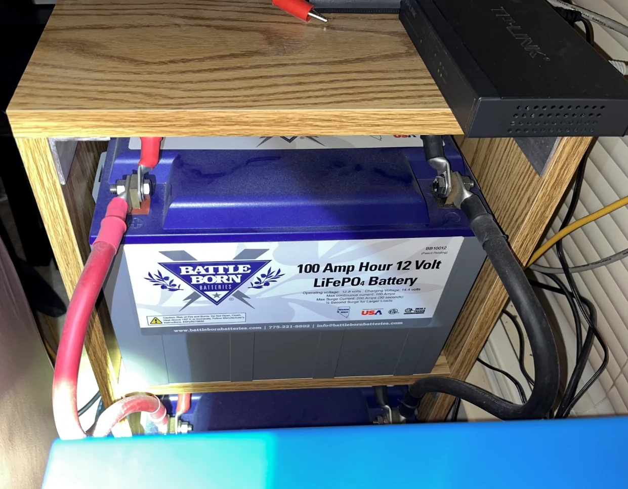

I have a Samlex EVO-3012 3kw Pure Sine Inverter/Charger. It has a 85-90% efficiency. I had to add a small radiator fan to cool the Inverter/Charger. I power it with 0/4AWG copper cable with a 400A fuse. I did a test run of the A/C. The start up amperage surge was about 2,400 watts. After start up, it ramped down to 1,500 watts. After one hour the Inverter internal temperature was over 150F.
Samlex EVO-3012
Ford Maverick 3000 watt Inverter 373360-6a206e1c81d037b915e8ac240b067d41
Six 1,000ha Battle Born Batteries
Ford Maverick 3000 watt Inverter attachment
