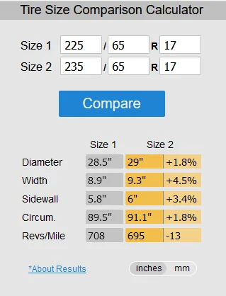

No discernable difference. The speedometer error is not worth messing with unless you are just OCD about tiny differences.
Thanks, Steve. Good poop. Re. speedo difference, I don't really care. My XL doesn't have cruise control anyway, so I am all over the place speed-wise. The truck speedo may operate off the wheels, but my garmin operates off the satellites, and probably NEITHER of them comes within the 1.8 percent. Thanks again. From what you guys say, it looks like the 235 will be no trouble. Knock wood.

An extra 1.8% of tire would tend to make the speedometer more accurate.

It's a Math thing.

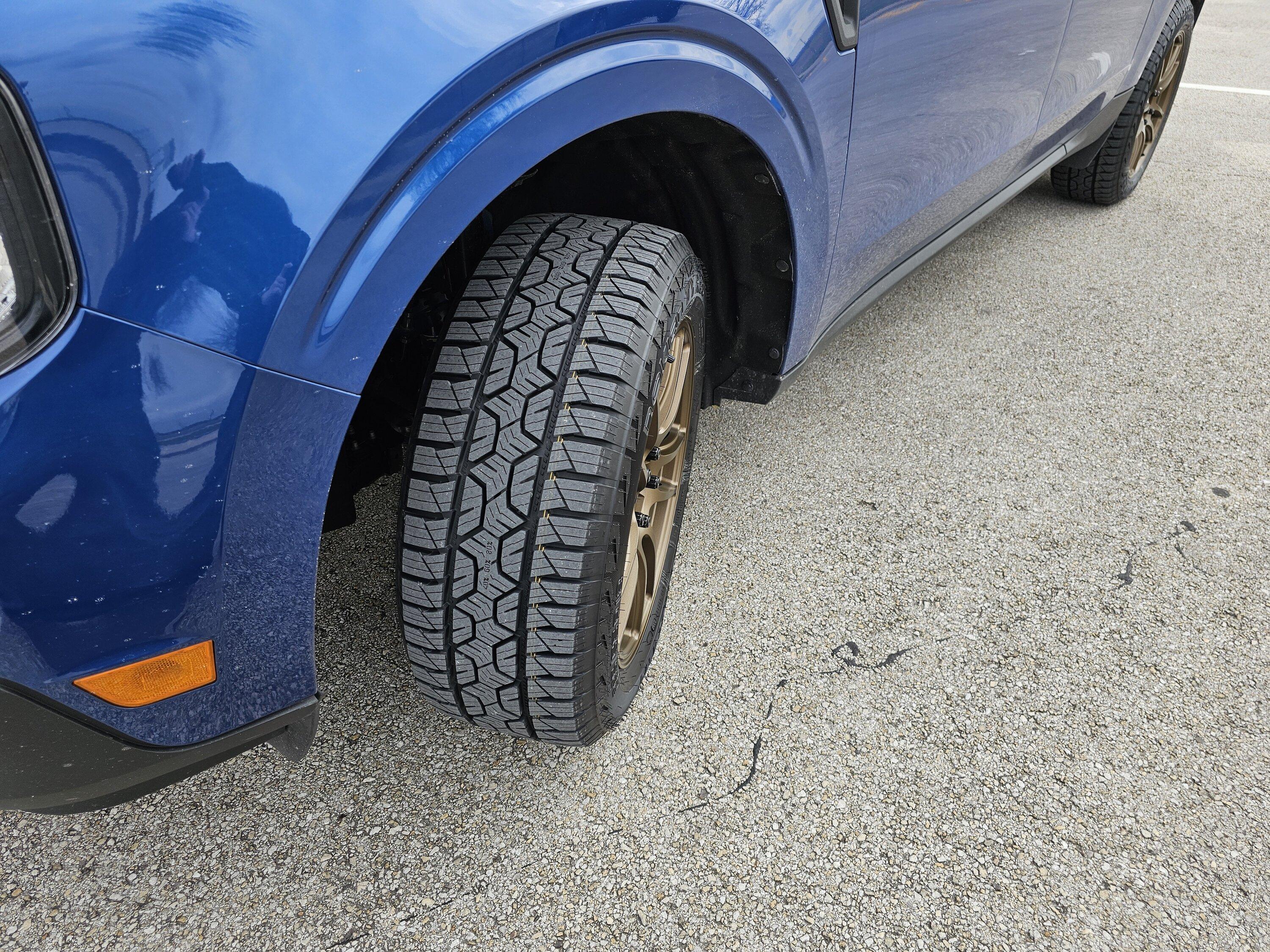

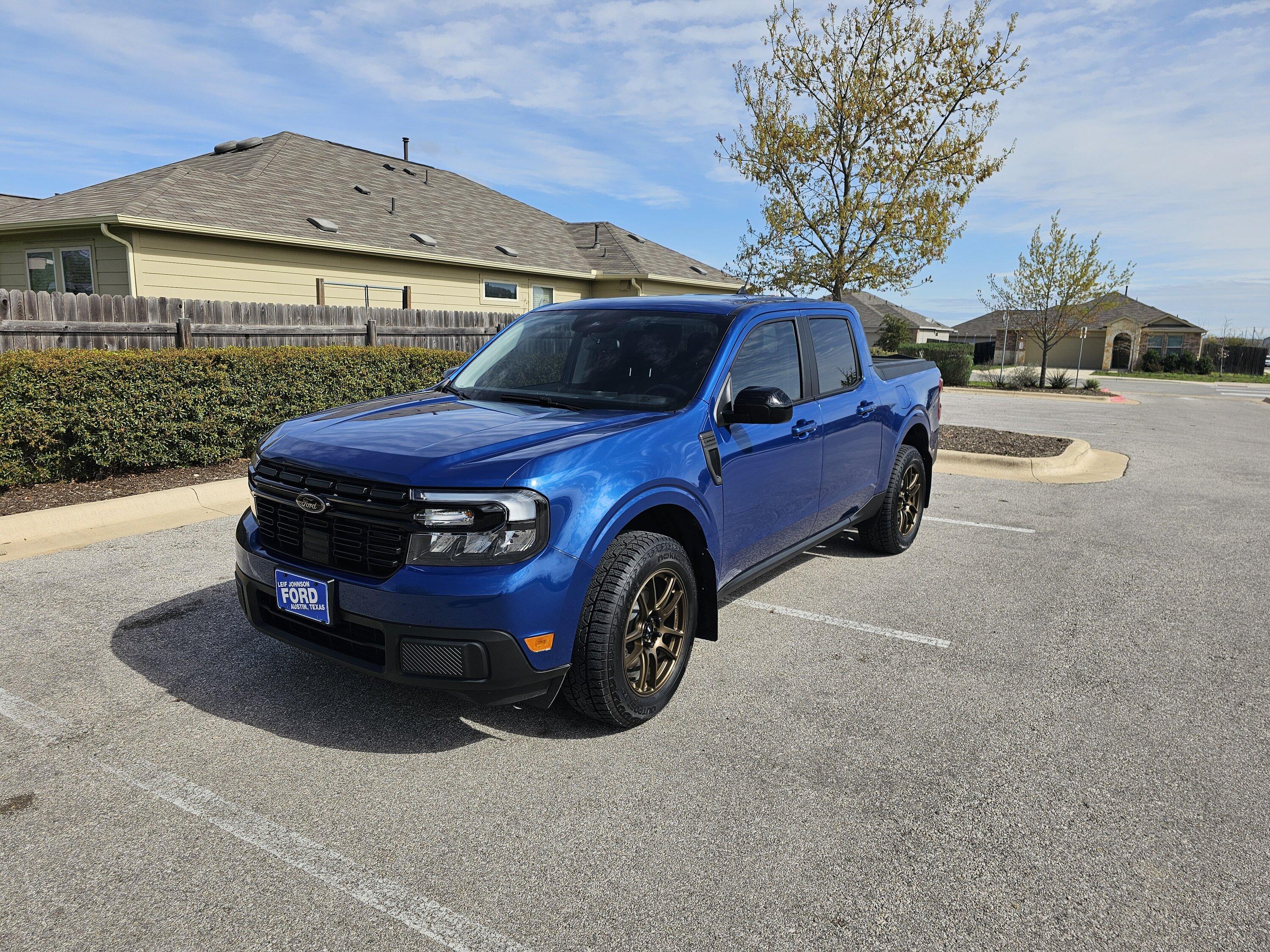

I am running 235/60/18s and like them. With the Nokian Outpost APTs there is a tiny bit more noise, maybe and mileage is basically the same on my Hybrid.
