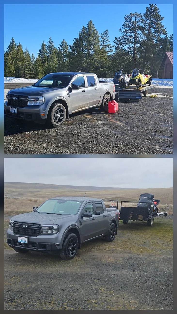

I use my pickup in the mountains snowmobiling. The ground clearance and extra traction was needed..not everyone does
I hear ya,
The worst I’m on is forestry roads, some climbing but if a logging truck can do it loaded I can do it on regular all season road tires. Mostly road bond # 57 gravel.

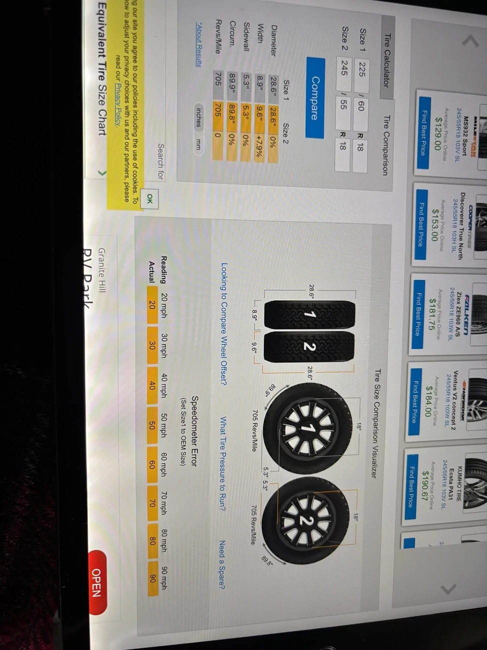

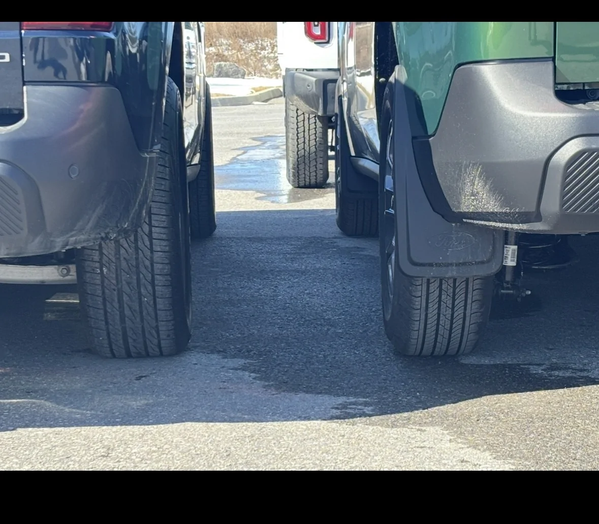

Thinking about upgrading my wheels and tires when my OEM tires are done. I am at 15k miles now and have only had the Maverick about a year. I am a 25 Fwd Hybrid. I am actually looking at wheels that are an inch wider than the steelies and thinking about going to a 235/65 r 17 or a 245/65 r 17. Anyone that has done it what has your experience been and what would you recommend? I know either way I am looking at reduced mpg due to the rolling resistance of more rubber on the ground, and the potential weight differences.

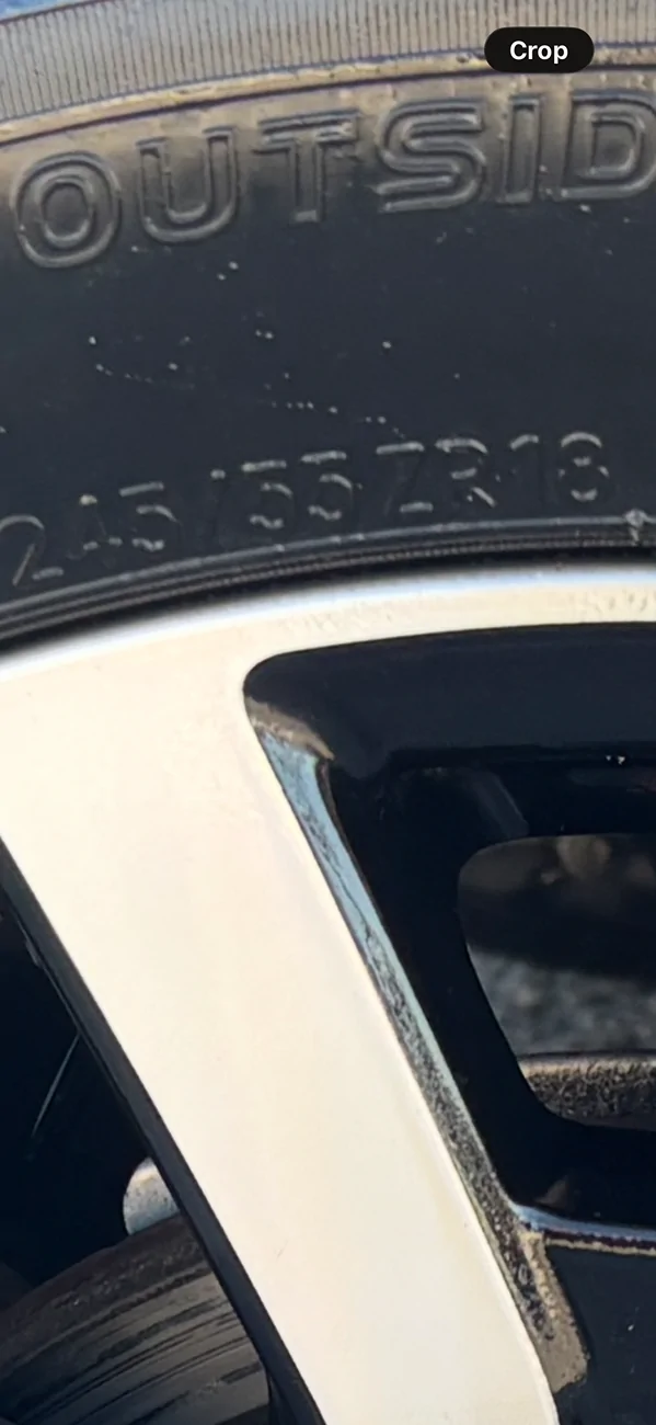

I have the stock 18 inch rims and replaced the original 225-60-18. For 245-55-18. As per the pic exact same circumference. But the biggest difference is the actual width of the treads making contact with the ground. Stock tires are about 6.5 inches wide on tread but the 245’s are about 9 inches at tread.
