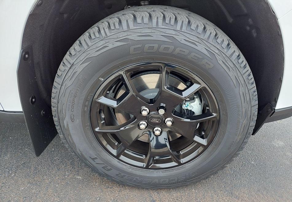

Looks AWESOME! Love the look, but for me, the look and feel must be practical. My truck is my daily driver. I head to work on the highway. I head to the shore on the weekends on the highway. For my sandy and surf passion, the 235/65 R17 works best for me. My XLT, 4K, Lux, FX4 with built in compressor makes my MAV the summer shore, surf fishing and NEPA winter truck. Let the air out..put the air back in:)

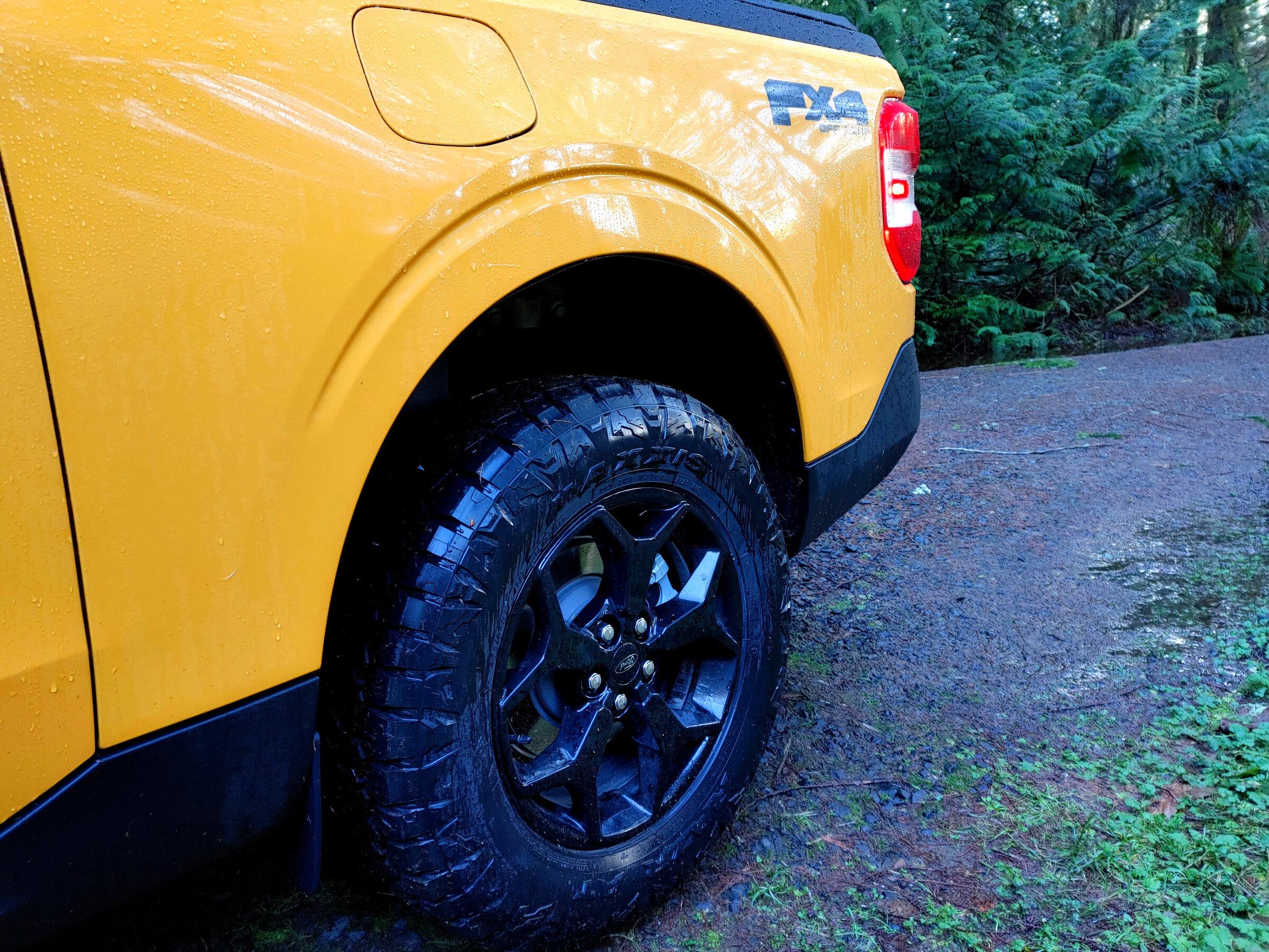

I was going to go with 235's. Tire retailer convinced me to go 245's. So glad I did!
