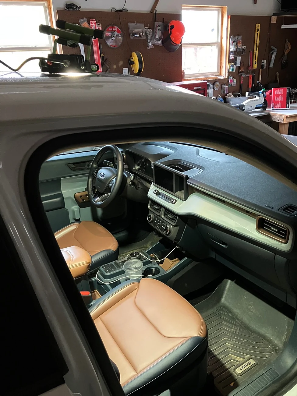

Changed mine yesterday. Original with 41k. I’m not a heavy HVAC user and I thought it looked and smelt fine, but I’m sure there’s particles that I can’t see. Also tip, if you have a moonroof a shop light on top of it provides great lighting for interior chores.

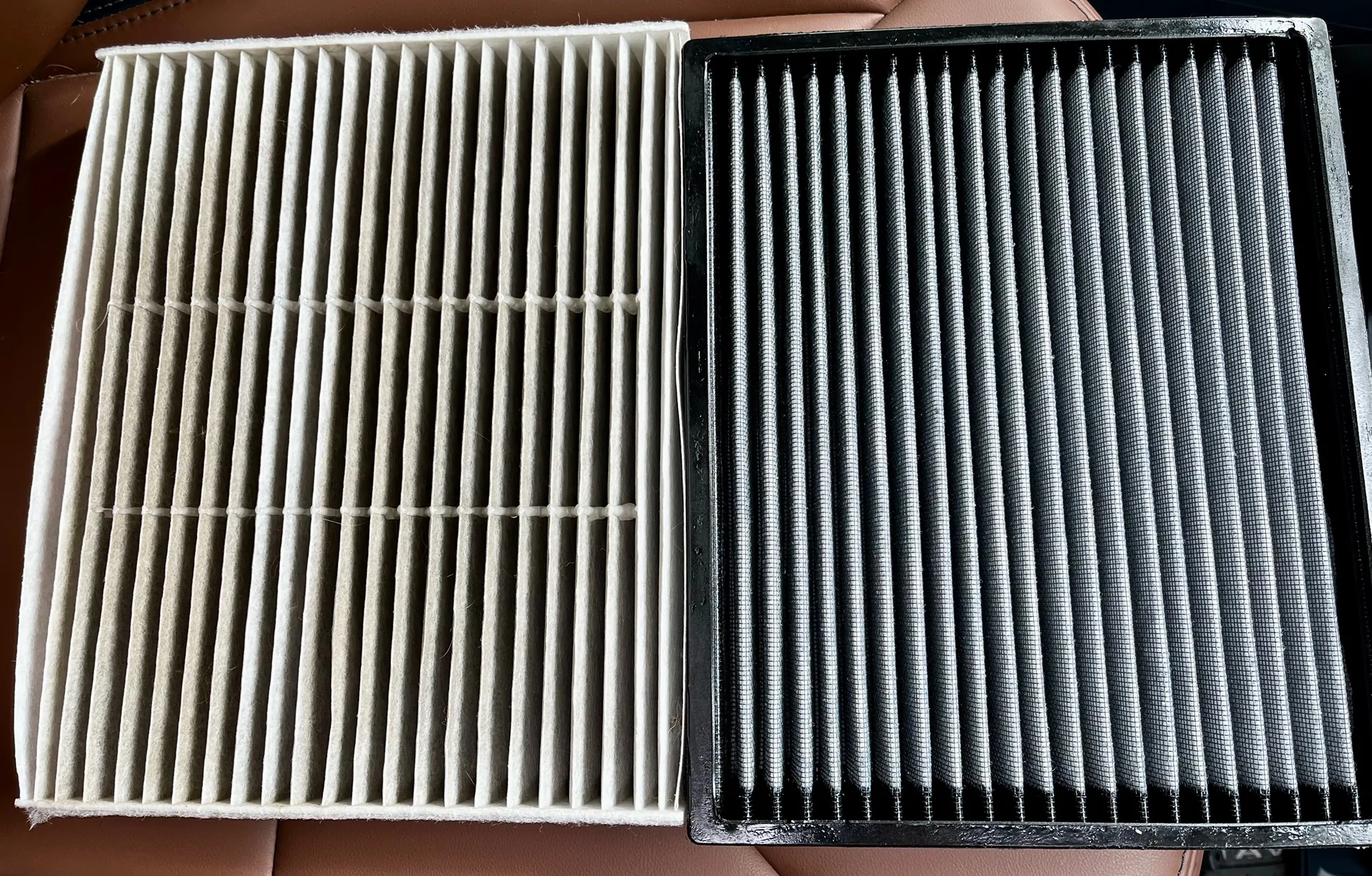

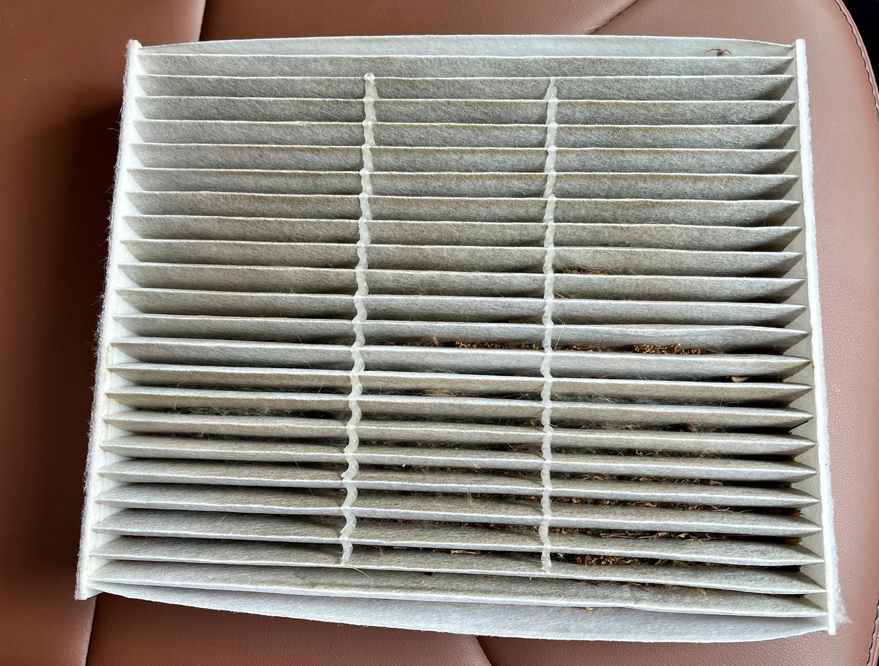

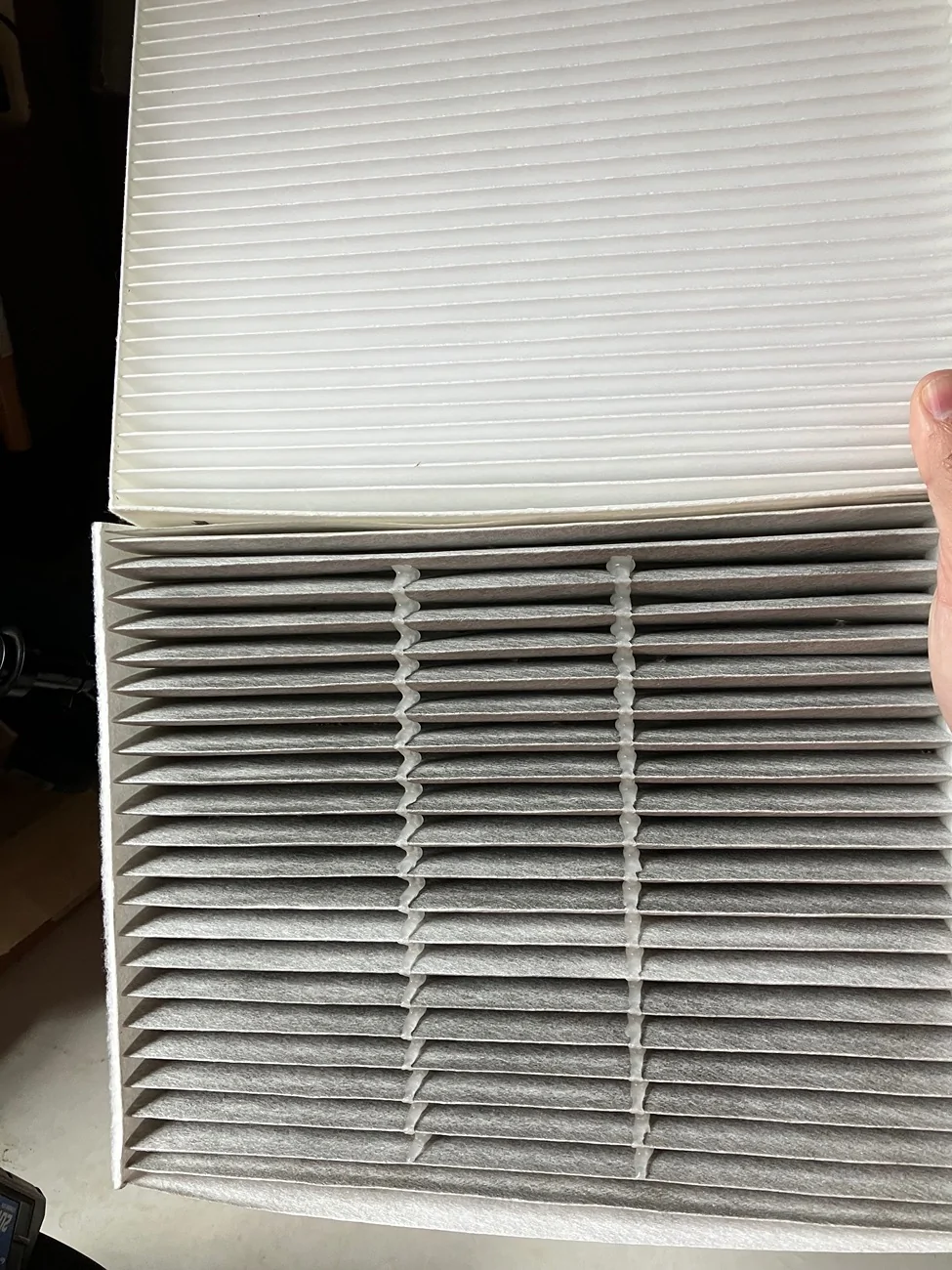

Changed my cabin filter for the first time in my 24' with 21,600 miles. Which I believe is 1600 mi over the recommended interval I mainly drive all highway, very little city and on construction sites.
This is the filthiest cabin filter I've ever seen after a tick over 20,000 miles.
I changed mine at around 6000 miles and it was pretty dirty. Just started using the K&N filter. Never tried their cabin filters before but have been using their engine filters for almost 30 years and I swear by them. They are lifetime filters, so you only have to buy it once.

Good job! Was it an easy process?
Toddman45
Toddman45
Todd
May 21, 2024
2,020
2,842
St. Louis, MO
Very simple took 5 minutes start to finish. Open glove box, release 2 tabs on each side, release dampener on ps if equipped, remove glove box, push two tabs outwards on each side of filter door, remove filter door, remove and replace filter. Then reinstall in reverse order.
