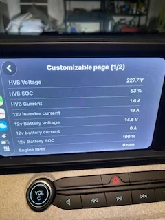

As for my 23 mav hybrid, my current drain can last sometimes up to 2 hours before my 'volt amp" meter shows .00.
I am normally up to 90%+ SOC, and can loose up to 5% over night, but can replenish it back to 90% by driving to work.
I would not say, I have the parasitic drain, that will drain the battery dead.
I have the 12v drain where things take time before they shut off completely.
I have one of these installed on my truck. (volt amp meter)
I also have "Car scanner" app installed on my truck, so I can see whats going on on my truck screen.
How did you install the car scanner app on your truck screen? Are you using Android Auto?
Packer Bill
Jun 21, 2021
1,928
2,586
South Dakota
I am using a ODB2 to Bluetooth unit and car scanner app on my Iphone with car play.
Thanks for responding so quickly.
I am using Android Auto. I finally was able to get Car Scanner show as being available in Android Auto. I am thinking that an update to Car Scanner app at the end December made it compatible with Android Auto. I will check this tonight when I drive my Maverick to a meeting.

I use Car Scanner via Android Auto. Works fine but I'm not able to get more than four (4) lines of data on the screen. Others shiw eight (8) lines of data. I assume it's a font setting somewhere OR they are using Apple Car Play, meaning 4 lines of data is an Android Auto limitation?? I'd sure like to get 6 or 8 lines if data to see at once.
