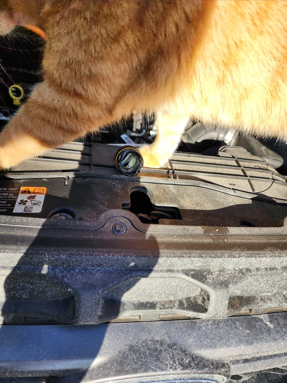

I checked my oil cap from cold, after 10 minutes idling from cold (temp gauge highest blue area), then drove 5 minutes down the road at low speeds and rechecked (temp gauge lowest white area), then drove 20 miles at highway speeds (temp gauge middle white) and checked again. Ambient air temps were 25-30F, original oil from factory, about 4000 miles on the odometer... not seeing any peanut butter.

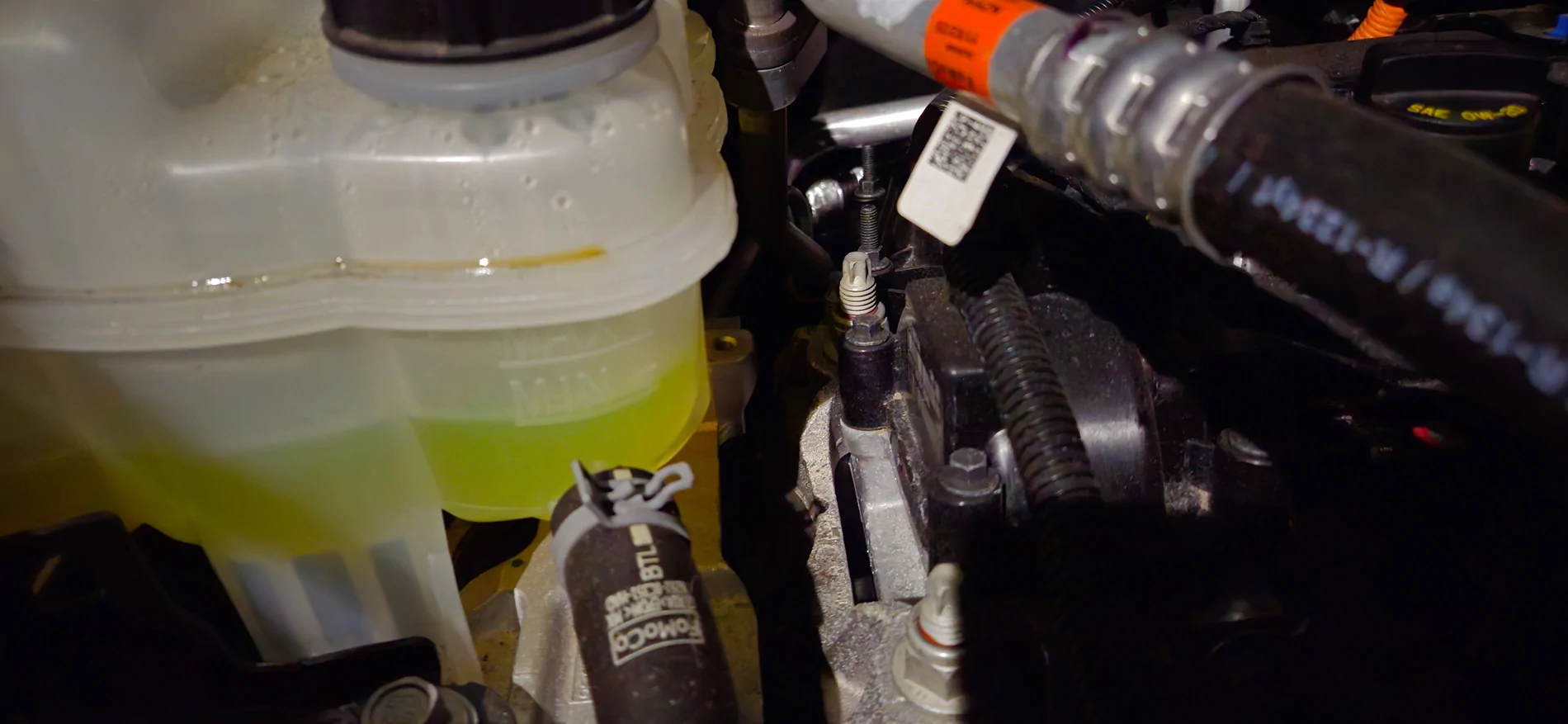

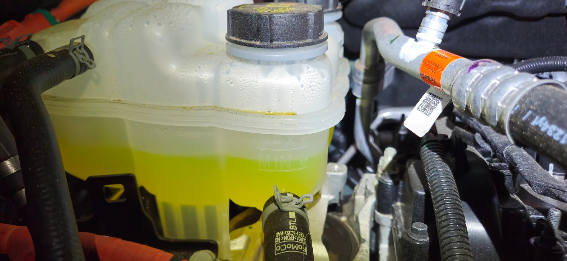

The original poster noted coolant loss and oil that isn't oily in the cap. Maybe the coolant ran down into the felted cover and is hidden, maybe the PB is just harmless condensation from his particular pattern of use. Maybe he has a defect from the factory that needs remedied and is causing coolant to dilute the oil. I don't know... but I'm hesitant to tell them to just write it off and not to worry. 🤷‍♂️
Looks good. What oil do you use?
It's what came from the factory, haven't done an oil change yet as it's still at 20% according to the oil life monitor. I'm also not missing any coolant...
