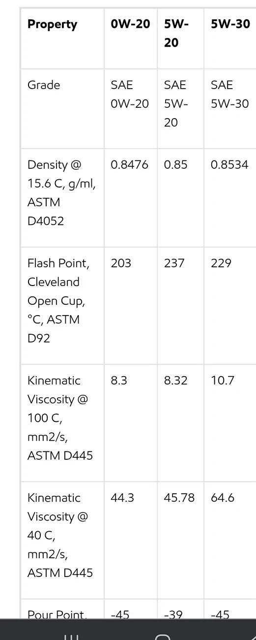

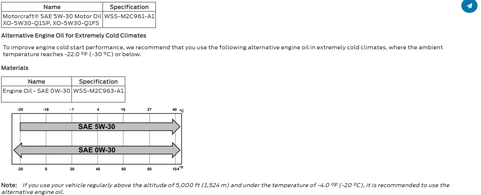

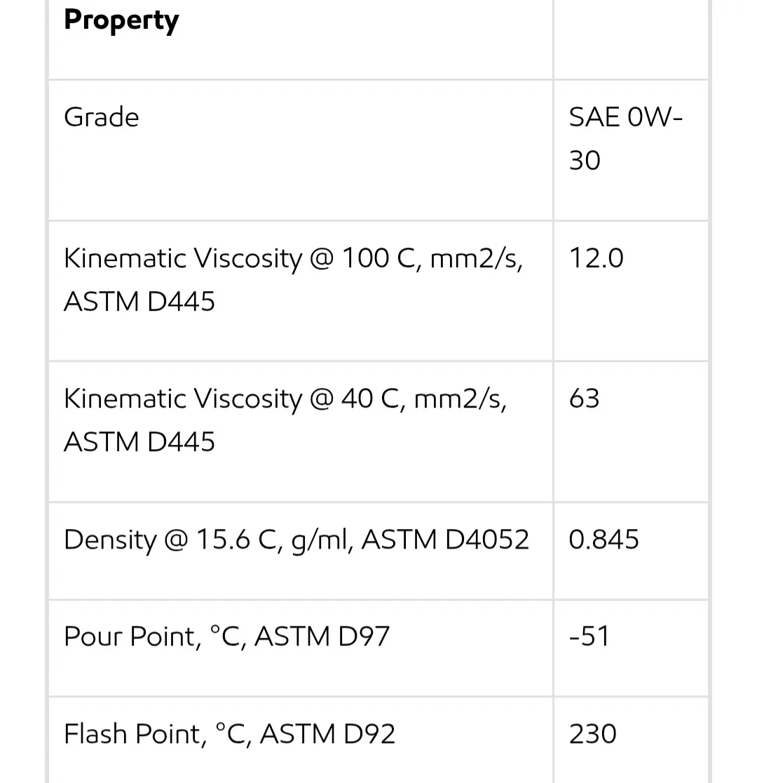

I am about to do my first oil change, and overthinking what to put in. Recommended is 5W-30 but an alternative is 0W-30 in cold climates like mine, where the temp can go below -20. The chart shows 0W-30 can be used in any temperature, I am wondering why it isn't the default recommended oil. I am suspecting it is to protect the turbo in hot operating conditions?

Look at your fill cap. 5w30. Why would you use anything else? It still amazes me how many times this topic comes up.
