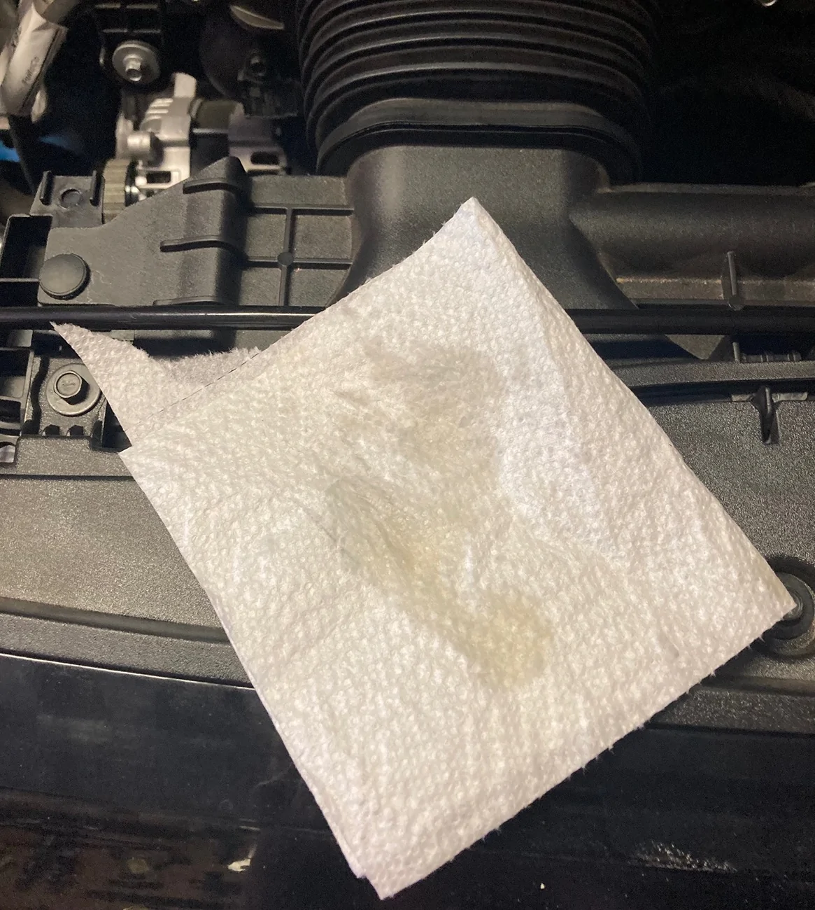

This is what a dip stick wipe on a paper towel looks like - morning after a 5.5 then .5 quart top off.
I dare you to show me your dipstick wipe.
Anyway, no BS claims of “10,000 Mile Protection” on the label. Marketing not involved lol. Does say it “provides deposit protection on turbos” though.

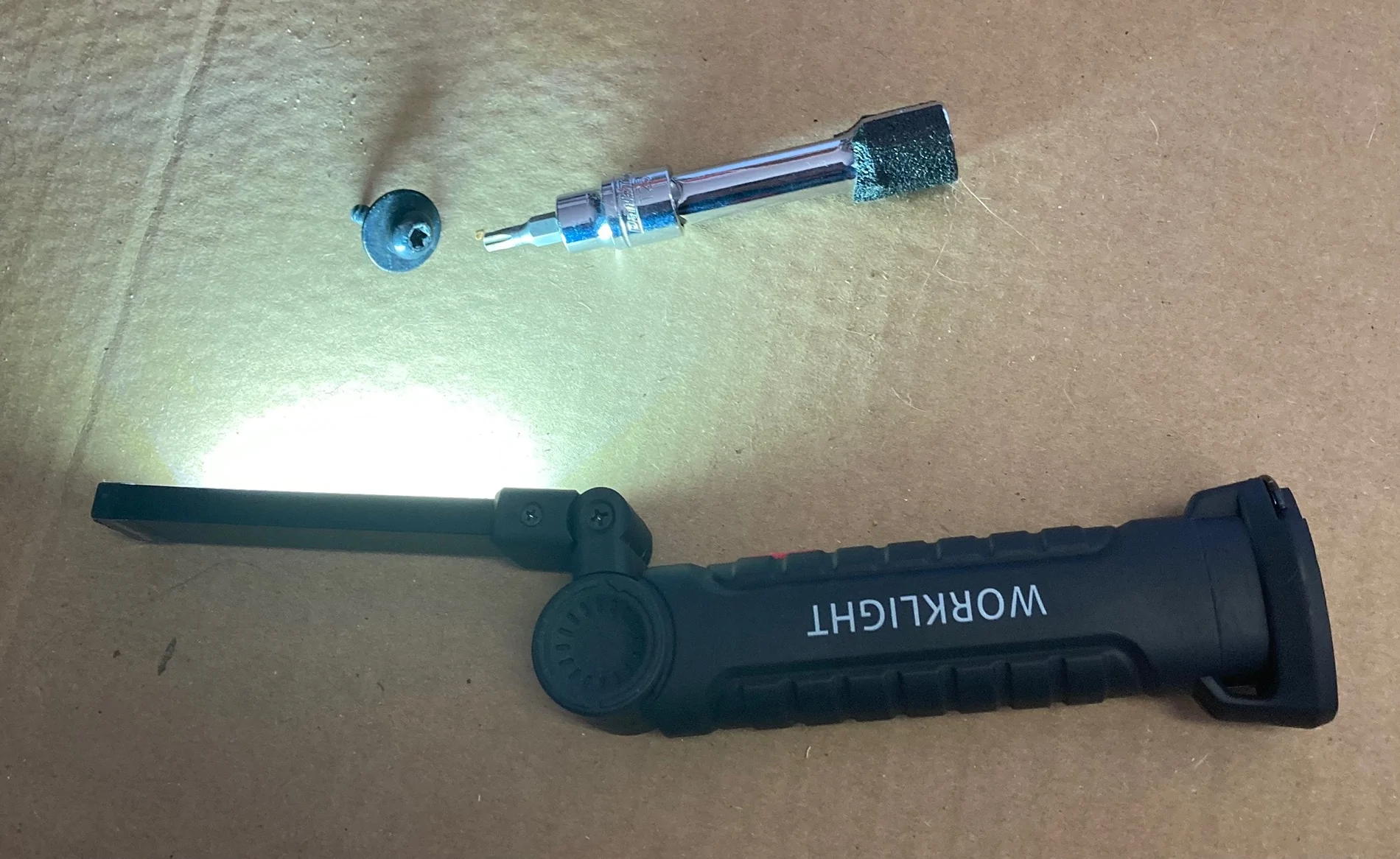

The worst part is the Torx fasteners on the cover. Oh, so many Torx fasteners.
I attached a T25 Torx socket to a socket extender & added some 3M sill/grip tape so I don’t drop it on face as I lay on my back.
Made the cover removal/install a snap!

Whoa, whoa, whoa! Let's not start sharing pictures of our dipsticks please.
I did not ask for pictures of dipsticks - just a picture of the paper towel you wiped it off on;)

That’s some clean oil. That being said only way to know is oil samples. No sense changing oil at 5k if it’s not needed or gonna benefit. Also no good to go 5k if you have a ton of fuel dilution.
