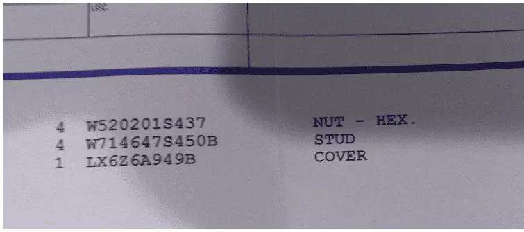

I finally got all of the parts in and got my engine cover installed on my 2.0L Maverick XLT FX4. I wanted to create a parts list / install photo post so here it is. I think most of this has been covered before, but I know there was some confusion on what parts were needed an where they should be installed, so I hope this clears things up.
I ordered all of my parts from https://www.fhmparts.com/
Parts list:
Engine Cover - K2GZ6A949A
Engine Cover Stud - AA5Z6N958A
Engine Cover Stud - W714647S450B
Lower Track Nut - W520201S450B
Total Price:
$80.56 + $18.46 S/H
I'm not sure if having an engine cover really does anything or not, it seems to be debatable. I think it looks great and I wanted it to "button up" the engine compartment so for me it was more of a personal choice. After I drive it around for a week or so, I can let you guys know if it cuts down on engine noise and what not if requested.
Install was pretty straightforward. I included photos that show part install locations. Hopefully this helps. Cheers.

Two. If you look on the front of the engine there are two already there. They are formed into a piece that runs the width of the engine.
Now look about middle way of the engine area toward the back and you will see three brass treaded holes. The one on the left (as you look at it from the front of the vehicle) goes on after you have placed the cover into position. It appears to used to secure the cover from loose from the other studs that simply snap into place.
If you look it up on the Ford parts web site, there is a diagram that shows them and it suggests you may need them when checking out. The other option is to go directly to your dealers parts department and use their assistance to make sure you get what you need.
