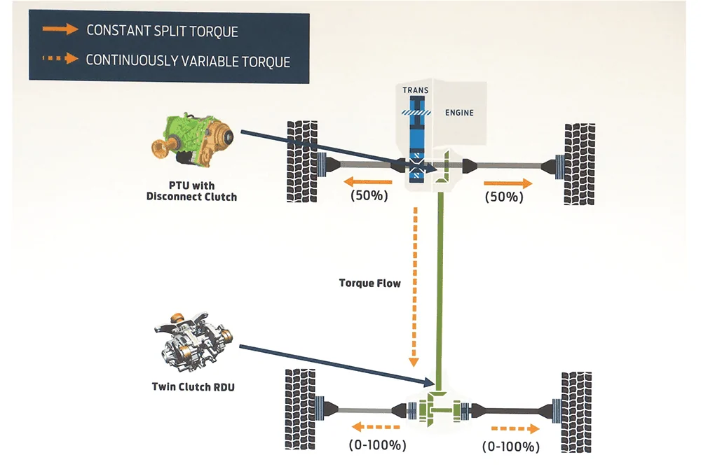

Have no clue what PTU, ECVT, or RDU stands for. I know what AWD means. Not everyone is a mechanic.
I was thinking the exact same thing. These terms are newer and even older mechanics may not know meanings. Credit=Pic taken from MTC "fossil" member.
PTU= Power transfer unit
ECVT=Electro (electric) continuously variable transmission
RDU=Rear drive unit
