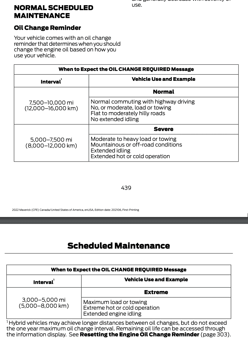

Recently did my first oil change and figured it would make a good installment in my ongoing series. I think the evidence makes a good case for changing oil in the 2.0 EB well in advance of the factory-recommended 7,500-mile intervals. As has been said a million times -- oil is (relatively) cheap. Engines aren't.
