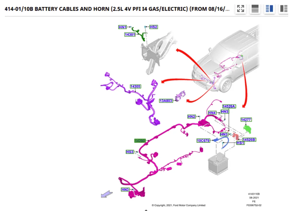

-------------- REPORT #1 [Dealer Warranty Service] ------------------
Thanks to: @Powerstroke46 [Dealer Fix Report Summary]
FORD Dealer Technician Report:
-- Installed LX6Z-14290-PA [Wire-Battery-Electric]
Troubleshooting:
1) Removed Battery and Test - PASS
2) Checked for voltage at high voltage junction box under hood - FAIL [READ: 0 Volts]
FINDINGS: REMOVED junction box and found intermittent open circuit on main power wire to junction box.
REMOVED following for access:
1) DC/DC Inverter
2) High Voltage Junction Box
3) All Shields under Vehicle
4) HYBRID Battery
5) Front Wheels and inner fenders
6) Interior back seat trim around Battery and harness
7) Rear seat assembly
8) Lower High Voltage Coolant Lines under vehicle
FIX -
REPLACED:
** High and Low Voltage Battery Harness Assembly ** [P/N: LX6Z-14290-PA]
FOLLOW UP/ VERIFICATION:
1) Re-energize High Voltage System
2) Clear DTC's

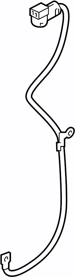

WEB Link to: Battery cable. POSITIVE CABLE. WIRE - BATTERY - ELECTRIC VEHICLE
Part Number: LX6Z14290PA
Supersession(s): LX6Z-14290-PA
https://www.oemfordpartscheap.com/p...ery-Cable-Positive/119664100/LX6Z14290PA.html

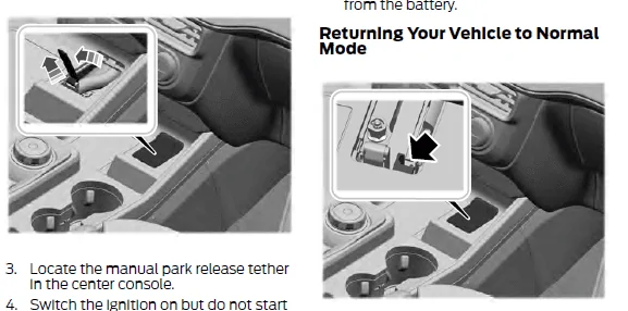

FOR FUTURE REFERENCE: If one needs to <manually> put the vehicle in "Neutral" for towing.
Ford Maverick Tracking DEAD HYBRID Mavericks Reported Dealer Solutions / Fixes ... 1654387202105-png
From Owner's Manual - Pages 186/187:
USING "MANUAL PARK RELEASE"
Activating the manual Park Release Cable
  1. Apply the Parking Brake. See Electric Parking Brake (Page 194). NOTE: If the battery is dead, for example, no electrical power available, you could need an external power source to apply the parking brake.
  2. Remove the access cover with a tool or key by prying the panel in the upper corner.
  3. Locate the manual park release tether in the center console.
  4. Switch the ignition on but do not start your vehicle. NOTE: do not activate the manual park release with the engine started.
  5. Once in the drivers seat, fully apply the brake pedal and hold. Do not release. Pull the tether strap rearward until engaged. If done correctly, a message appears in the instrument cluster. NOTE: There is an audible click when you pull the tether back in the locked position.
  6. With your foot still fully applied on the brake pedal, disengage the parking brake. See Electric Parking Brake (Page 194). ---> **NOTE: Your vehicle is now out of the "Park" (P) position and is free to roll** <---
  7. Your vehicle remains in "Neutral" (N) for emergency towing purposes.

what appears to be a bad connector on one end of the harness
The cable/ harness under suspicion has multiple connection points along the battery to/from engine electrical flow ... there is no properly verified confirmation of a single bad connector or an improperly terminated/ soldered/ crimped terminal causing faulty and/or intermittent contact ... at this point in time the bad connector(s) is only inference, speculation, and conjecture theory. If and when this is verifiably confirmed by a qualified/ authoritative source, will be happy to report ...
EDIT [06/23- 21:00]: After two dealer service reports, there are stronger indications of a faulty "Wire - Battery - Harness Assembly" [P/N: LX6Z-14290-PA] as the cause of the Dead HYBRIDs failure ... fixes need some road time/ operation time for verification.
