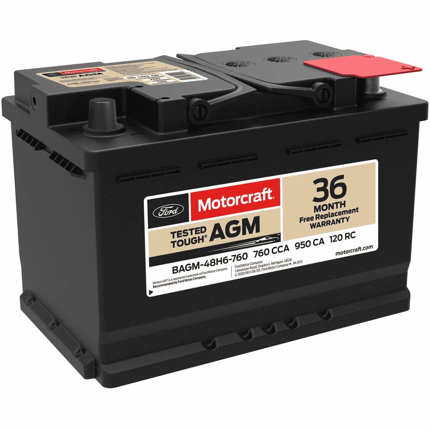

The EB Maverick's come with this battery, BHEF-48H6, which is an "Enhanced Flooded Battery." This EFB battery is designed to handle start-stop systems. AGM's can outperform EFB's and can be used to replace them.

Ford/Motorcraft battery part numbers give us some information. BXT is a standard flooded battery. BHEF is an enhanced flooded battery. BAGM is an absorbed glass mat battery.

I'm pretty sure Ford AGM batteries have "AGM" in their part number and I believe the BXT-99RT4-A is a standard battery.

I would think AGM would be labeled on the battery like every other AGM battery I have had.
The factory batteries have a different label on them compared to the replacement batteries like the one I posted above. They usually only have the battery part# and warning information. No warranty info is listed because they are covered under the 3 year/36,000 bumper to bumper warranty and not the regular battery warranty. I'm a retired Ford parts counterman.
