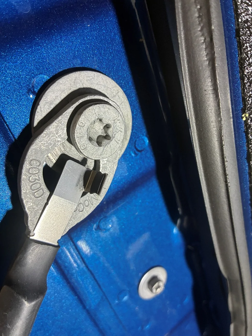

Is it possible Ford ran out of TP 50's and put in T50's? Threads and pitch, everything else is the same I assume?
I doubt it, I just checked and I'm in the process of updating the T50 fits perfectly as does the TP 45.
I checked the smaller bolts on the tailgate and they all still align with the Torx Plus bits.
I Thank "Mavi-ous" for pointing this out.🤝

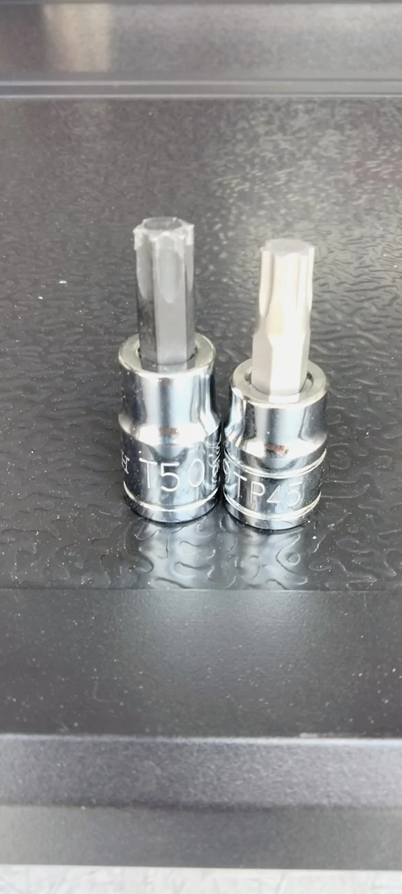

Yes, that is strange, but they both work. I just went and looked at my tailgate and the bolt looks to me to be TP45. My T50 fits perfect! I can't find my Torx Plus set, but when I do I will try the TP45 on it also. EDIT: Maybe my eyes are crossed. I did a "relook", now it looks like a T50 bolt? Geez, this old thing is getting ridiculous, haha.

Possibly it's just a happy coincidence that a T50 also works -- like how some standard and metric sockets are almost exactly the same size?
Exactly.👍🏻
Like I Updated in post #1 Some of the metric sizes closely overlap the SAE sizes 8mm (5/16"), 10mm (3/8"), 13mm (1/2"), 16mm (5/8"), 17mm (11/16"), and 19mm (3/4").
I never really thought about Torx
and Torx PLUS overlapping until @Mavi-ous mentioned it. 🤷🏻‍♂️
