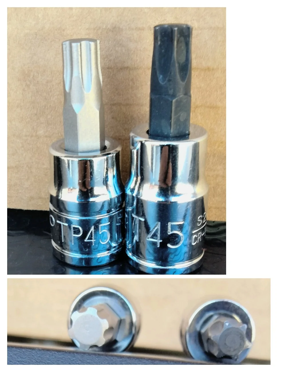

I started this thread because a lot of folks don't understand the differences between Torx PLUS &Torx. Ford uses Torx Plus on our Mavericks.
The difference between regular Torx and Torx Plus is pretty significant. It becomes a difference between stripping out the bolt and not stripping it. Here are some pictures and a short 9-second video.

This video shows the slop using a Torx in a Torx plus fitting. For those thinking it. Yes they are the same size. T45/TP45

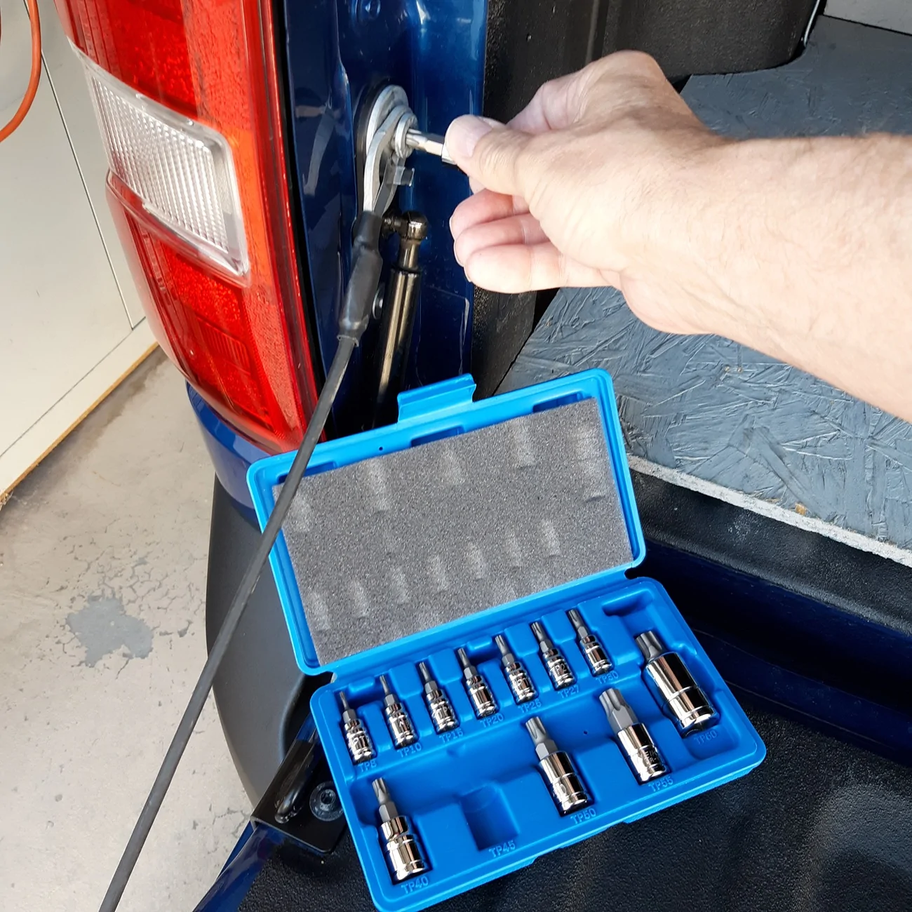

If all you ever do on the Maverick, is remove the lower Splash Shield to change the oil. You probably don't need to buy the Torx Plus.
In my situation torch Plus would have been handy to have, when tightening the bolt for the tailgate damper bracket.

Should be a Torx plus 45 as I show pictured in post #1
Sure a regular Torx 45 will fit but will be sloppy as I demonstrated in the video, also in post #1
I know your evidence doesn't lie, that's why I'm baffled. Arana sells so many of those things, and as I mentioned, the T50 fit perfectly. Ugh. At least I likely won't have to remove that bolt again anytime soon...
