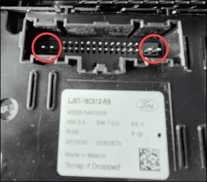

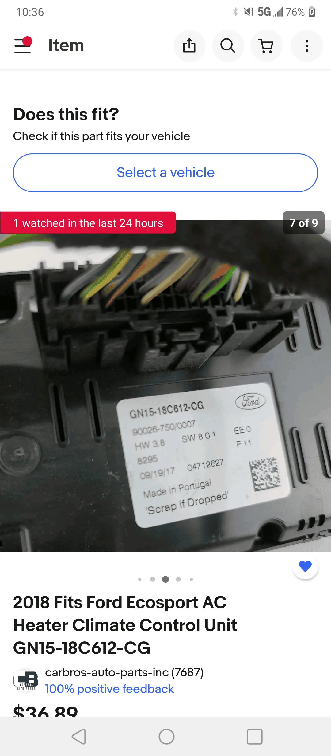

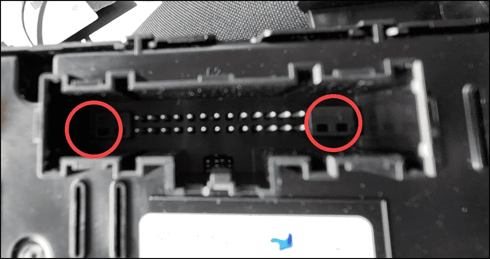

Heres a pic from an ecosport module which is the same as escape. I forgot to get detailed pics when I had my dash apart last time but the black and green wire from the connector on SCCM go to the hvac module, the large pins you were asking about. It would not be too hard to make a harness, I did a first ever heated wheel swap on my 2017 escape and did a DIY on that as well, the hard part is getting the pins which I have a good supply by buying a bunch of random ford harnesses on ebay. Also I wonder if you have to have an xlt to be able to have the wiring installed for the heated wheel. Anyone with an XLT have the connectors?

Zooming in on the picture of the climate control module wiring harness posted by @mesajoejoe , it would appear that the two large pairs of pins are labeled pins 16 (on the left of the pic/connector) and 17 (on the right of the pic/connector).

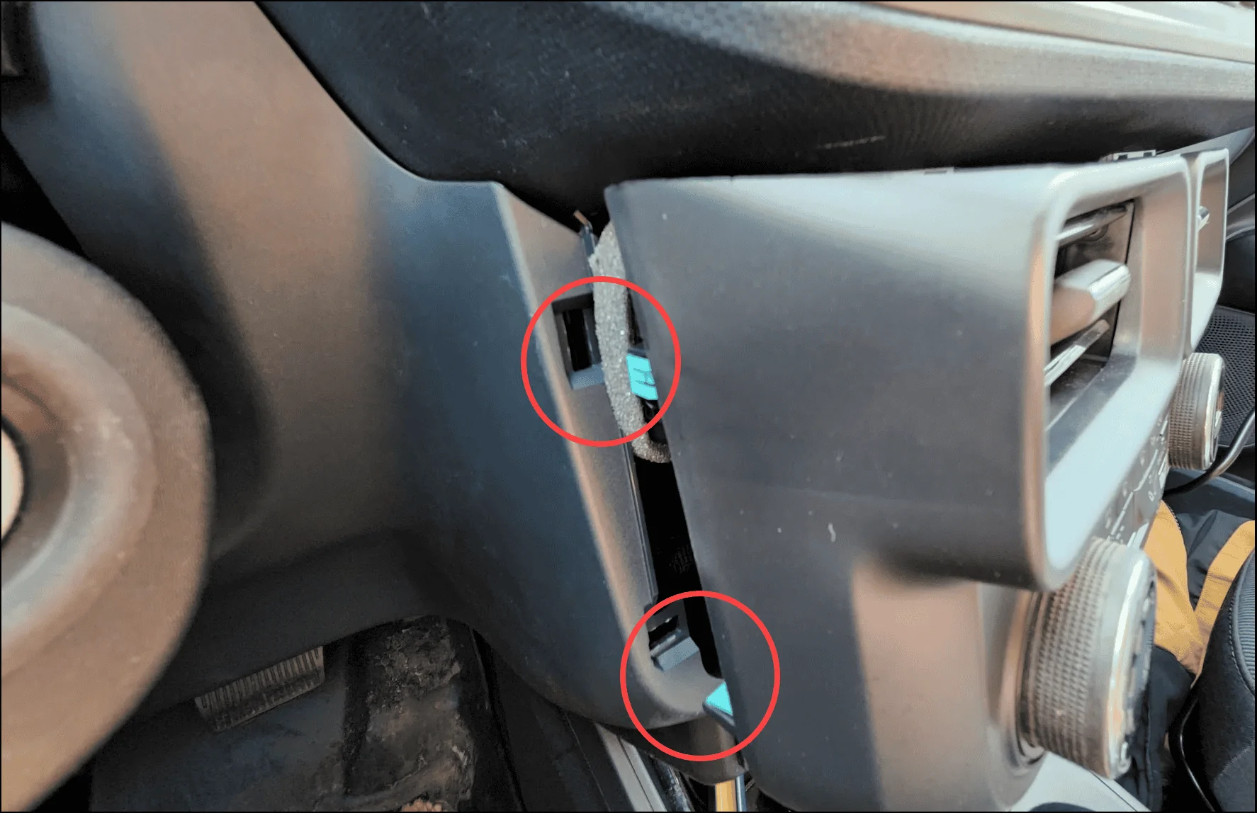

Update. In order to remove the HVAC module you just need to pry the trim away, there are 4 clips holding it in place 2 on the left 2 on the right.

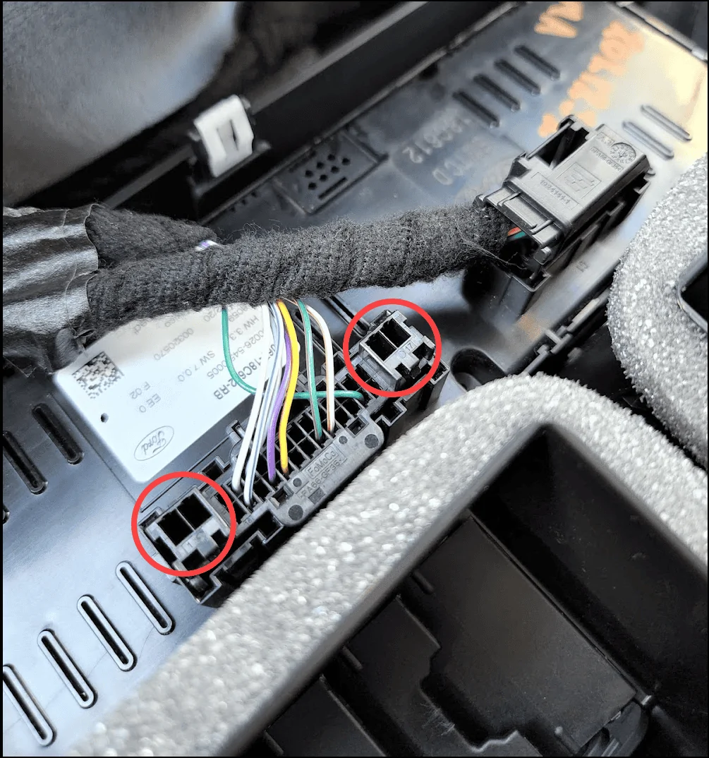

Here is the wire harness plug with missing pins that I'm aware of, not sure if someone elses higher level trim with heated stuff has more wires in the harness than this... Someone please give me some pics!!!
Here is the back of the original HVAC module

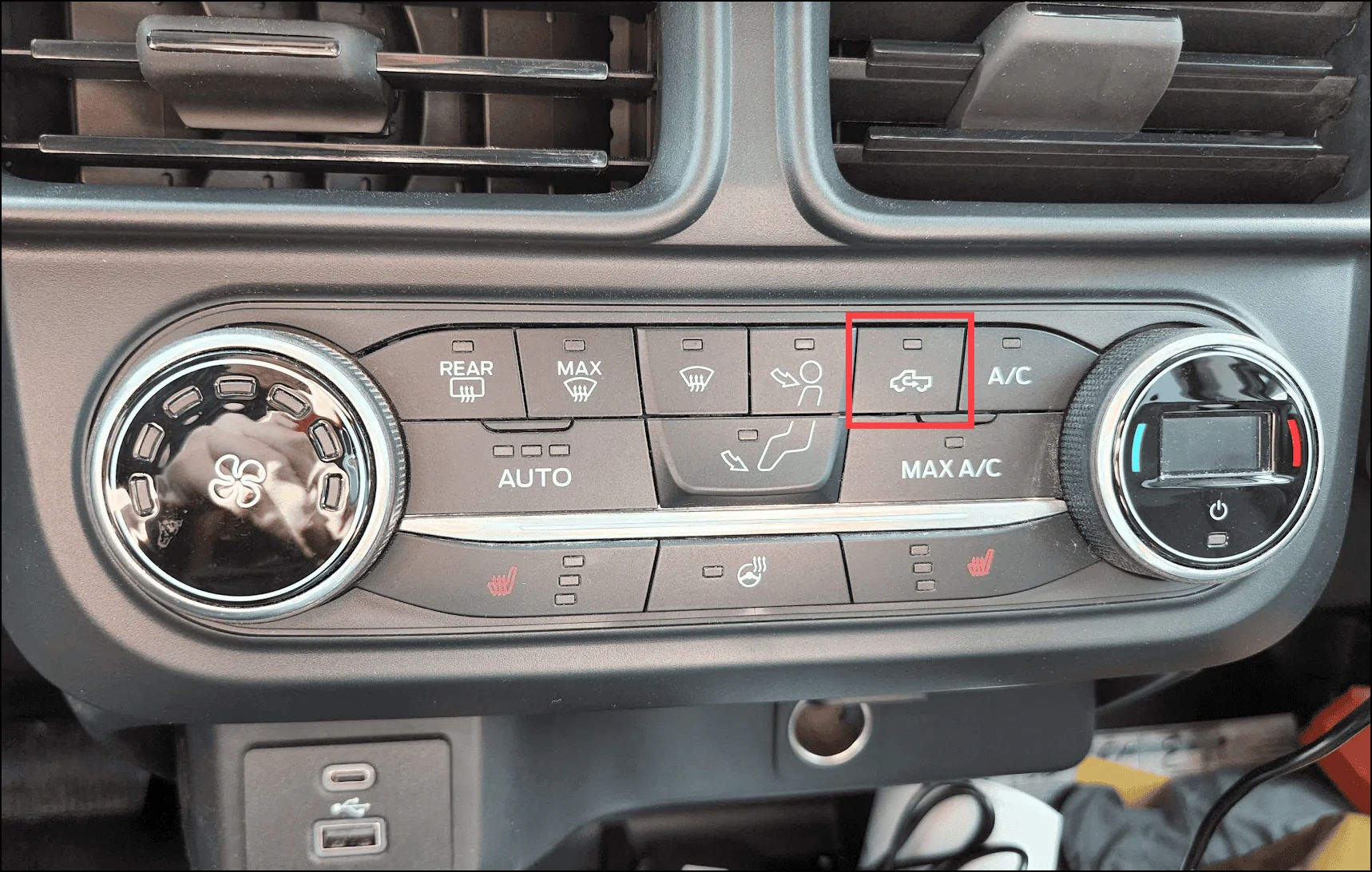

Here is the new HVAC module in place, I had to swap this button with the escape one since it was a car symbol and I wanted my little truck
Here is the new HVAC module rear which has extra pins

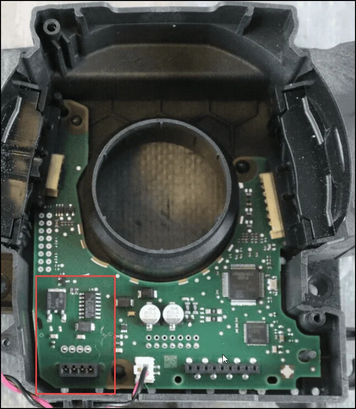

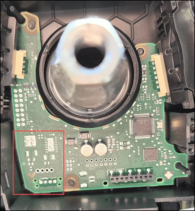

As for the steering wheel stuff, getting a new clock spring is not enough. The Steering Wheel Column Housing Assembly or whatever has a little board behind it with missing parts, see below.
This is my original board
Here is a picture of another Steering Wheel Column Switch Assembly that includes the parts for heated steering wheel
I cannot find just this board anywhere but this Housing Assembly part LB5Z-3F791-SB should do the trick. It appears to include the left stalk/right stalk so if you're looking to add Driver Assist Lane Warning stuff (which works btw), and the clock spring all together with it. Clock Spring and left stalk is already $170 shipped and this part above is like $220 shipped so not far off. I will update this post once it arrives and let everyone know if heated steering wheel is possible. The plug on the back of this housing assembly does plug into this section even though I have missing parts, so I'm hoping that it includes the wiring for heated steering wheel!
Someone with heated steering wheel or even heated seats please take a pic of the wiring harness that plugs into the back of the HVAC module. Should only take 5 minutes to do.

Does anyone have the pigtail for the 2 extra tabs on each side of the hvac control module for the heated seats? Or is this a single full piece harness/connector? I'm also looking into/wanting to wire aftermarket heated seats while integrating the factory heated seat switches. It seems as though there is a pigtail connector for each side that could plug in and would then integrate into the heated seat circuit. Seems as though it wouldn't be too bad to wire in.
