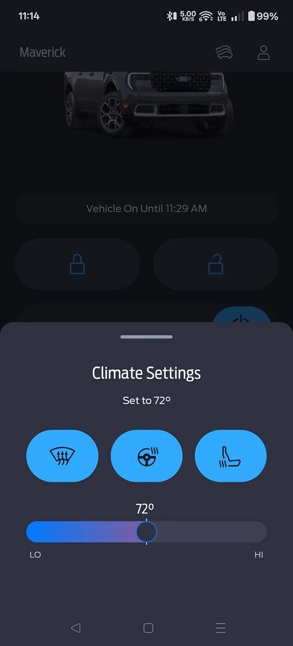

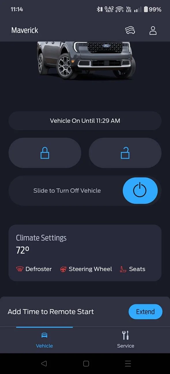

However the phone app settings working now.
-Update the app if you don't see the climate controls. Press this and the temp, seat & wheel settings will show up.
This was not there a few days ago.
There was an update to the app a day or so ago to 5.11.0
This added invite driver.
Key fob start working
Seats and wheel on.

Hmm I'm on Android when you start it via the app a climate section doesn't appear in the iOS version similar to this.
Ford Maverick 2025 Lariat Remote Start not Heating seats and Steering wheel {filename}
Yup that’s exactly what I see on my phone app so I tested it it works great 😊
