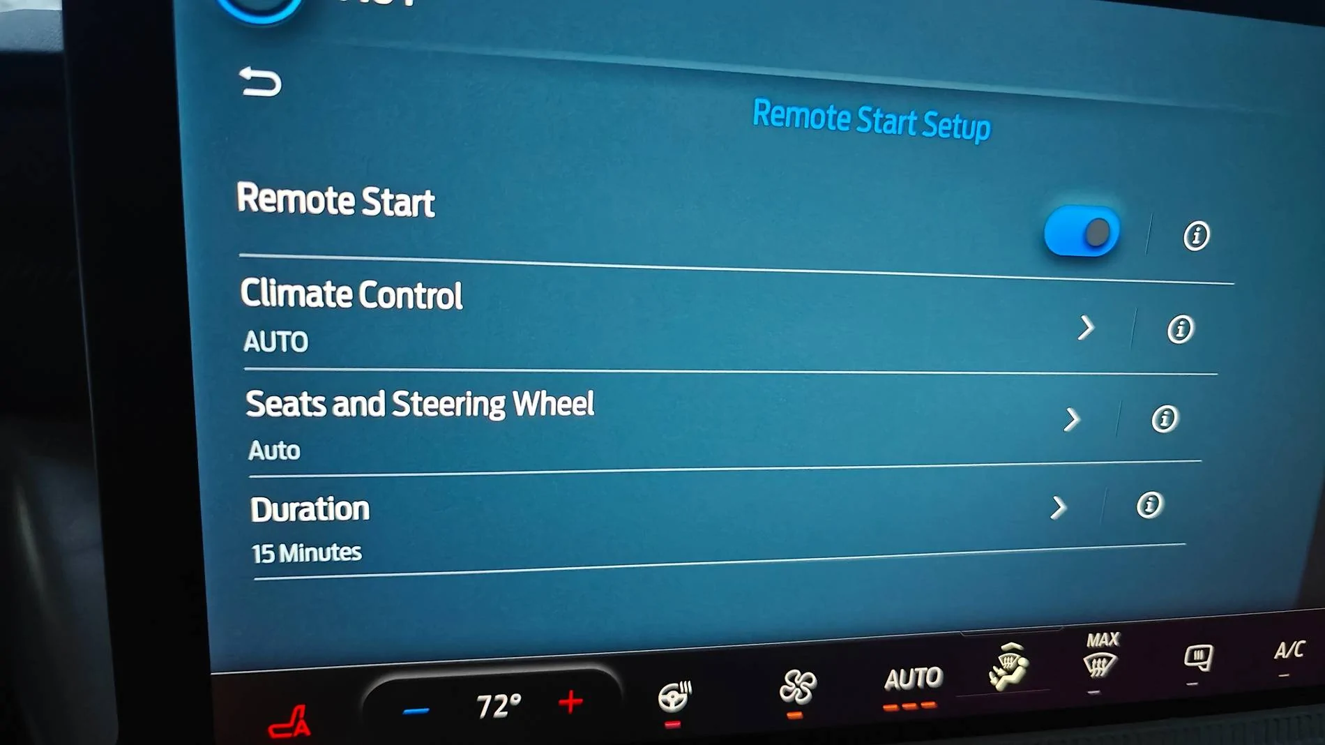

I found this post on the Expedition forum (https://www.expeditionforum.com/thr...t-inoperative-after-remote-start-event.58159/)
It sounds like you have to set up the "Climate Settings" through the FordPass mobile app instead of through the SYNC menu. I just tried it and it worked on my truck even using remote start through the key fob
I did the same thing today and it seems to work EXCEPT the heated seat was only at level 2. I see no way to adjust that (air temp was 25 F so pretty cold). I have a Cherokee and a Terrain and neither of them are this complicated. Seats and wheel come on when below 40 degrees. Cherokee stays on when started, Terrain needs manual input after starting.

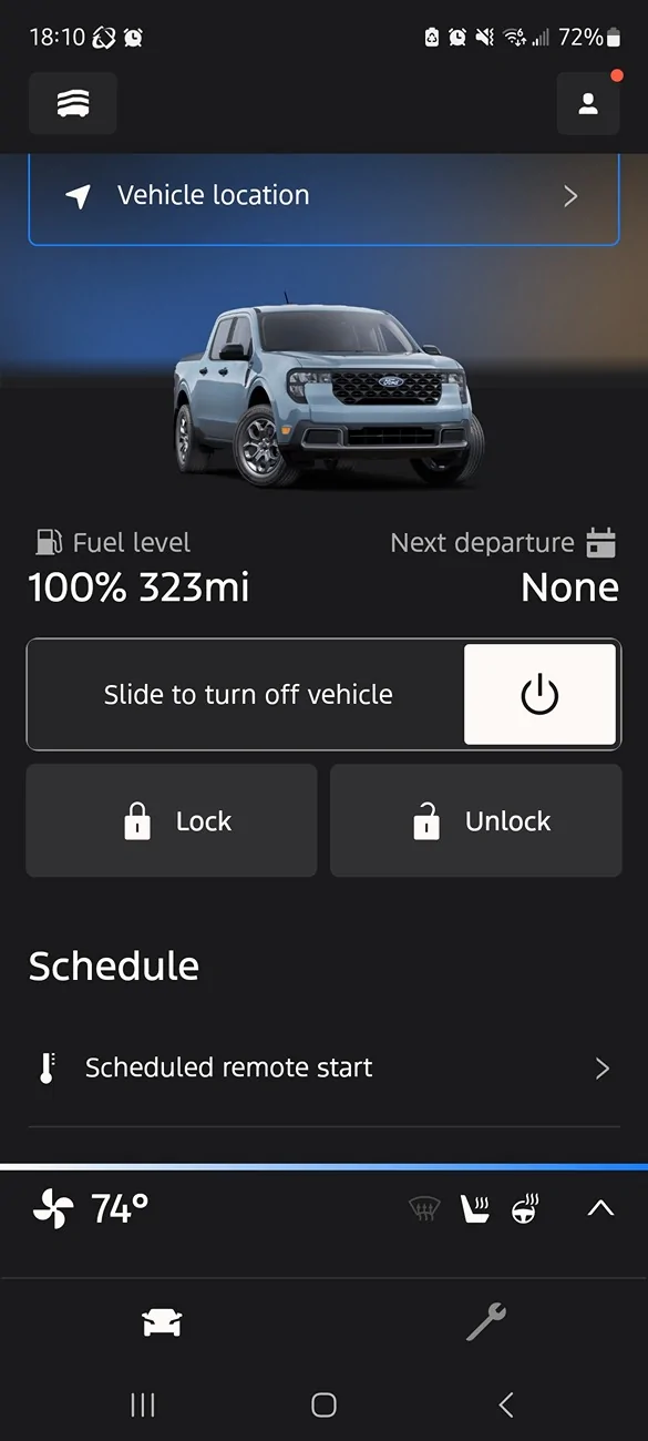

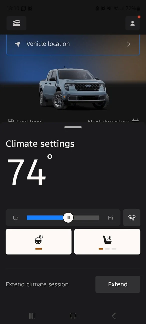

Ok, thanks. Maybe they are on then because they seem to warm pretty quick when I start driving. Tough to tell with the brutal cold last week. I'll keep experimenting to see.

I am seeing those and have them set identically to the settings I physically turned on/left on in the truck. I can post a screenshot next time I start it.
Here's some screenshots. Again, might just me being a newb and expecting them to be warmer faster, but seems like they're very fast when I start the truck from within so I feel like I easily remote it early enough for them to be warm.
Why not turn the heated seat up to the third level?
When you remote start, make sure the seat is on 3. I always had in the past, but even with my ‘22 the seat was not toasty when I got in. Even went to the dealer to have it checked out. For some reason, Ford no longer heats the seat to the max value; it just warms it even to ’take the edge off’. So IMO 3 is your best shot to get it the warmest it can be. Once it senses someone is actually sitting in the seat, then it warms to the setting. I suspect not having a body on the seat causes it to get too hot and maybe burn out the element? Just a guess on my part.

Makes sense, I always kept it at one or two when I was in there because I didn't like how hot it got with three. I'll try setting it on three when the cold weather returns though and see if that changes anything. I didn't realize it would just "take the edge off" until I sat in it. Thanks for the help guys.
