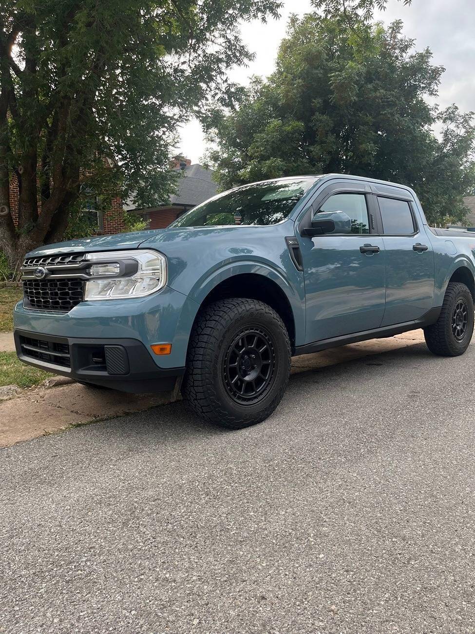

Fwiw, I was not able to install even a 1” front lift for the same CVT joint reason. But I am running 245/60/18 tires with no rubbing … I am told they are the tallest possible tires that can fit on a Mav without a lift or rubbing.
They have three benefits … slight higher ride height, they fill the wheel well gap a little better than the stock 225/60/18’s, and the extra rubber improves the ride a bit.

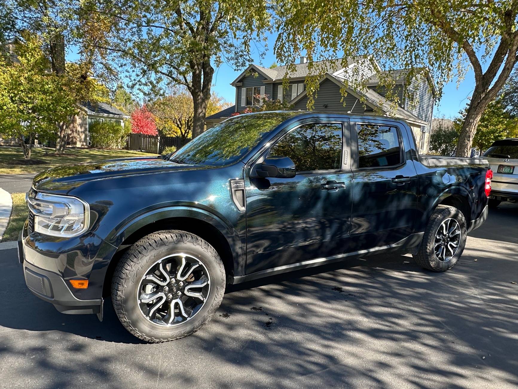

I am coming from the overland Toyota crowd, but found the Maverick compelling. Mine is lifted with 30.5" 245/70-17 tires (stock is 29"). I go camping and like to get to the good spots, where the roads can get a bit rougher. I like the extra ground clearance and beefier tires. I also like the look a bit, as it makes the Trucklet look a bit tougher. Yes, I am already on my second set of CV axles. I will replace them with Tremor units once these fail again.

You said you are on a second set of cv axles. About how many miles do they last?
Yeah, your Maverick sure has that bad ass look, which I like!

The first axles lasted to 36K miles. Noticed some seeping an a slight shimmy on acceleration. If/when this set fails, I will do the Tremor axle swap.
