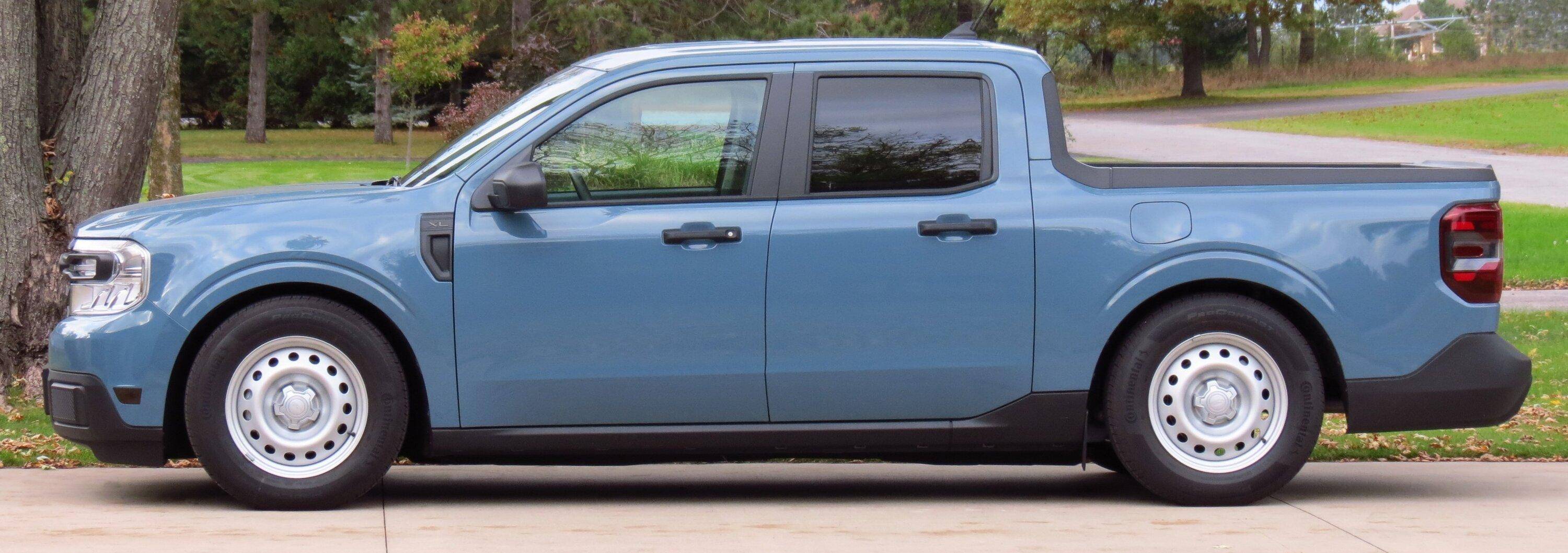

I have to know how much it rubs this low? The fender liners have like no concave room in them compared to normal cars
I've had my Silvers coilovers installed for a bit over a year and for about 15k miles. I have them set so the truck sits 5 inches lower than stock. There are other forum members with this set up who have gone lower, but this appears to be the sweet spot with the tire/wheel combo & stiffness settings I have dialed in.
So far, I recall hearing/feeling a rub maybe 3 or 4 times. It's always at low speed and seems to be from the front when turning into a driveway where's a dip in the curbing. I've had the bed loaded up with 500lb of stuff, and have towed about a dozen 2000 lb trailer loads with no rubbing from any of that. The space above the tire in the wheelwells to accommodate wheel travel is reduced by the drop, but the increased rigidity of the springs seems to make up for it well. I have seen only minor evidence of the tires contacting the top of the wheelwell liners from suspension travel during normal straight-line driving. And I do give them a periodic inspection because I want to be aware. I'd kind of expected there to be more so this has been a pleasant surprise.
The key to minimizing the chance of tire contact is careful selection of new tires/wheels. Be reasonable with tire width, and make sure tire diameter isn't any larger than stock. And be mindful that any new wheels don't have a huge difference in offset from stock.
If I would have kept the stock steel wheels, I doubt there would have been any rubbing at all with them at this height.
Ford Maverick Why "Lower" or "raise" your Maverick? img_1547c-
But they just weren't my favorite, so I ended up going with the 19" Escape wheels where the new offset pushed the tires almost an inch further laterally into the wheelwells which was a bit more than I would have preferred. But I love their look. If someone chose a wheel with an offset that pushes the wheels outward more and gives them some 'poke', that would significantly incrase the risk of tire contact - on that outer lip of the wheelwell.
If anyone wants more details on the set up, that info can be found here in my build thread.
