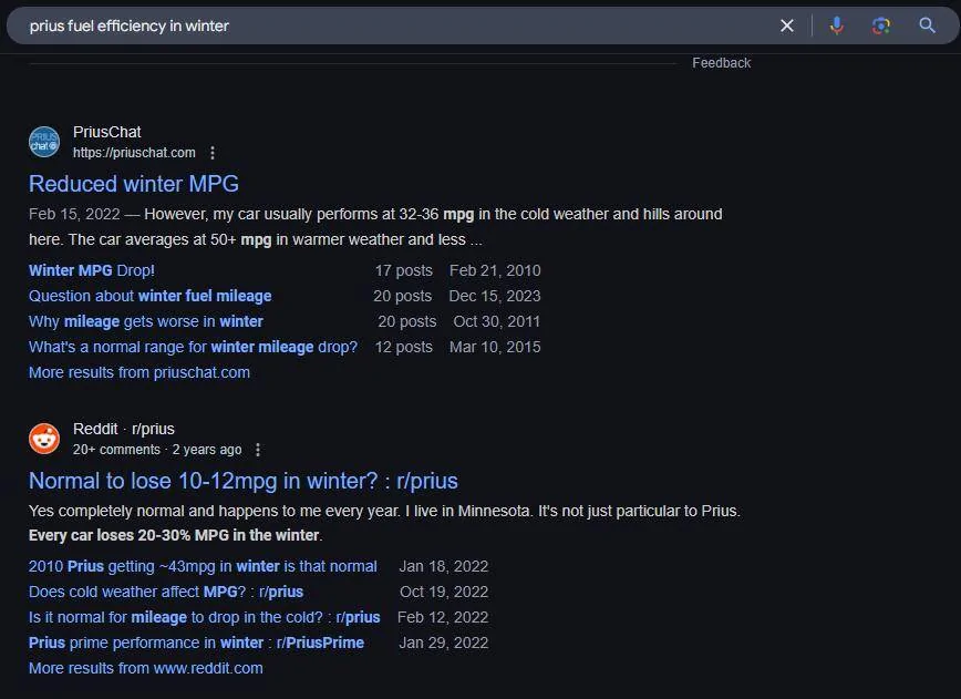

While you think your Prius might not be impacted, it ABSOLUTELY is significantly less fuel efficient in winter weather. You just might not have been attuned to it as much. Or, you also said you went through a prolonged colder than normal weather period; if you didn't have your Prius operate in similar conditions you can't exclude the possibility it would have very similar results to your Maverick.
A simple Google search reveals Prius drivers suffering from massive loss in efficiency because of winter weather:

Again: the more efficient the vehicle, the more noticeable the loss of efficiency will be; partly because you are more attuned to it being efficient and partly because it is operating outside of ideal efficiency conditions.
All vehicles suffer in cold weather.
ALL. VEHICLES.
