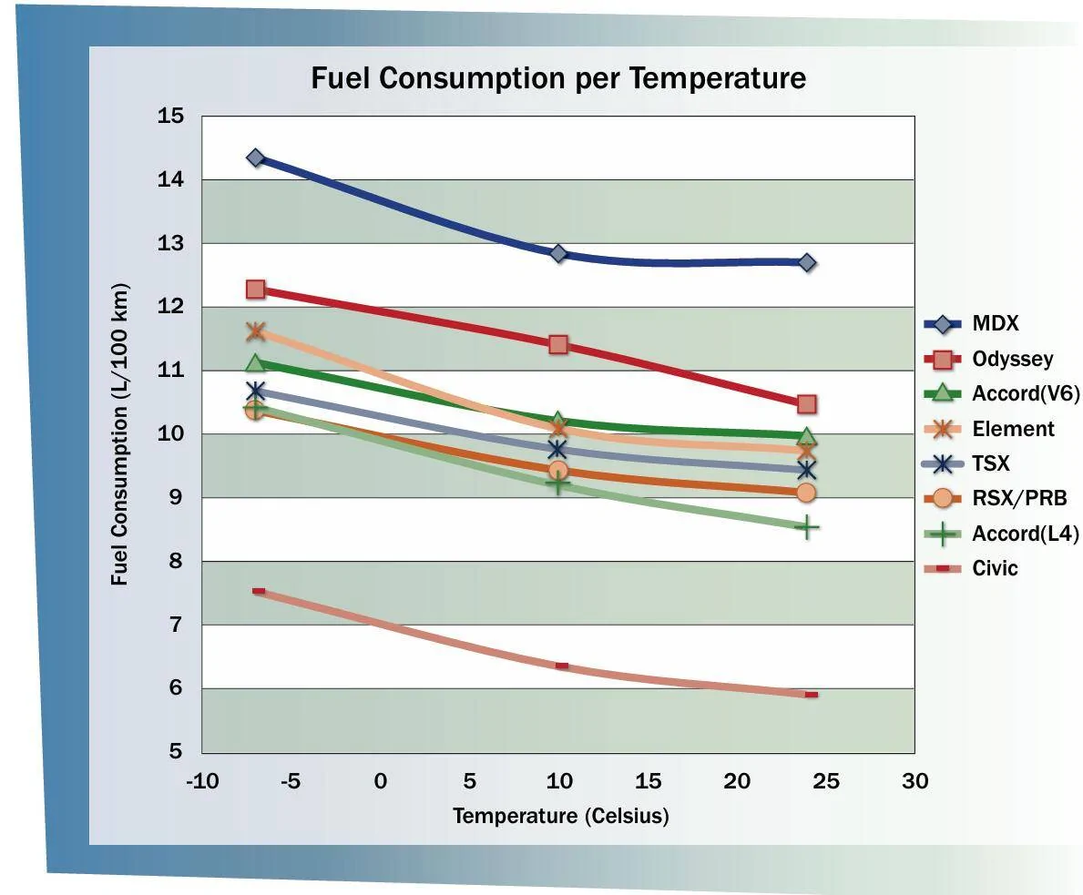

I'm comparing summer 75 mph, 180 miles to winter 75 mph, 180 mile drive here. Summer is 35-36 and winter is 26-27.
Just crazy it impacts it that much. That's a 25%-30% drop in fuel efficiency for the same route, same speed, just different temperature. I've not seen that in our Prius.
Found this chart on a Canadian government website, most vehicles show a 7%-12% decline in efficiency:
Excellent post. I appreciate when people use specifics and clarify terms instead of throwing out generalities. 👍
I don't know where you learned to read charts. But looks like 20% drop
In general, to me.
