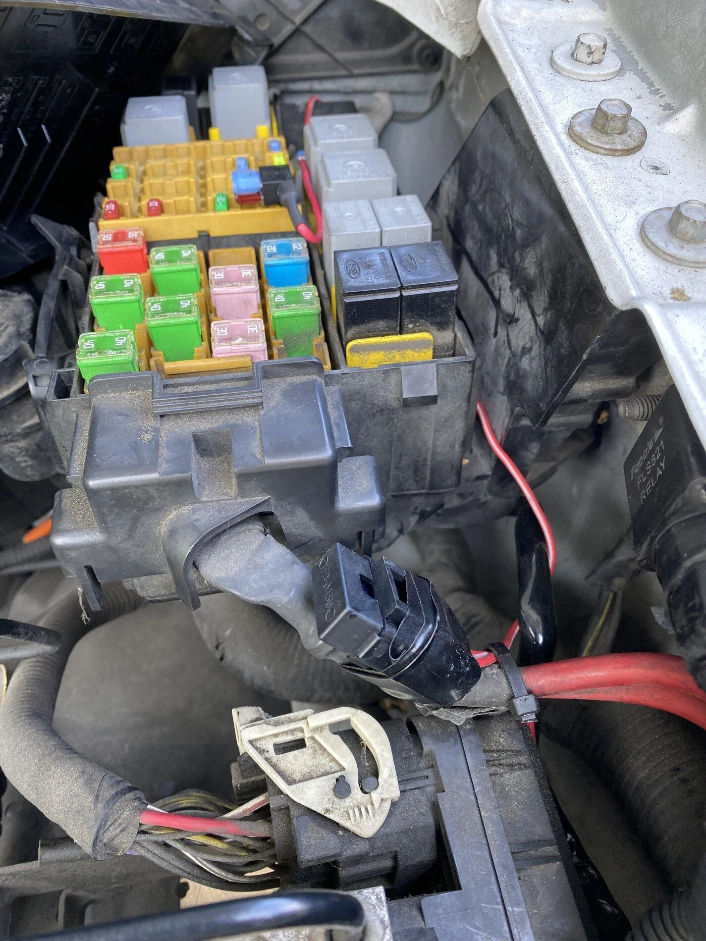

speaking of….
Don’t know why choosing to lower the photo file size rotates the photos?
Any hoo

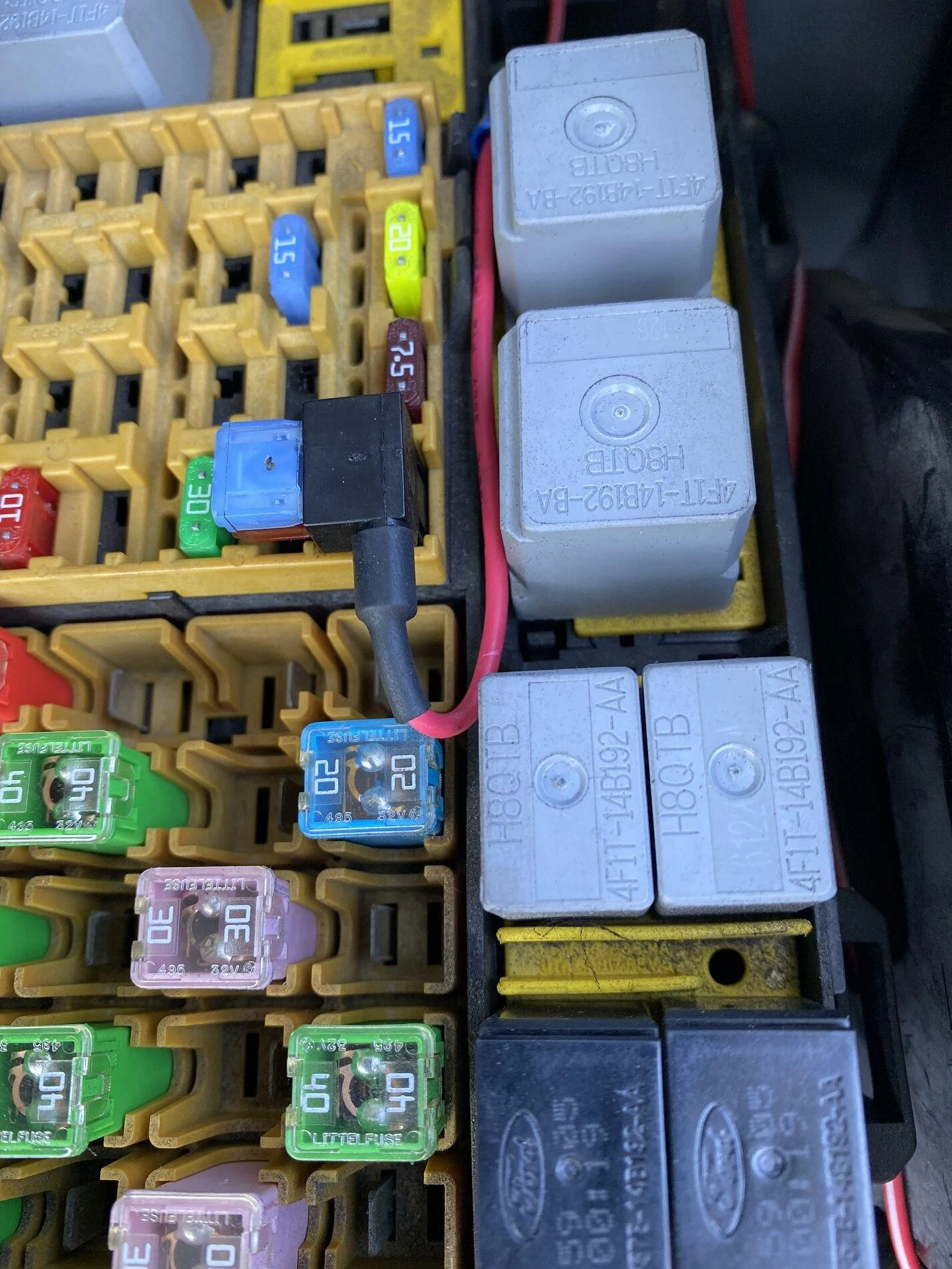

Make sure you do not tap off of the battery!!!! As the easy way and the cable instructions or for the birds, because they tell you to connect directly to the battery unless you want to drain your battery completely and and want to make it look like some hokey person jimmy rigged the lighting.

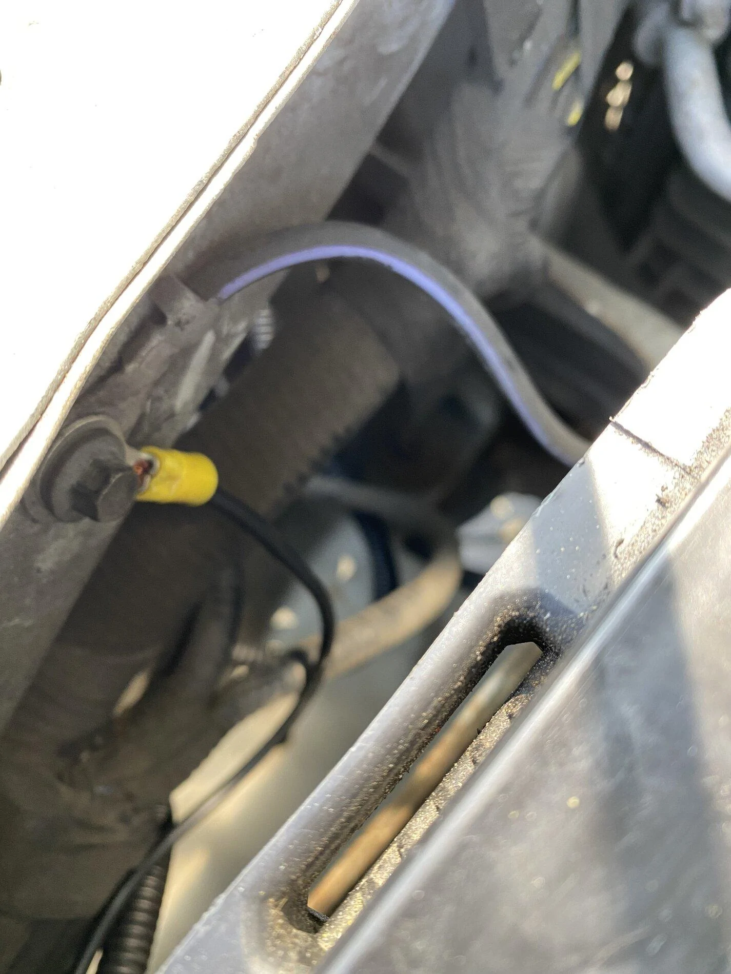

I placed the ground wire to the bolt the battery connects to the chassis.
The positive is connected to the fuse tap. I used the transmission fuse to do this since its a manual so with or without it the car runs fine. One the Maverick this where Im like I just shelled out 30k and now I have to mess with stuff wtf is a big erk to me to have to and to everyone i am sure.
I digress

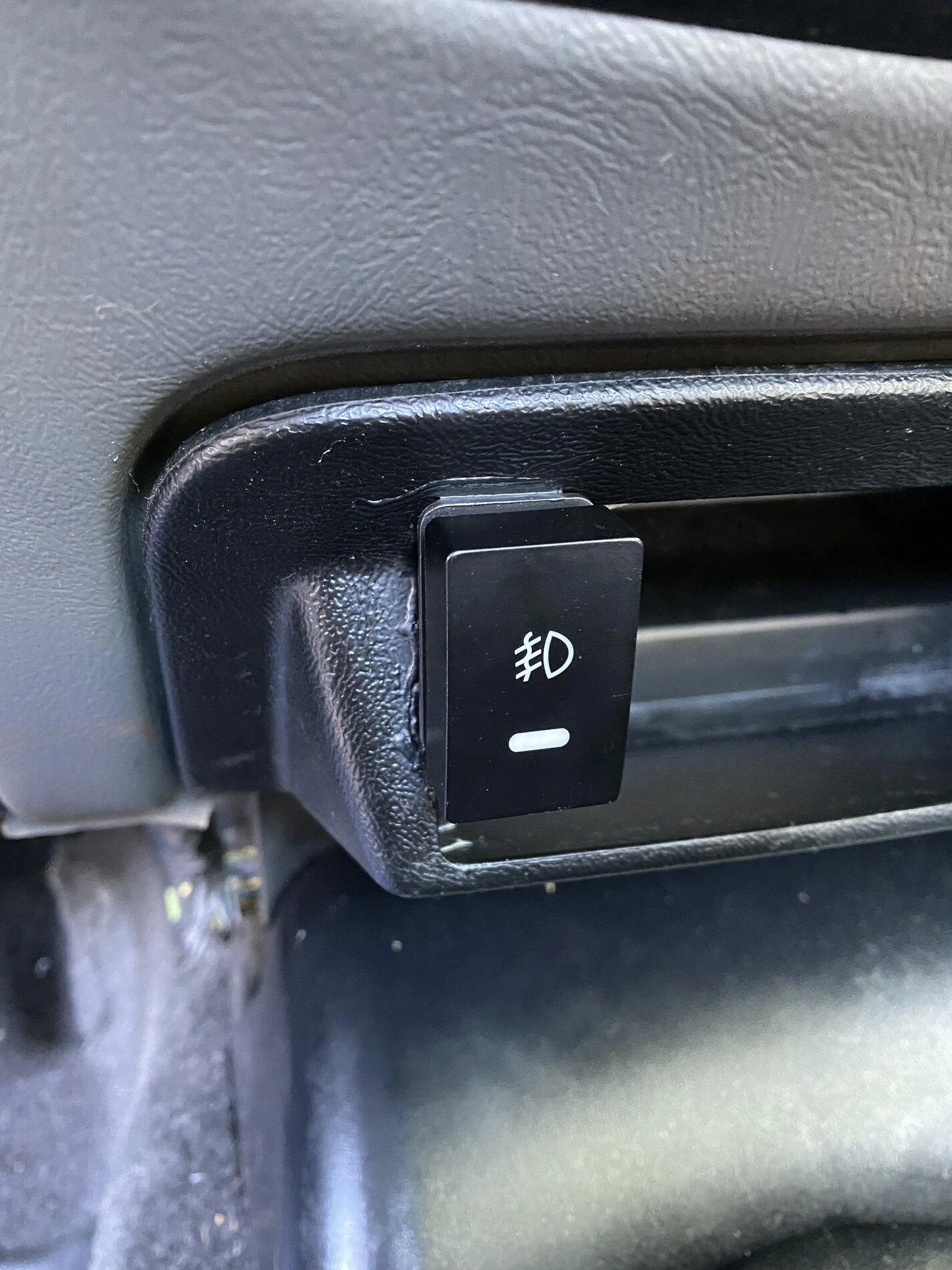

There is relay that runs the lights and gives an amber light on the switch and a green light when its on. Really cool if you ask me for 11 bucks shipped.
That relay is also leaching a bolt that was holding a wiring harness.
The hardest was to slit one of the rubber boots crossing the firewall.
Gorilla duck tape works real good once you trying to pull it through the hard rubber. A little wd40on the slit helps too in pulling the harness thru.

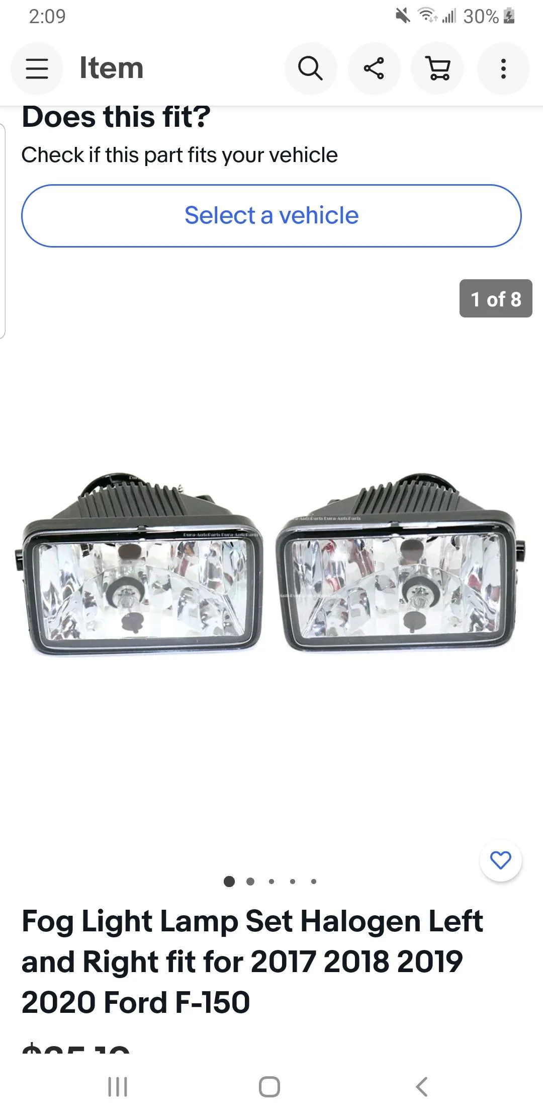

I plan on putting in fog lamps on my XLT when it shows up. I want to mount them in the bumper. Trying to find some stock ford lights that will work and appear factory, then I will make some moulds and make some surrounds out of fiberglass to fill the gaps between the lights and the bumper cover. I am thinking these F150 fog/driving lamps might be the ticket.
I will likely add an auxiliary fuse and relay block off the battery. This way I'm not tapping into the factory fuse block. Littelfuse makes a nice weatherpak type relay/fuse block setup. It holds 3 relays and 3 fuses. It uses GM style weatherpak connectors. I bought it originally for doing a headlamp relay mod on one of the barracudas, but since then i purchased 7" LED headlamps that look like stock sealed beams for the car, and will end up using this relay/fuse box on the truck. This gives me up to additional circuits. Though I will likely only use only 1.
