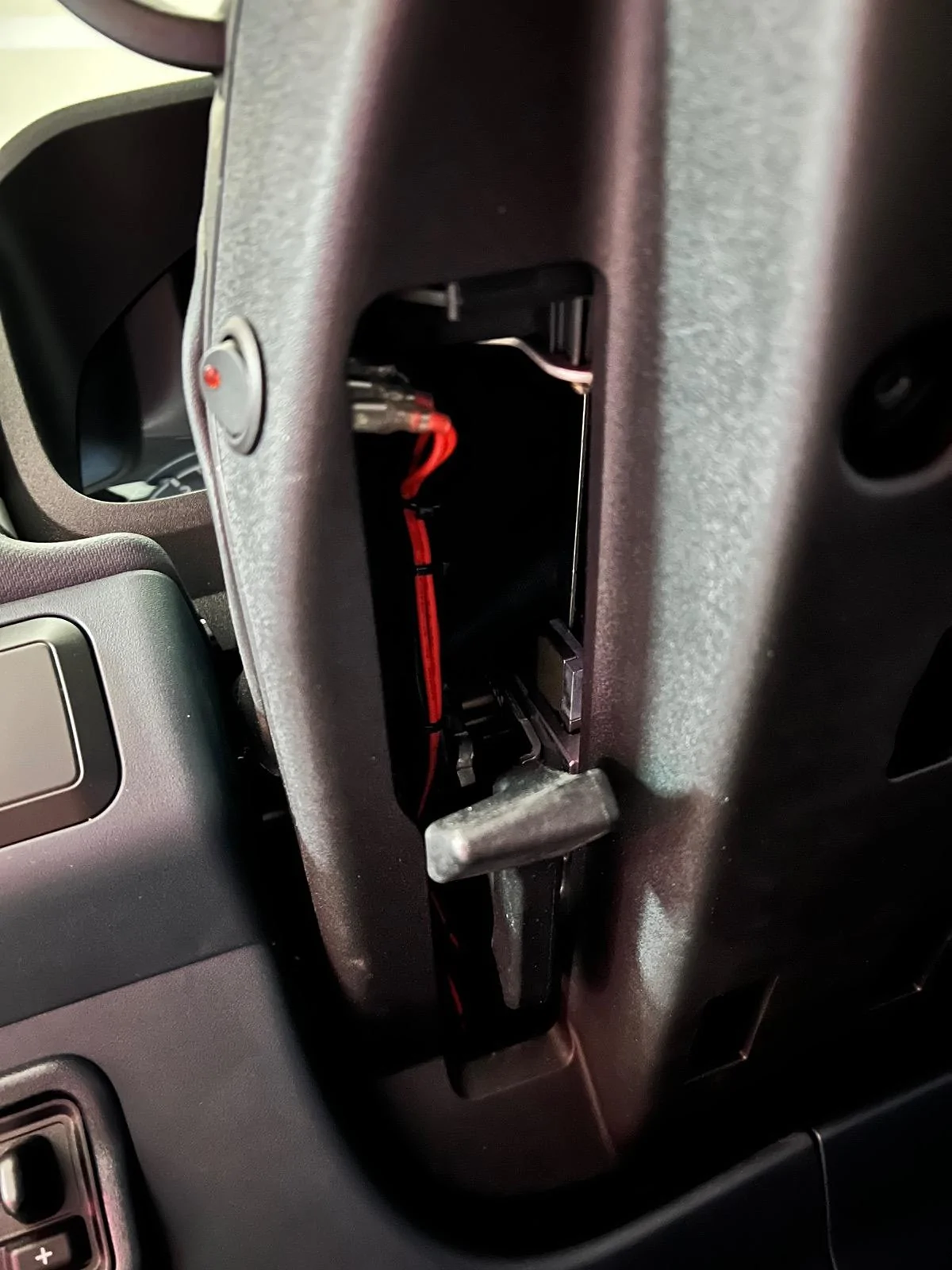

I made my own fog light solution using DD lights and the steering column was where I mounted. Maybe when I’m not lazy down the road I’ll swap over the headlight switch panel. Good enough for now though
Thanks for the photo!! That's the spot i was thinking would be easy, and convenient to operate.
I felt around the OEM light switch area and it seemed like it would be a lot of work to try to mount in that area without disassembling the dash.
Thanks again for the picture.

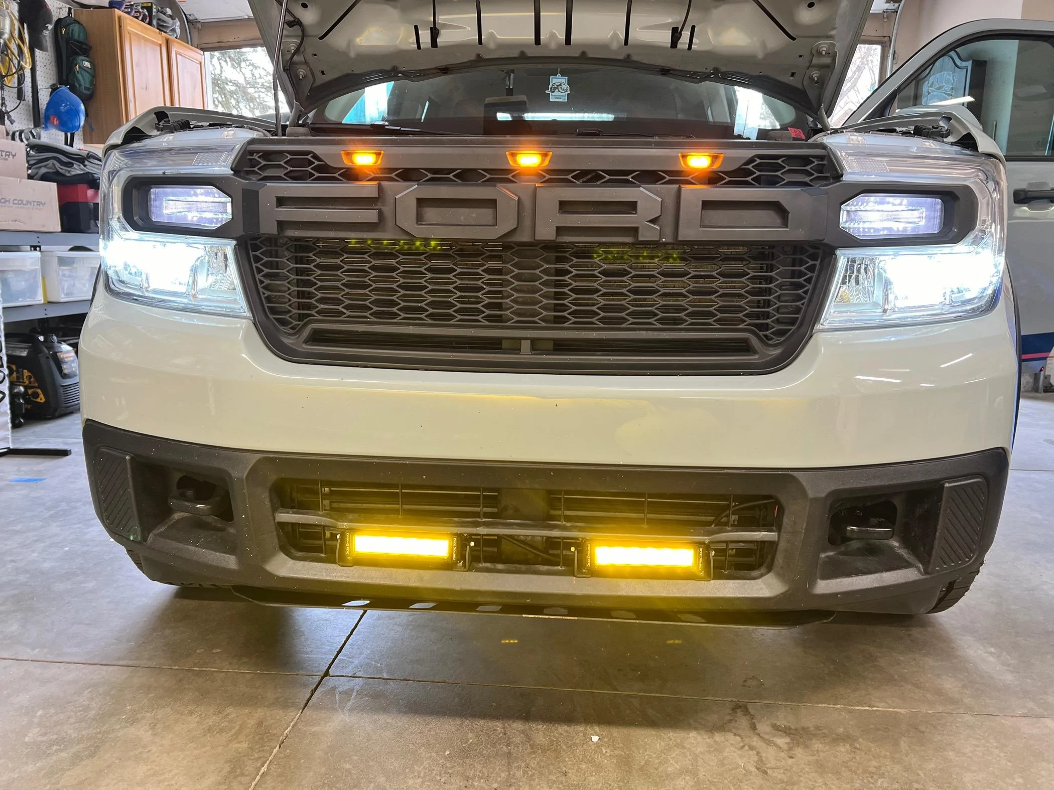

you bet! That spot is so easy to bring the wiring through the fire wall gasket and run up into the column and tap the hole for the switch. My whole project was done in under an hour and a half
how did you even get it there? Did you have to disassemble the column b/c it seems like a lot would be in the way.
Actually that spot on the column has nothing behind it and you can actually reach up behind that piece of plastic molding without taking anything apart!!

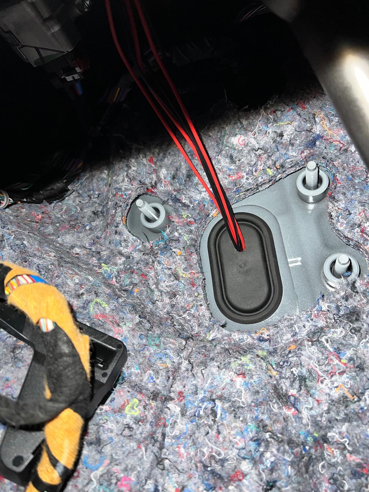

tapped a hole in the firewall gasket. From there, wiring runs right up into the steering column unobstructed. You can feel a blank spot on the column with nothing behind it to tap the hole for the switch. I just made sure to have the steering wheel fully extended when I ran the wires so that the length was enough. Piece of cake!
Ford Maverick Diode Dynamics fog lights installed! IMG_4666
Ford Maverick Diode Dynamics fog lights installed! IMG_4667
