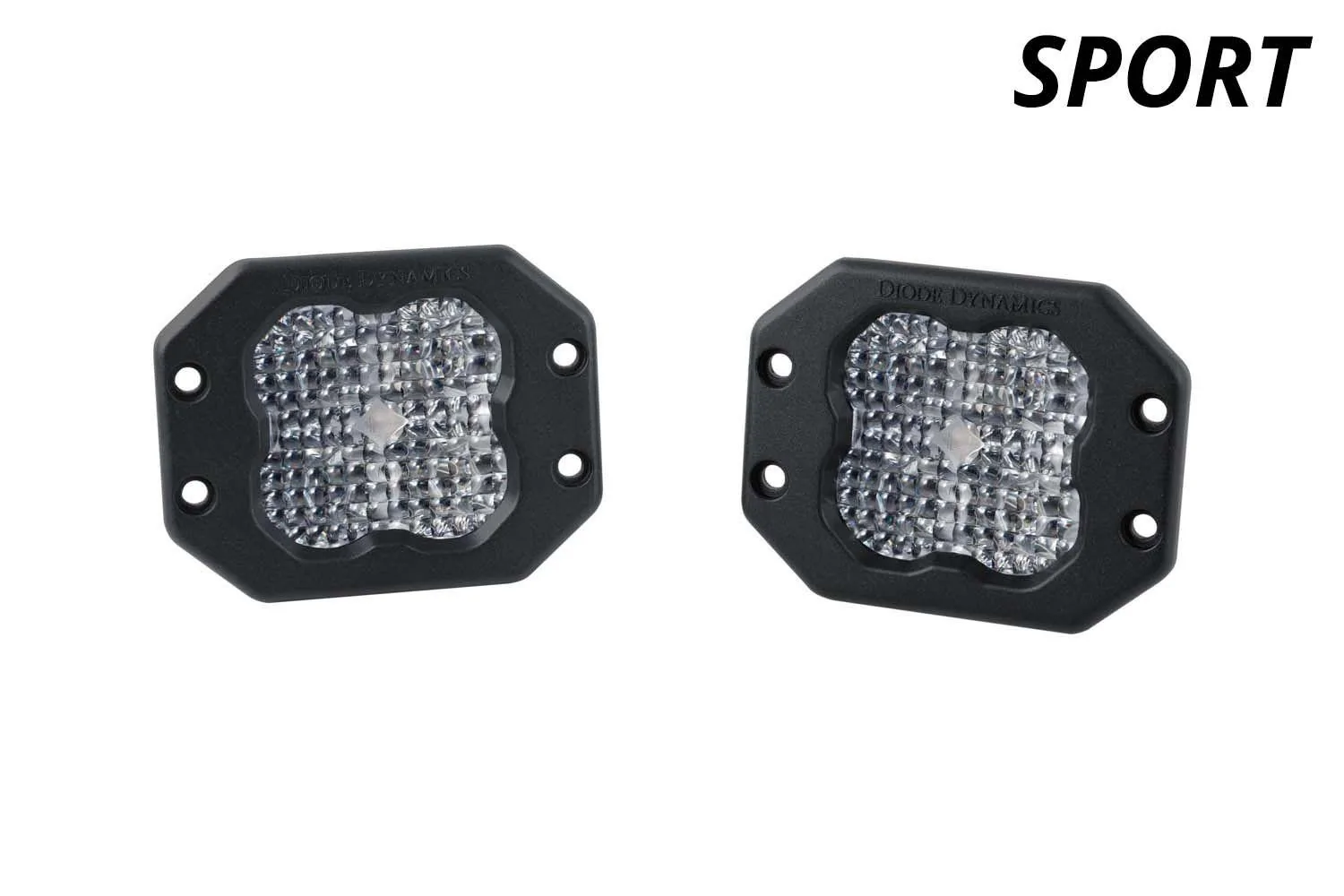

If there is space behind the lower bumper valence, I plan on installing Diodynamics flush mount fog lights. They are USA designed and built to SAE specs so they are road legal. I need that low, wide spread to help see deer at the sides of the road. Lots of easy to digest tech info and videos on Diodynamics site
https://www.diodedynamics.com/stage-series-3-sae-dot-white-sport-flush-mount-led-pod-pair.html
I was about to say, I wouldn't miss factory fog lights. For me, I'd get the same setup as what's on my Frontier now; generic SAE LED fog lights ($90 on Amazon) in the lower bumper opening, and ditch lights up higher. The SAE LED fogs are brighter than the Frontier's halogen headlights and DOT-approved for on-road use.
If you haven't had ditch lights before, I'd highly suggest it since you're in deer country. I have ditch light brackets on my Frontier with generic $30 LED off road lights oriented about 20 degrees off-center to either side. Never mind the deer; you can see halfway up the trees on the side of the road!
