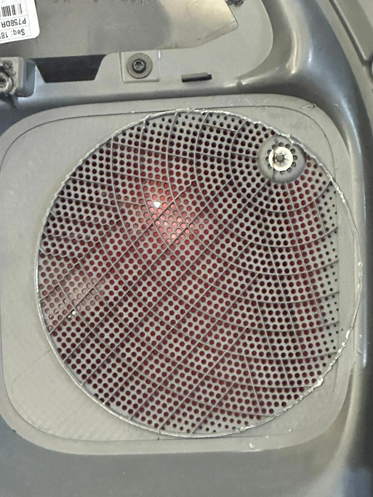

Today I replaced the door speakers with Rockford Fosgate 6.75 speakers and I also replaced the center speaker with a Dayton 3.5 point source speaker. I jad no idea how much that would improve the sound. The door speakers look like cheap paper cone type with small magnet. The Rockfords are poly cone wo maybe more weather resistant. The adaptor that came with the speaker made installation very simple. Way more and deeper bass and much better stereo image now. I am very satisfied. Sub mods may come later. I did trim the lip off of the speaker grills so they would not touch the cones.
