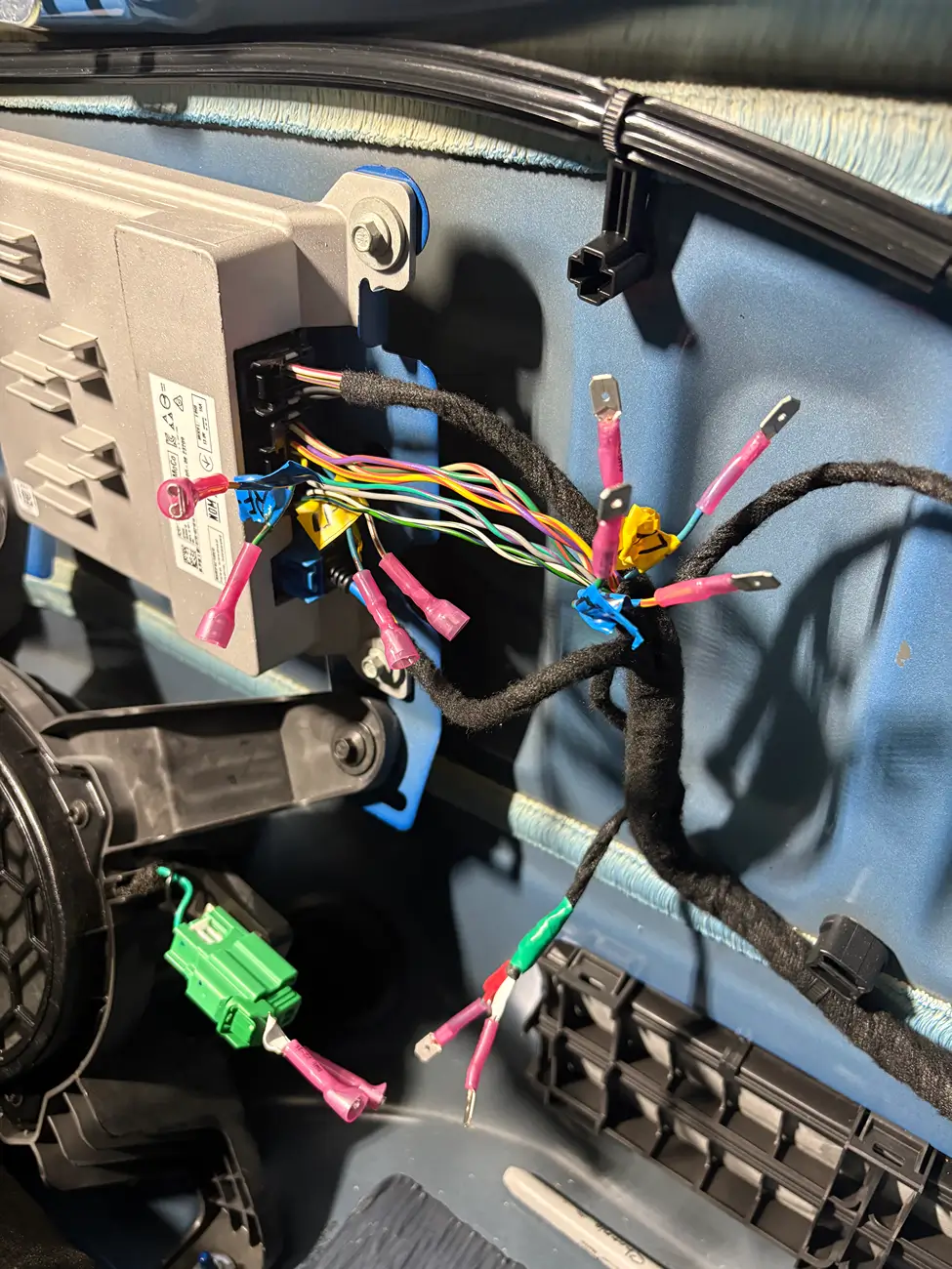

BTW, for the next person wanting to do this. The factory subwoofer connector is a Yazaki part. You can buy the connectors and terminals and make an adapter instead of cutting the wires. Search for "Yazaki YESC Kaizen 1.5" to find the whole catalog.

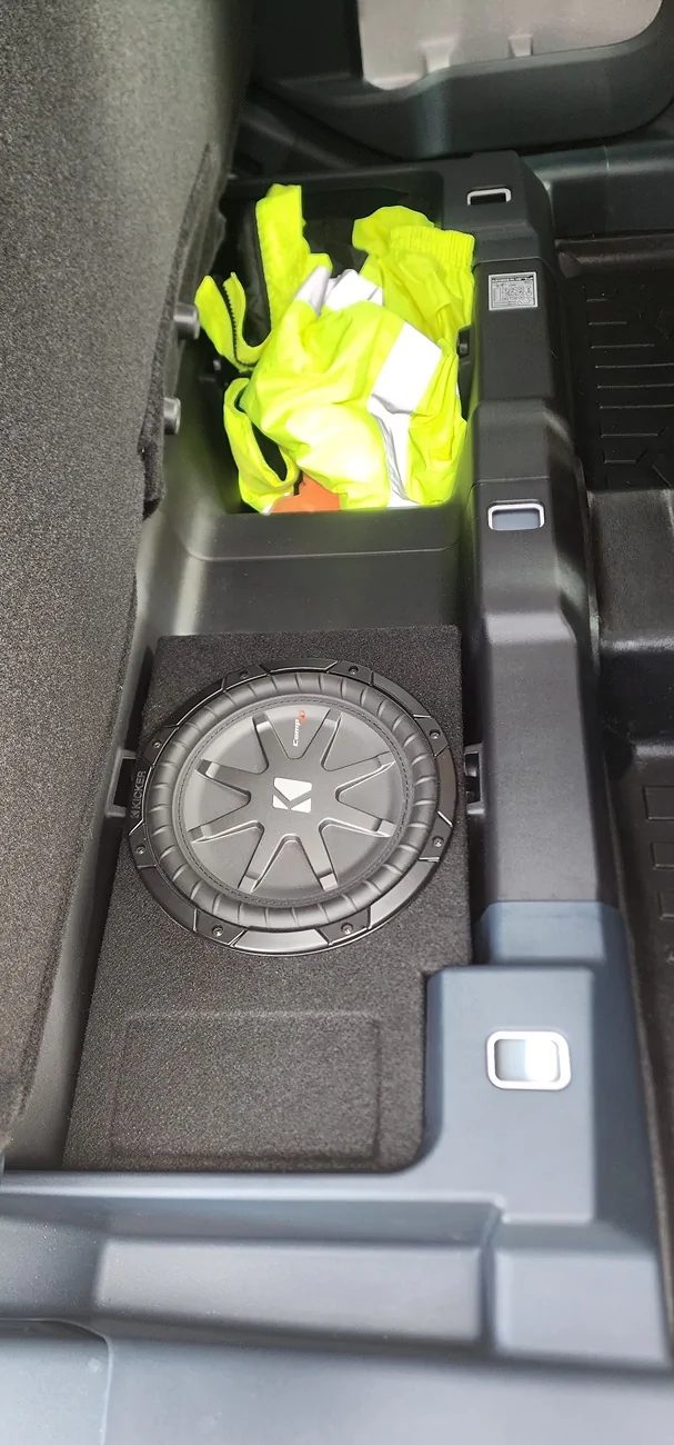

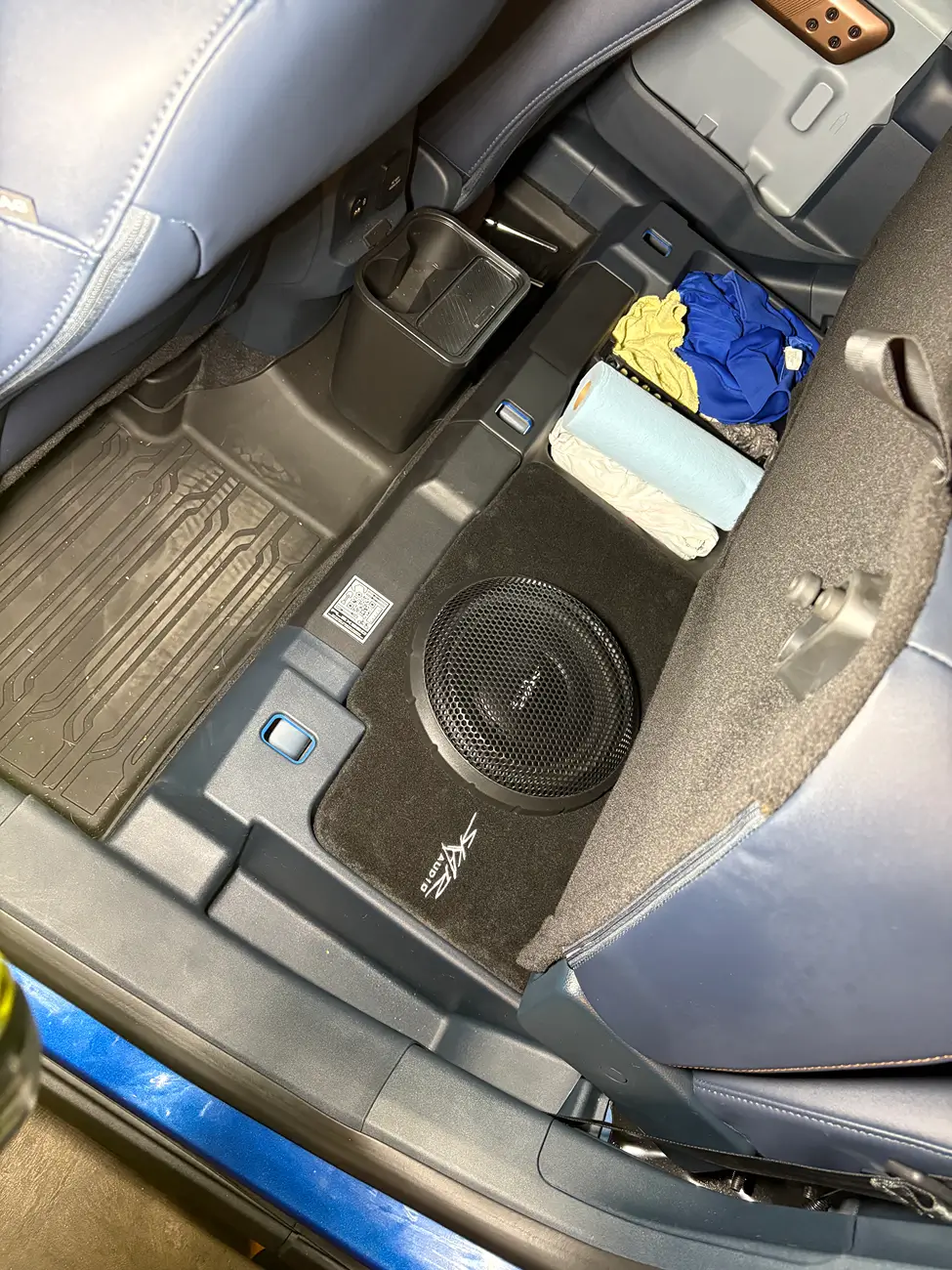

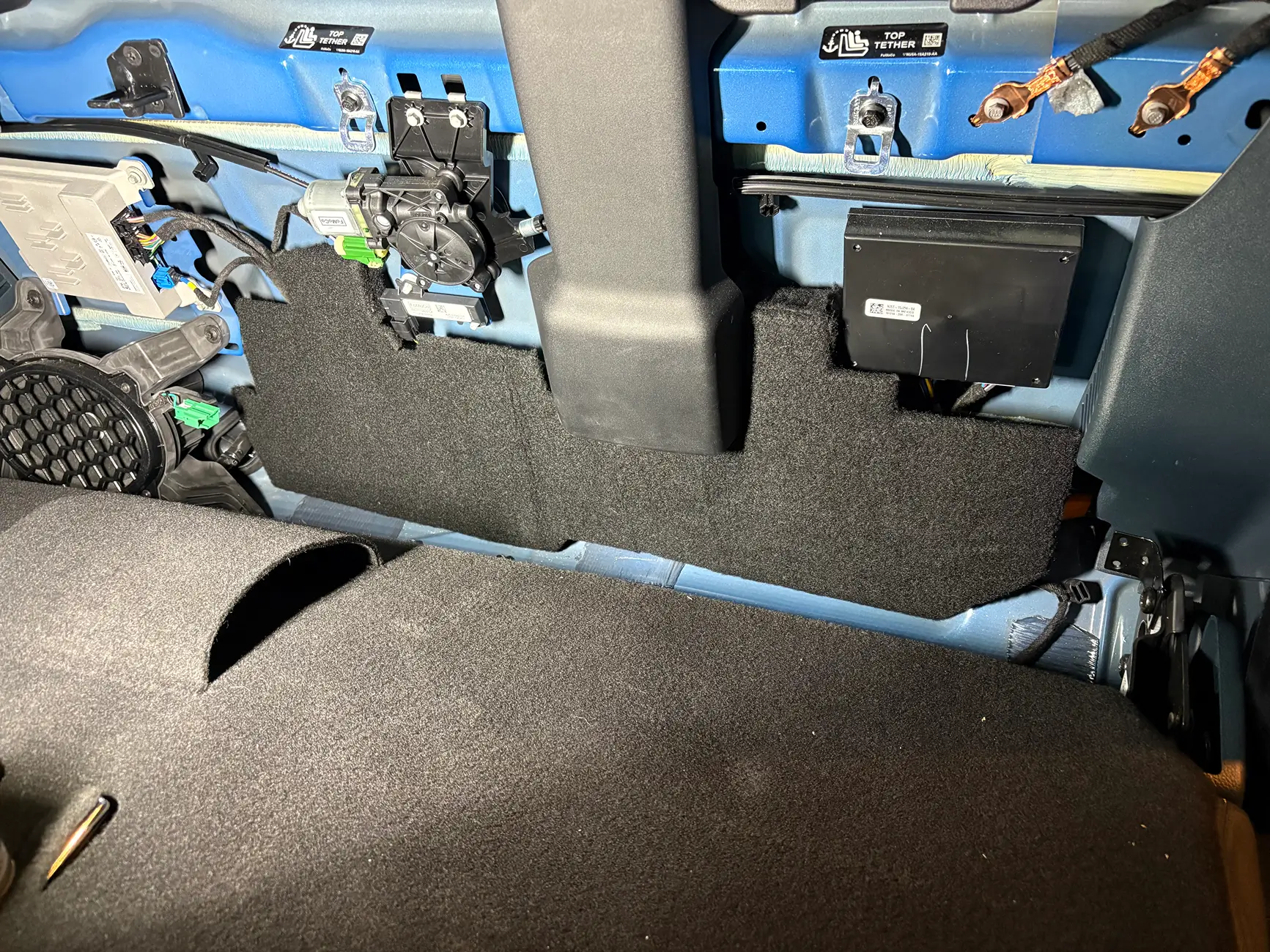

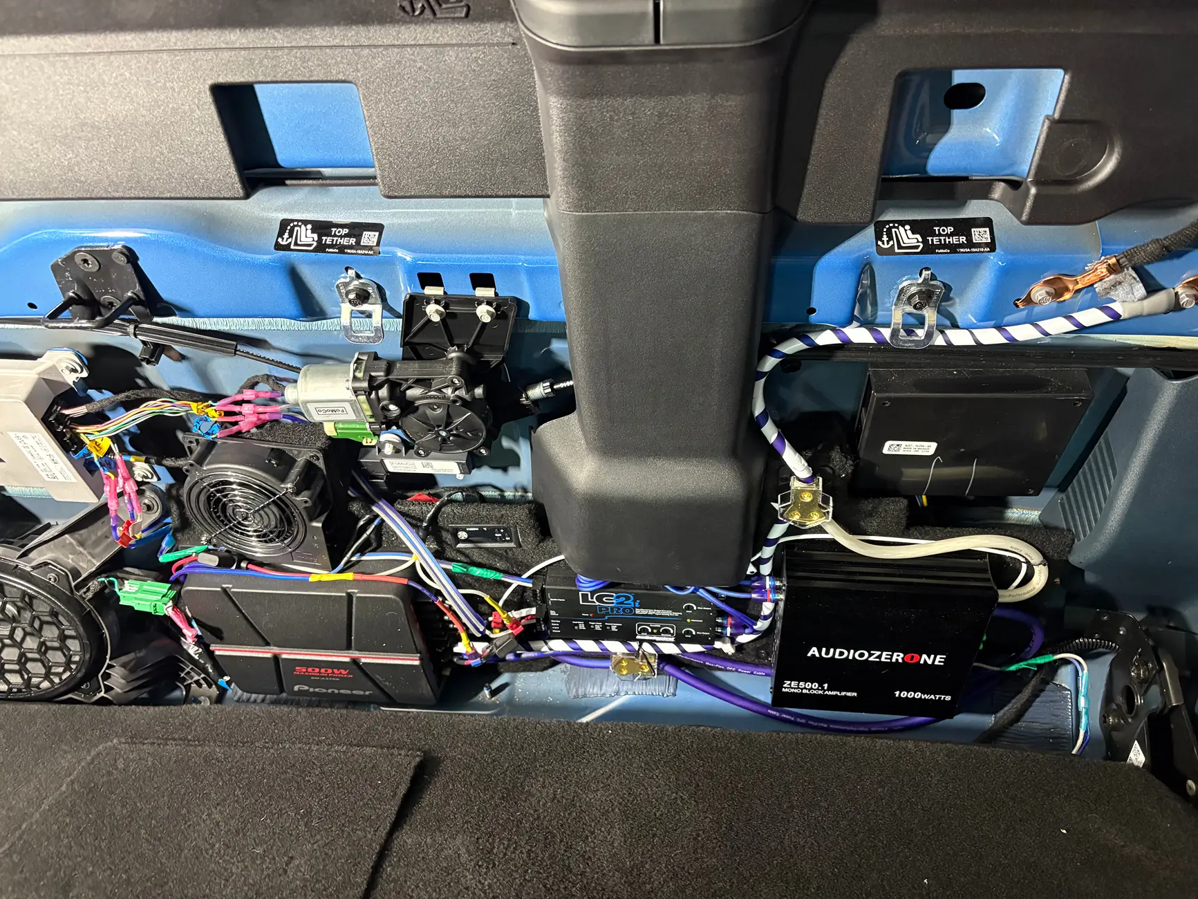

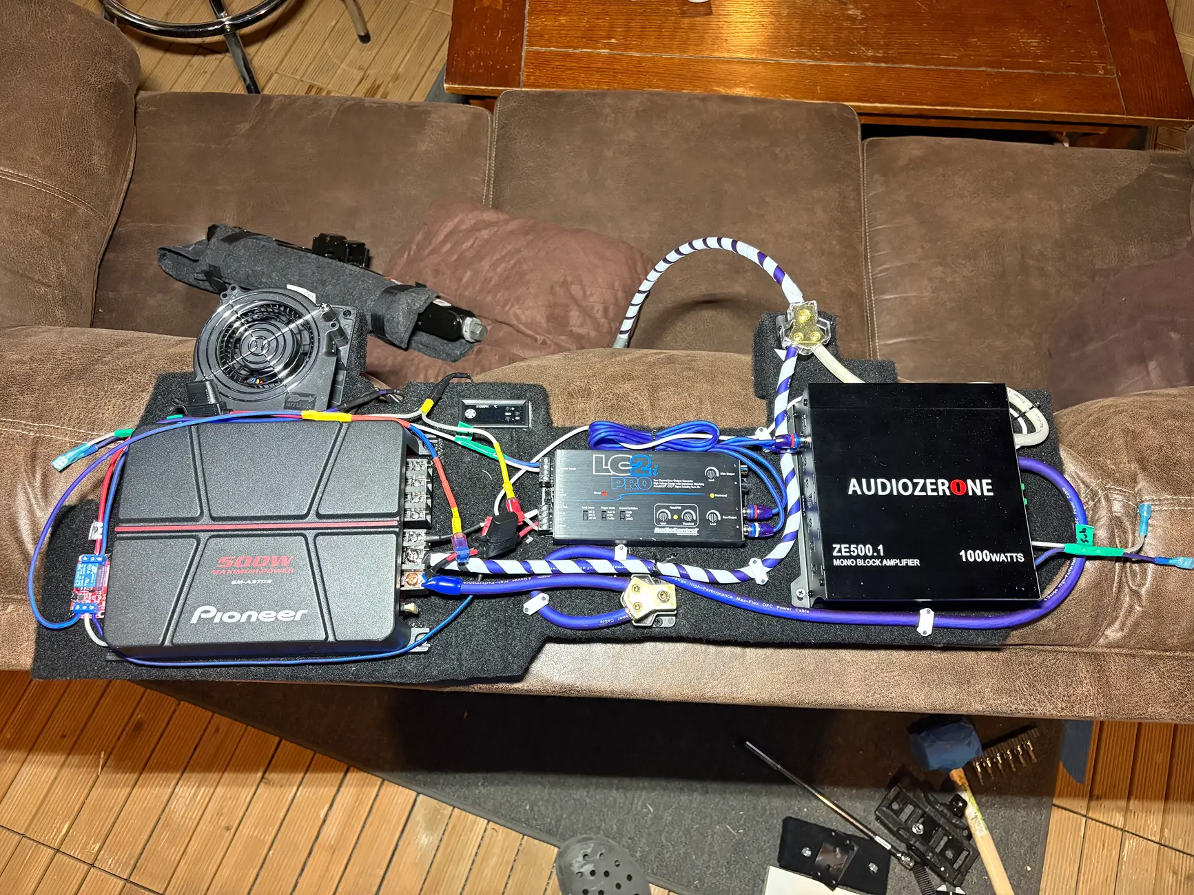

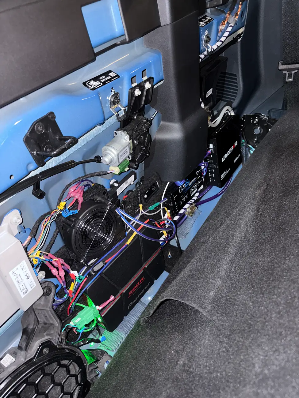

How is bin access impacted? I had to remove my ProLineX box as the lower seat cushion would not sit down correctly and the rubber stand offs would rub the box when I lowered it. Eager to get a 10" sub back in vs the 8 I have now.
As far as bin access the driver side can't be used but I still have the passenger side. As far as I can tell the enclosure does not interfere with the rubber feet on the bottom of the seat.
