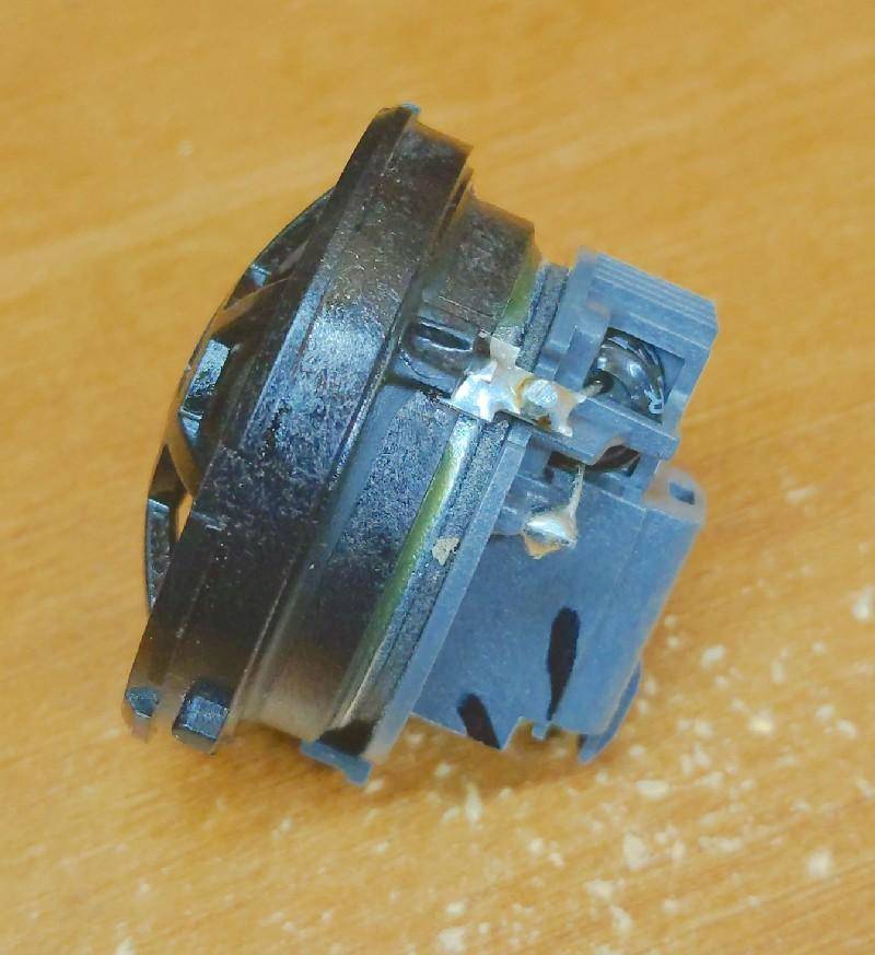

The stock tweeters do have bass blocking caps installed on them.
Even on B&O? I'll look at them again. I didn't see anything other than the connector built into the back of them. What's the best blocker to add to them instead of that clunky crossover box that came with the component set?

Unless they've changed the design they're there but mostly surrounded by plastic.

Looks identical to my 24. I just didn't even notice the capacitor in there. Would you recommend a specific bass blocker to install in line?

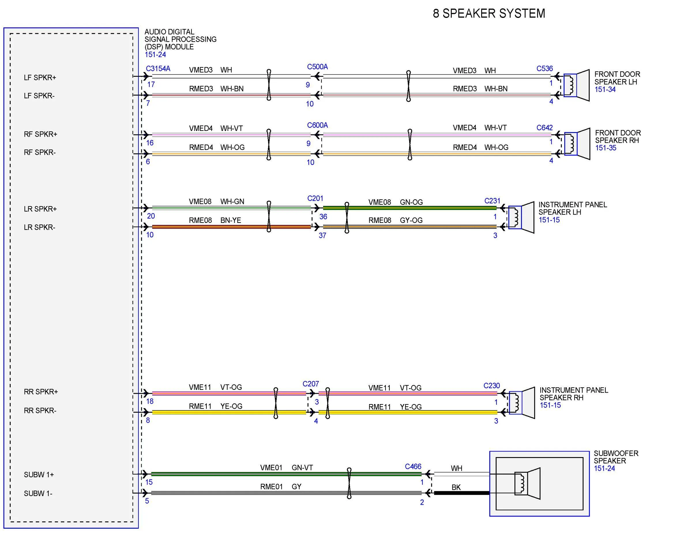

I just bought a pair of audiopipe bass blockers for $7.99 on Amazon. They'll be here tomorrow. I just hate having to take all that trim back apart and risk breaking clips again. Made it the first time with nothing broken.
You could also splice in at the rear wiring at the B&O amplifier itself.
Splicing in the back, you could also use the kicker x-over since there is more room to mount it
Not a bad idea! That would allow for some tweaking that way too!
