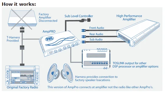

What harness can be used to bypass the b&o amp to use an aftermarket amp with out having to splice into the factory harness? And what amp would you recommend? Ty in advance
the audio module has a A2B digital output. not sure if it's here or in another thread but there's basically 3 options (and I've not done any of them):
Nav Zen - $780
PAC AmpPro - $440ish
Axxess AXDSPX-A2B2 $490
I did see that plugnplaykits has a T harness and shows a system diagram. If you're considering it, I'd suggest contacting them and asking if that harness intercepts and would allow you to amplify the center and rear channels, or if they remain powered by the ACIM. (The B&O amp powers the dash tweeter, door 6.5" and B&O 6x9 sub. Does not amplify the center and rear speakers.)
https://plugnplaykits.com/products/fd31-interface-for-the-2018-and-up-with-b-o-premium-sound
