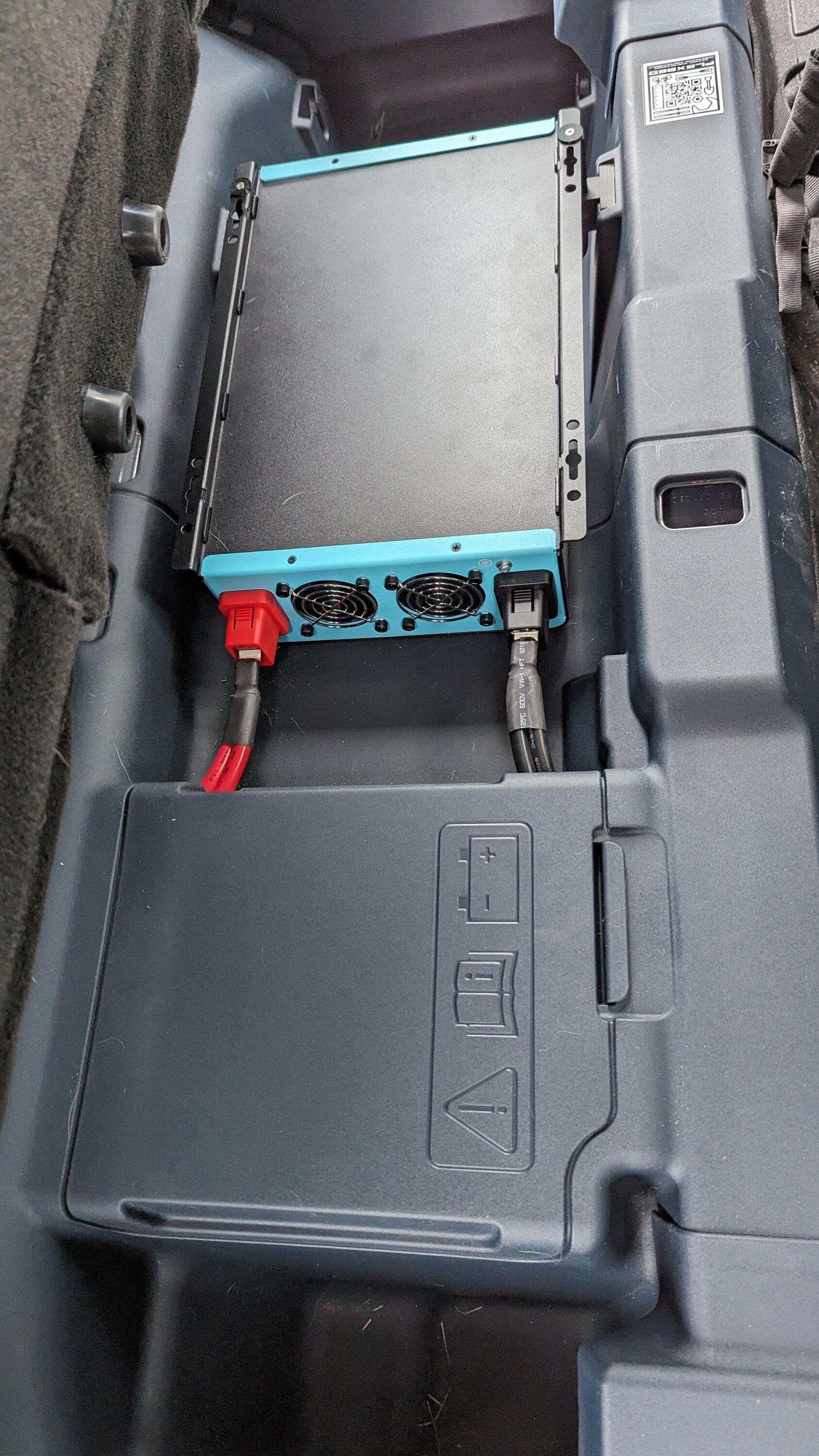

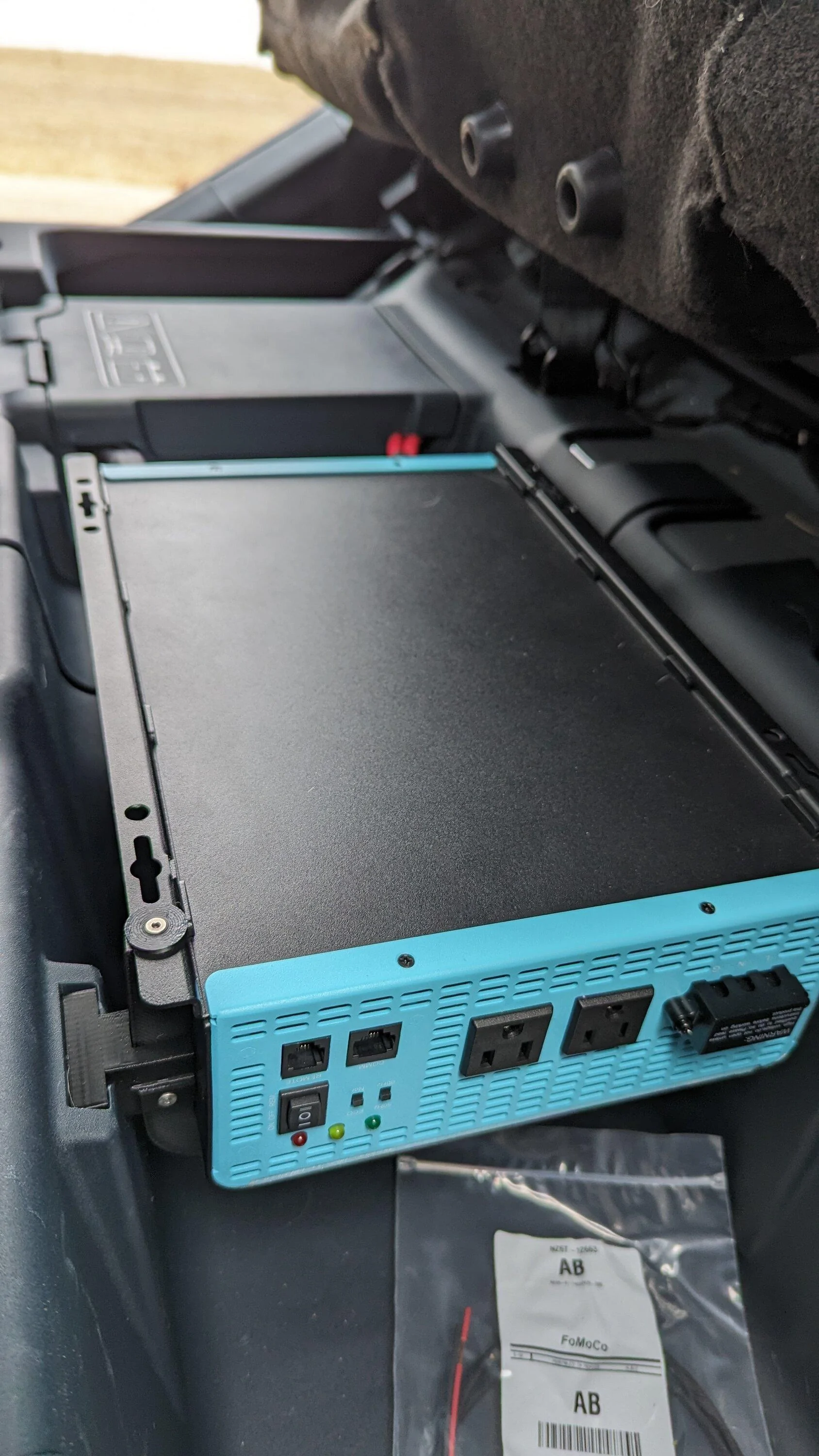

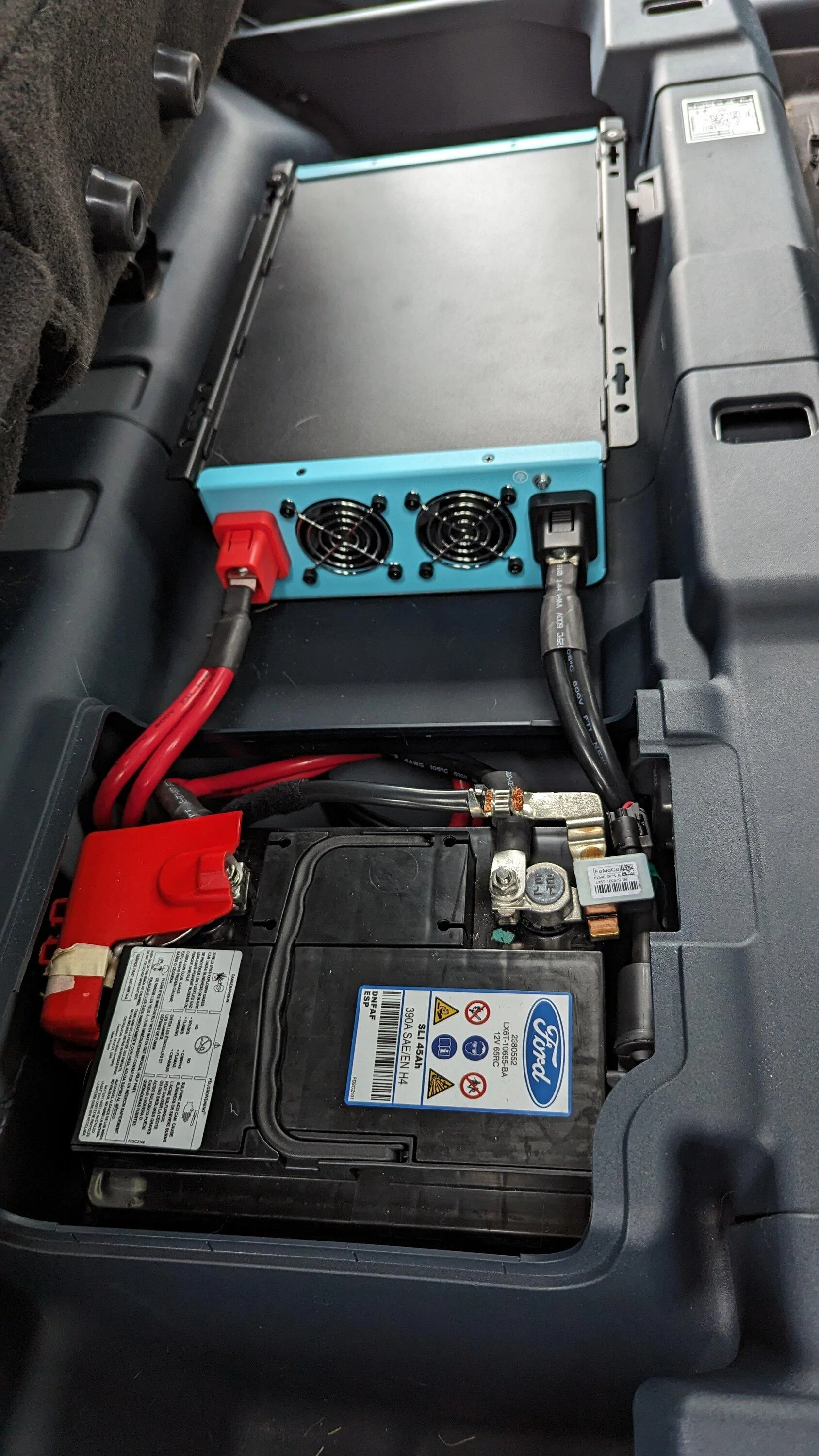

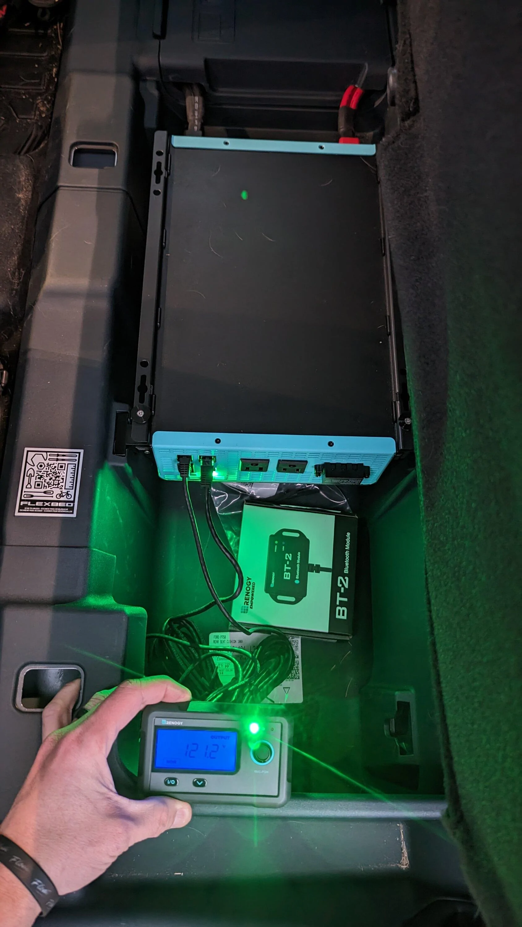

Honestly the biggest appeal for me on the inverter was being able to charge my OneWheel off of it.
Fellow onewheeler here. I just added a 2000w inverter under the back seat. I use the outlet on the bed to slowly charge my battery bank power station. Between those 2 I can charge 5 VESC boards at once on trail days. I have the hybrid so it makes the inverter a much more viable option.

Hi thank you for posting this. I have a 2K inverter and am in the process of installing it. Any Issues? Have you ran a outlet to the bed. Can I get a pic of the battery cover. Did you have to make cuts in it? I never thought of flipping the inverter over.
Clever use of the FITS anchor points as support for your inverter.
What brand Inverter Did you use? Did You run a Plug to the Bed Cubby Panel?
This one is a renogy inverter. I have not run additional outlets to the bed yet, but I have ideas about doing that eventually and putting the remote control panel (switch) mounted back there as well. It will be a while. I just got my Elevate ts rails and bak x4s tonneau cover installed today. Next step is a bed rack and a tent mounted on it. This won't happen quickly, but it's my plan over the next year or two
