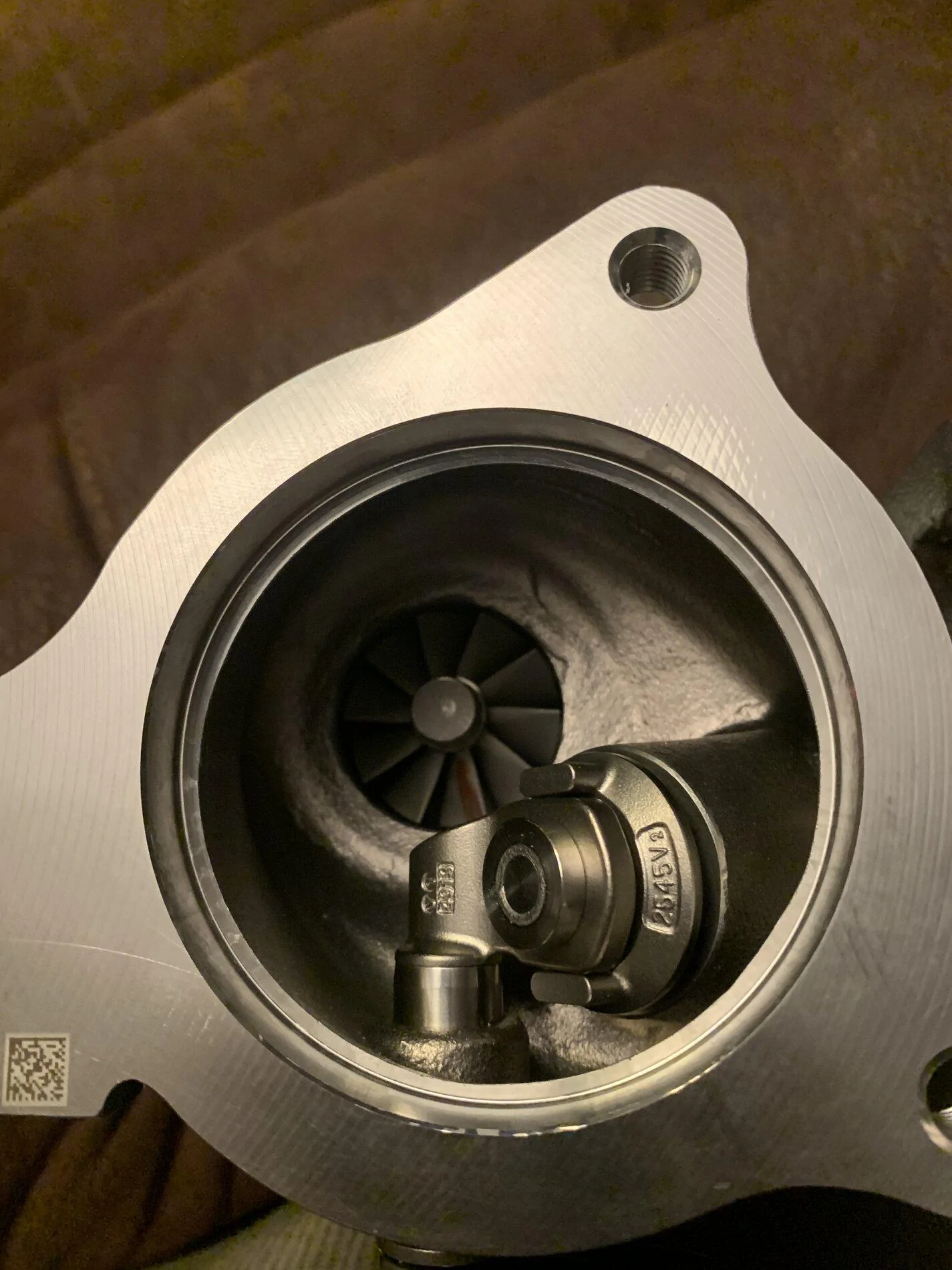

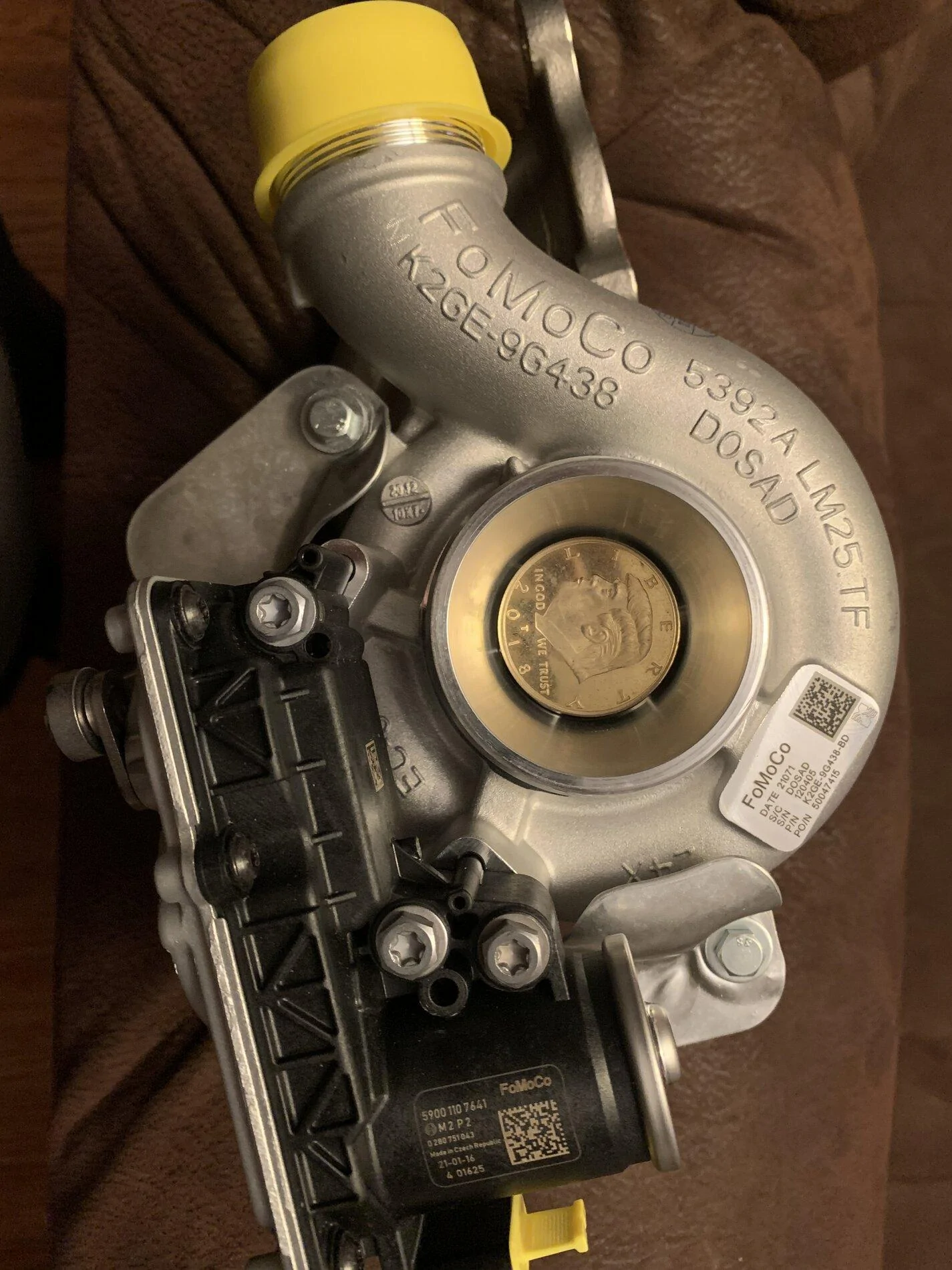

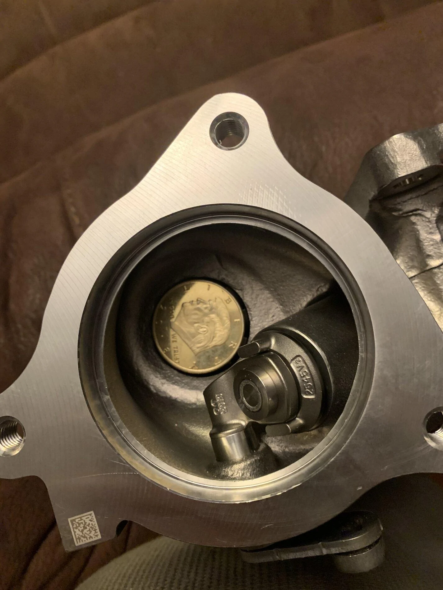

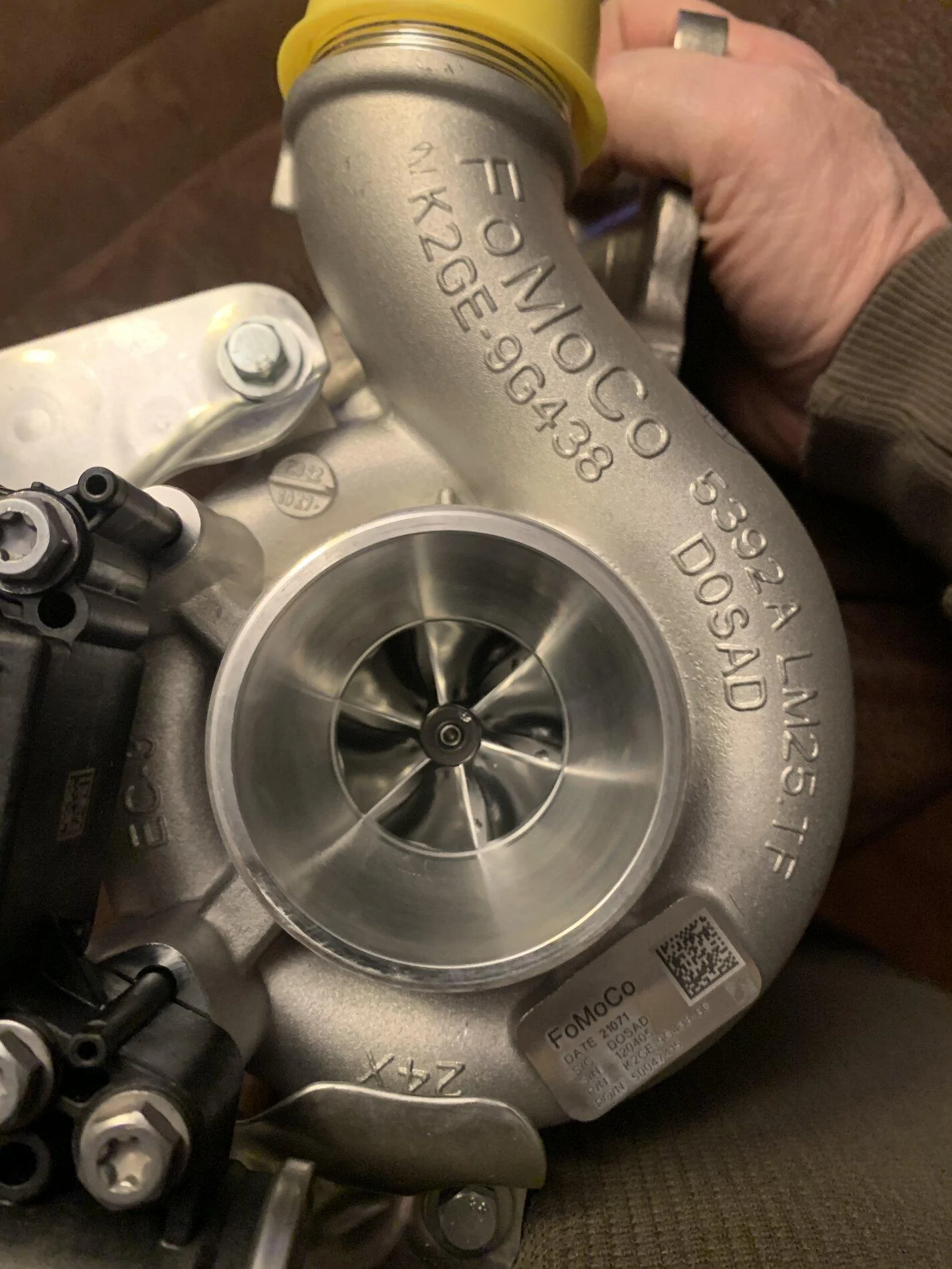

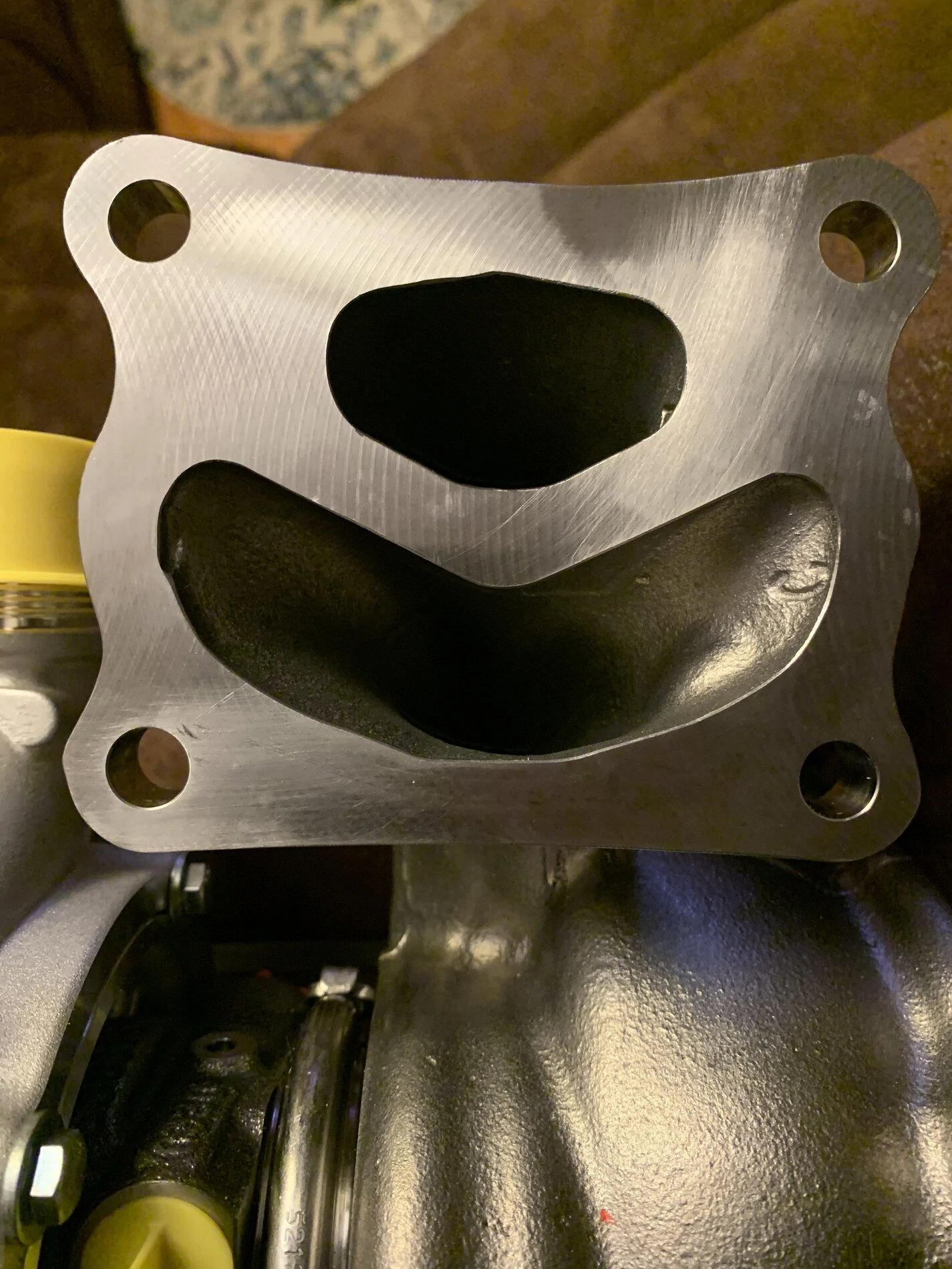

Morning!
We ordered a new replacement turbo for the Maverick. Judging from the tuning and dyno results we are seeing there are many things holding the engine back from making any big power numbers, the turbo is definitely one of those!
We dropped the secondary cat yesterday in search of more power. This also proved what the exhaust did, the computer with the stock tune became even more unhappy cutting power back even more. After a change to the tune power came back and is more repeatable without so much heat being registered in the primary cat.
The turbo is small, smallest I've seen on a 2.0 engine. Explains the great response but also explains why it's tough to have large increases in power/torque/boost levels.
The turbo is being sent out to our turbo builder today, we've been working closely with and setting a lot of records with Forced Performance/Xona Rotor for many-many years. They are going to work some magic on this and by the time we get it back here our production exhausts, intercooler, downpipe etc., should all be done and available. It will fall right in place with everything. Turbos will then be available through us for the trucks.
Attached are some pictures.

Twin-Scroll?

The main problem I see with that turbo is it is plugged up with a .... oh, nevermind, can't go there.

Just curious if this turbo is smaller than Ford's other vehicles with 2.0T engines (Focus ST, Edge, Escape etc..)
