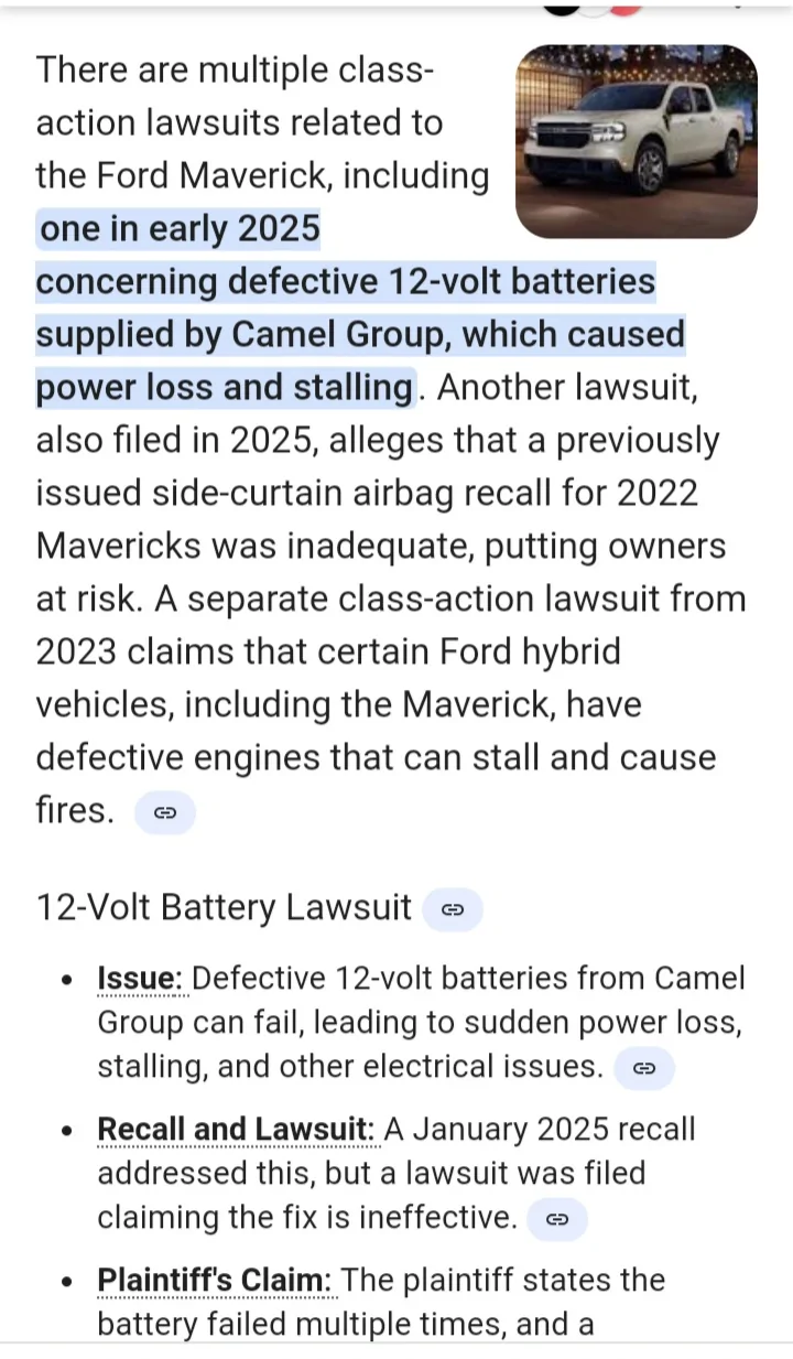

After 3 battery replacements in 14mo and the ACC SSM updated last May i was left dead again this week after only 1 day idle. Truck spent 3 days at Ford and Ford Customer Care acknowledged Hybrids have an issue and approved a replacement to an AGM ( i have been asking for a year) at No Charge. I am happy i now have AGM battery. Do i think my issues with parasitic draw are over? Not a chance which is what i told the service manager.
There is now a class action lawsuit for bad batteries.
Along with others on the Maverick.

Isn't Camel the bad FLA batteries used in a short run of EB models?
At least that recall happened after they determined it was a bad battery.
But that too had a software update first to try to get better at seeing a potential battery issue so the auto start/stop would be disabled before you got stranded in a bad spot.
I'm betting the defective engine one is requiring a lot more logging of what serial number part went where.
I'd still like to hear the inside scoop on that one - surely they logged that already. Did someone delete a file, supplied lost it, how long a run was the potential bearing issue there, besides the truck run dates assembled.
Maybe that lawsuit will bring out those details.
