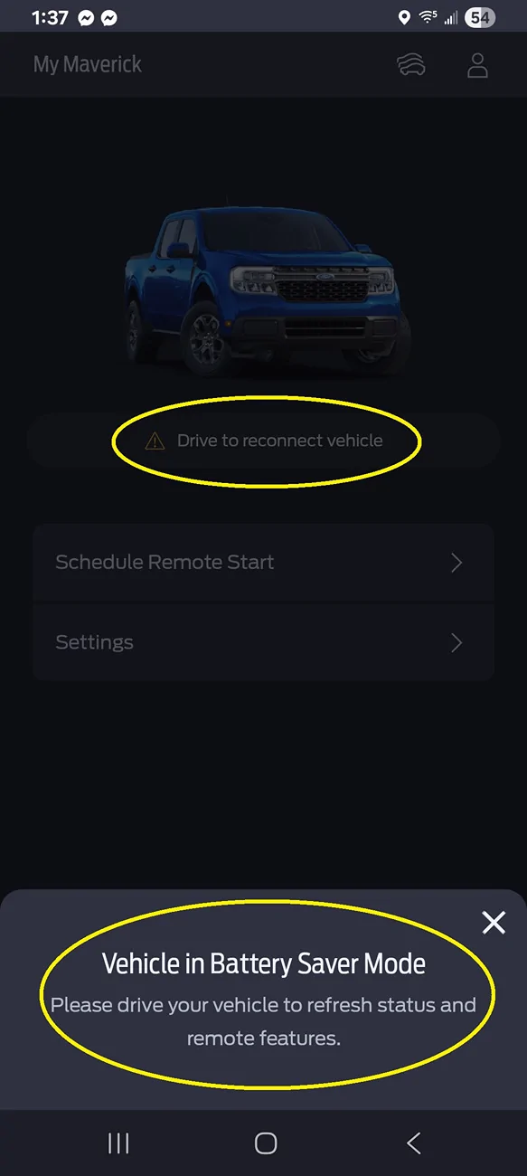

Well I fully charged the battery and did a BMS reset and let it sit for 10 hours with doors locked. Worked great yesterday. Woke up this morning to a deep sleep mode message. I'll go see if it starts when I leave for work. Ugh. Ford needs to fix this! Guess I may be testing out my new battery booster this am.

I dropped off Maverick off Thursday morning at the dealer. They told me later that the NAPA AGM battery that they replaced a year ago was charged at 30%. They will charge battery, then run the SSM 53801 procedure, but want to keep the truck overnight to have a test drive in the morning. The NAPA battery was good, and Thursday evening Ford App worked, and showed truck's location at dealer's parking lot. At 7:30 AM Friday, before they opened, App showed the low battery message again. This proved that the "air conditioning control module (ACCM) software update" was unnecessary, and did not fix the drain issue. Their drive test didn't help either, right after the drive the App message was still asking to "Drive to reconnect vehicle", no amount of driving ever fixed such message, so I am stuck again, and dealer has no solution at hand. Sort of amazing that since Ford released the first Ford Maverick they are still unable to fix the 12V battery issue. I guess they are waiting for a class action lawsuit, since the new truck buyers are kept in the dark about the problem, and Ford removed the low battery warning light from the dashboard as not to alert to the issue.
