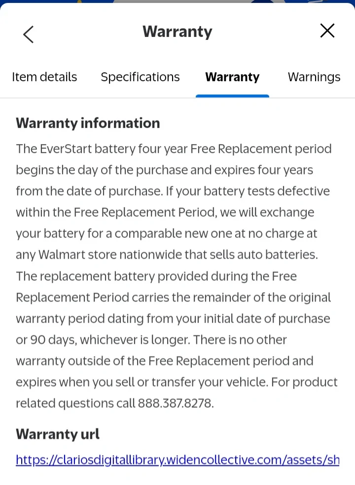

When the time comes to replace my battery. I plan on going with the much more expensive $189 H4 AGM Battery from Walmart that has a 4-year replacement warranty.
