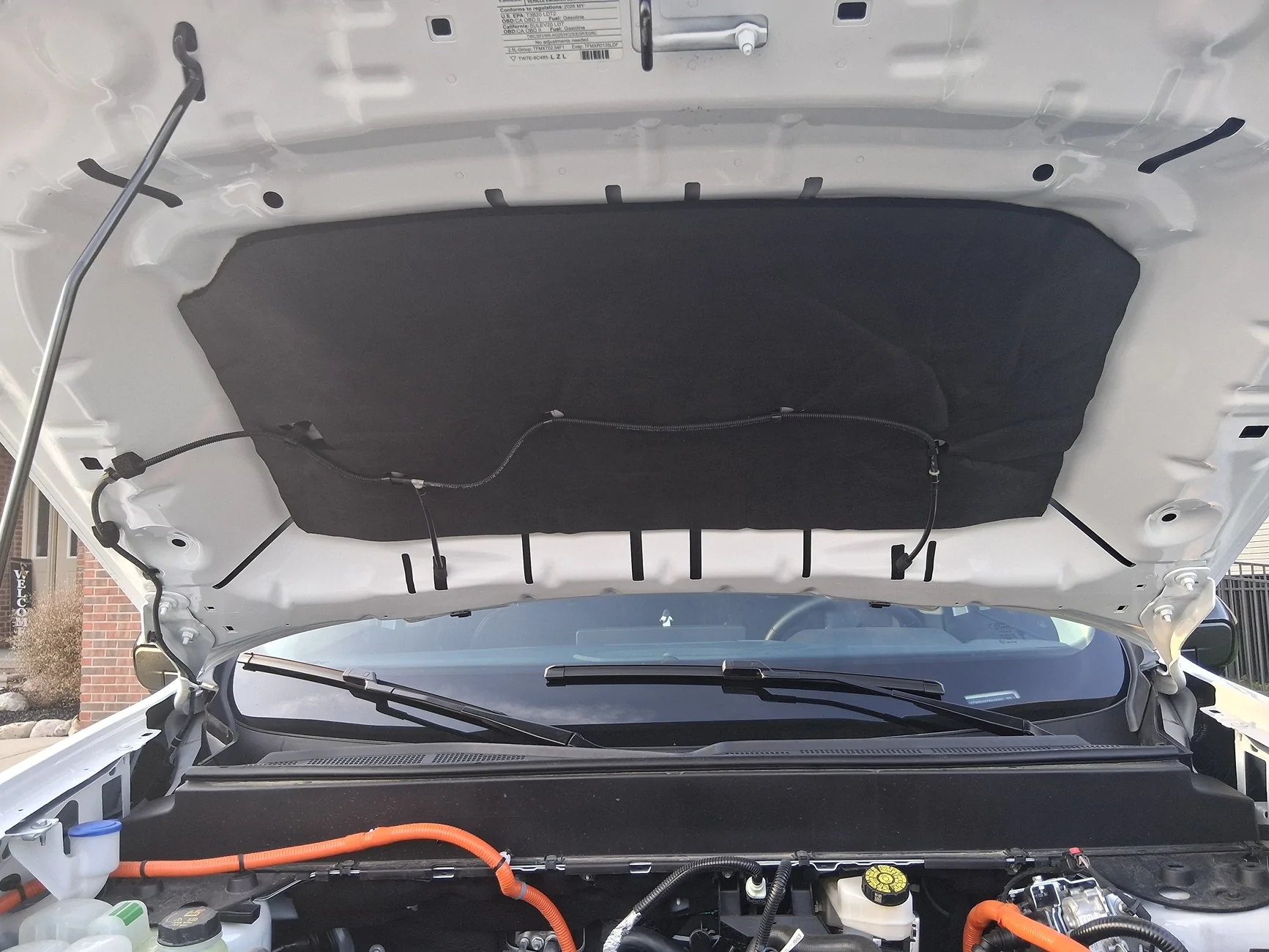

what about this?
https://www.walmart.com/ip/Soundpro...41943EC388E3EB82F3A8519C&conditionGroupCode=1
oh, and a little stick on sound deadener first
ebay, same thing $58, if you all are interested I'll let you know how much of a piece of crap it is.....
ha!

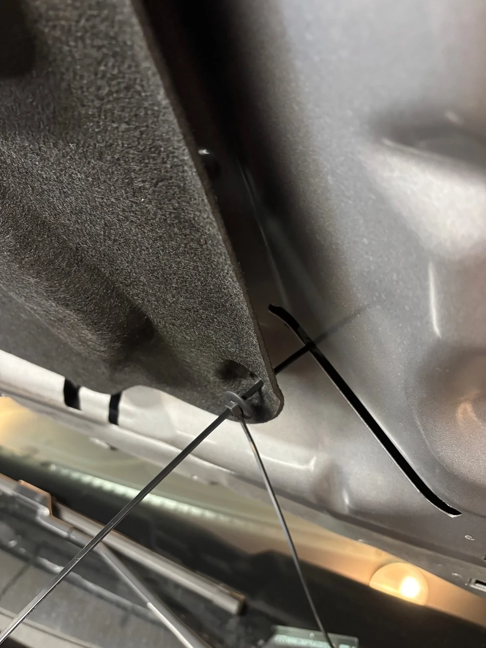

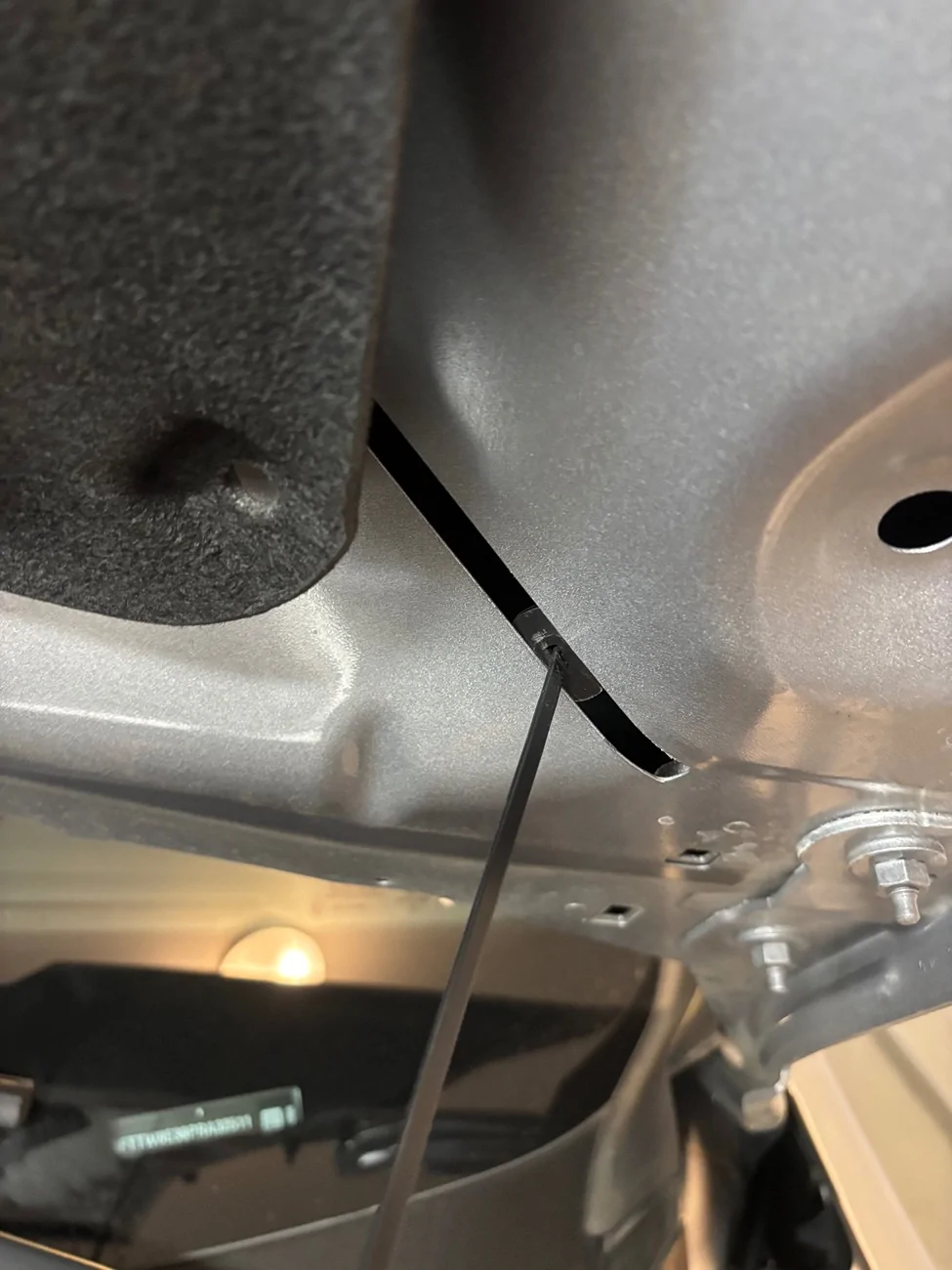

Well, it’s installed. The outer most bottom fasteners are a complete joke. I used two wire ties with plastic washers instead.
Other than that, I think it’s a good product. I put some sound deadener in there in the spaces that are open before I installed it. I can’t tell if it made a difference in sound though. I seriously doubt it.

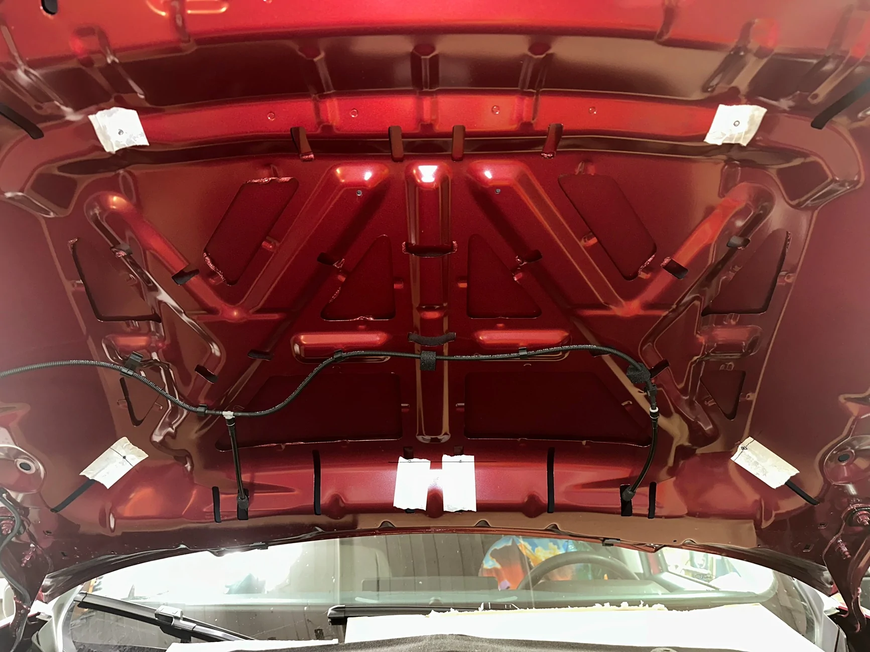

Apparently I scared everybody away ! Getting back on topic here, I ended up buying one as mentioned in post # 118. The hood pad itself is pretty good BUT the hardware and instructions (lack thereof) totally suck! Like most Chinese modification items for just about anything, you had better have some "MacGyver" alteration skills for the best outcome.
Similar to "CarbongrayFX4 .. Luke" in post # 18, I had to alter the installation process quite heavily to accept some plastic push pins to hold up the hood liner. Lots of extra work BUT I'm a bit anal when it comes to clean installations, so the extra time taken doesn't bother me. Turned out REAL nice ... just don't ask me how many hours it took me! 😮 Some pics below showing the progress ..........
Ford Maverick Unhood Insulation IMG_8939
Here I Placed wide masking tape in the rough areas where the push pins will go. Then temporarily held up the hood liner and marked all fastening areas. Got "close" as there is a lot of forgiveness to this installation.

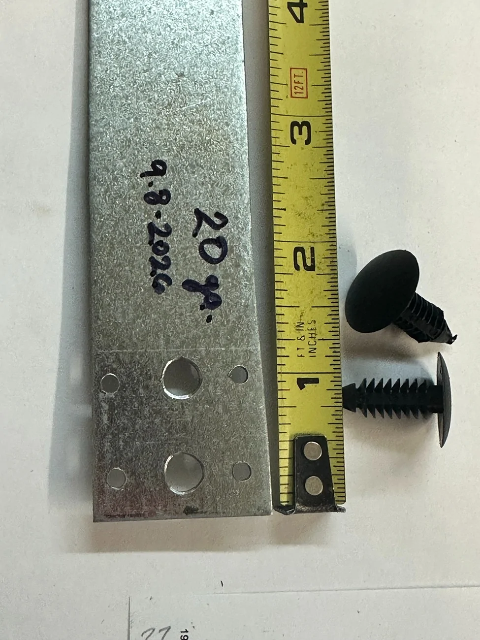

I made the receptacle sections for the push pins out of scrap 20 gauge metal. These were then riveted in place as shown in the next pic.

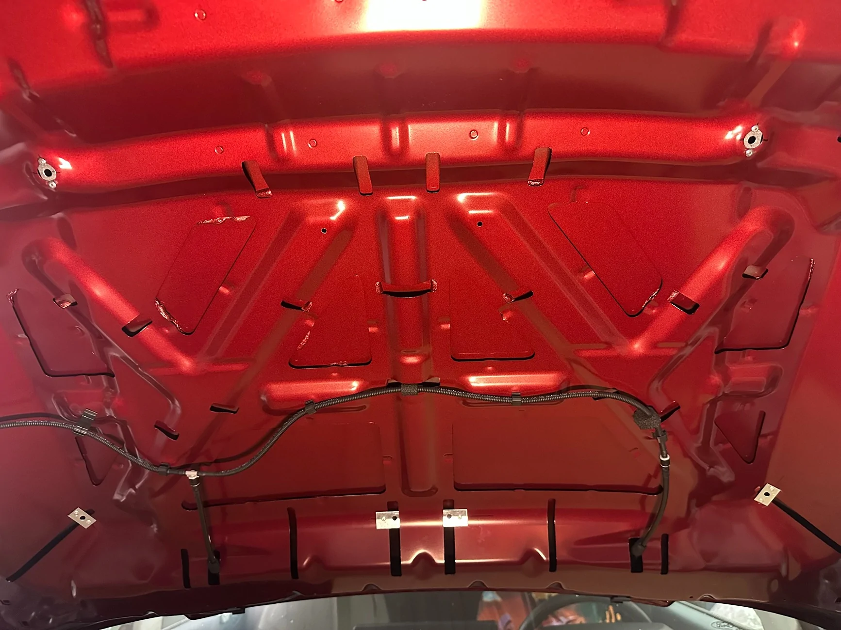

Ford Maverick Unhood Insulation IMG_8947
An overall shot of all pieces mounted and awaiting the hood liner & push pins.

Very clean installation with minimal gaps. I only used the two smaller push pins (recessed two anchor points toward front/center of hood) that came with the kit. Everything else got pitched. I added just two additional push pin anchor points. The fit was so good that it doesn't require a bunch more. Despite the extra work involved, I'm very happy with the outcome.

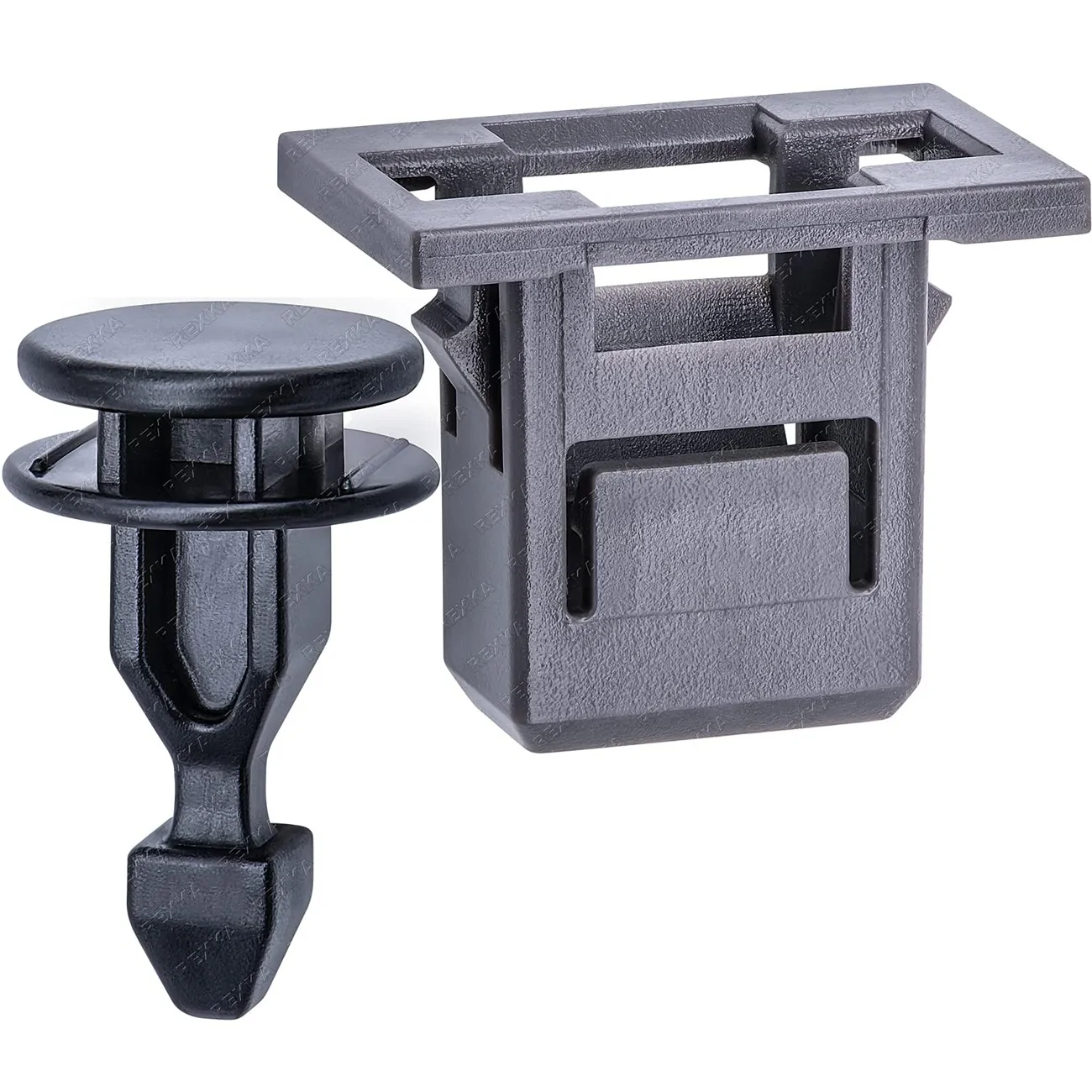

I used these two piece Honda fastener in the channels that were too wide for a plastic rivet.
91547-TZ5-A02

This is a great idea too!
