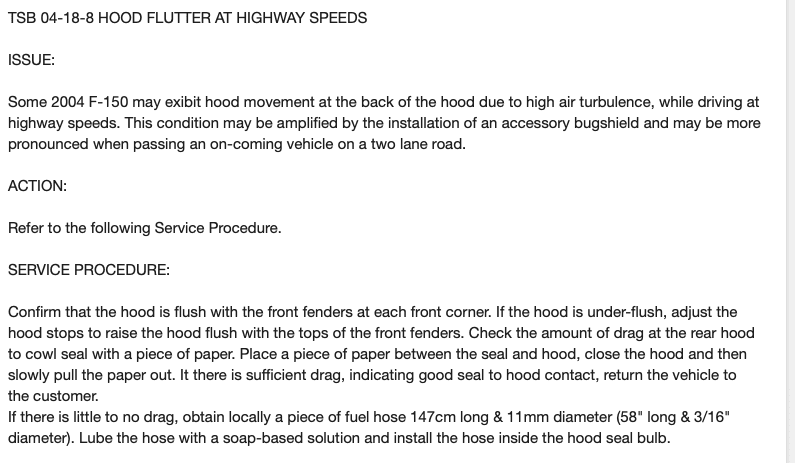

FYI, here is a Hood Flutter Correction service procedure from Ford:
I have previously done this 3 weeks ago it help a tad . Maybe I found a combo lol
