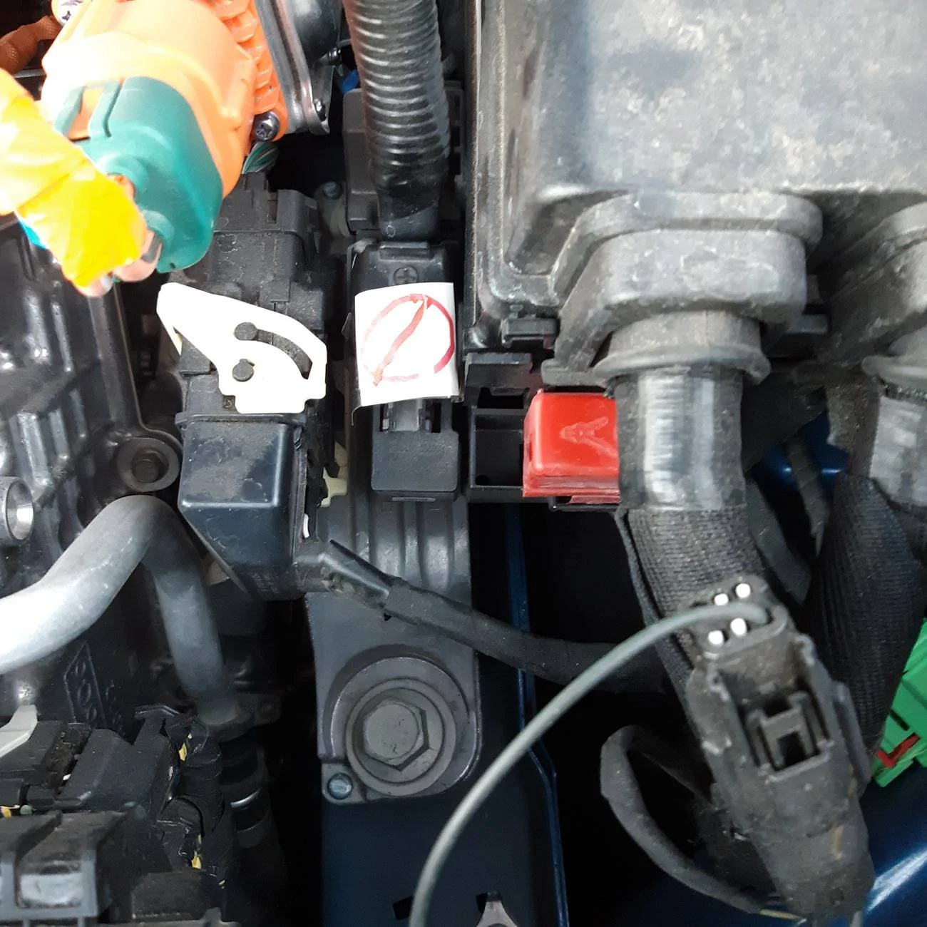

I do think OP should have known better but it is pretty disingenuous of Ford to put a black cover cap next to a red one - even with the + and little X over the battery clamp.

Putting a black plastic cover next to a similar red positive cover is just plain bad engineering. It should not have been similar and definitely not black, another color like yellow with an inlayed black pictogram would have stopped someone from assuming that it is a negative.

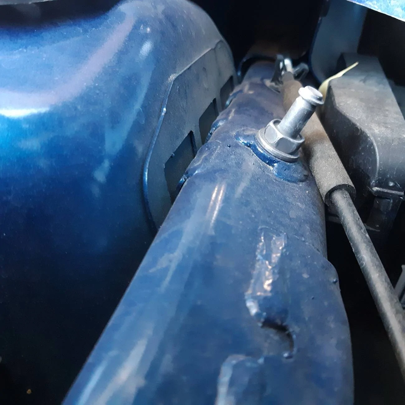

My low tech solution so I don't end up connecting to the wrong area.
I'm old and it could happen.
I'd rather it look stupid but save me from a mistake.
It probably won't last in the spring cleaning when I hose down the engine again.
This bolt seems to be made so a clamp won't slip off. ​

OP bailed! Hey man, no worries. I might have thought the same thing given that there is a black and red cover on each of those.

I had to jump the 12v battery last week and couldn't do it via the power points under the hood, so I went to the battery posts and got the truck started, and it got me thinking: do my power points actually function? My battery tender showed no connection but it needs a minimum amount of charge detected in the battery to work, so I decided to put a multimeter on the power points (after fully charging the battery), and there's zero voltage on the meter. The Ford dealer will be looking into it today but I wanted to suggest you check your underhood power points, just in case...and I purchased a NORCO GB40 Boost+ jump box and it shows no connection when attached to the jump points. Good thing I discovered this in the driveway!
Your post and confusion is valid. Ford has confusing positive / negative graphics on items that are not related to the 12v. The positive is hidden under a red cap; the negative is a body bolt on the right.
I wonder what would happen if someone put a positive jump box lead on that black covered positive connection and the negative jump box lead on the correct post?
