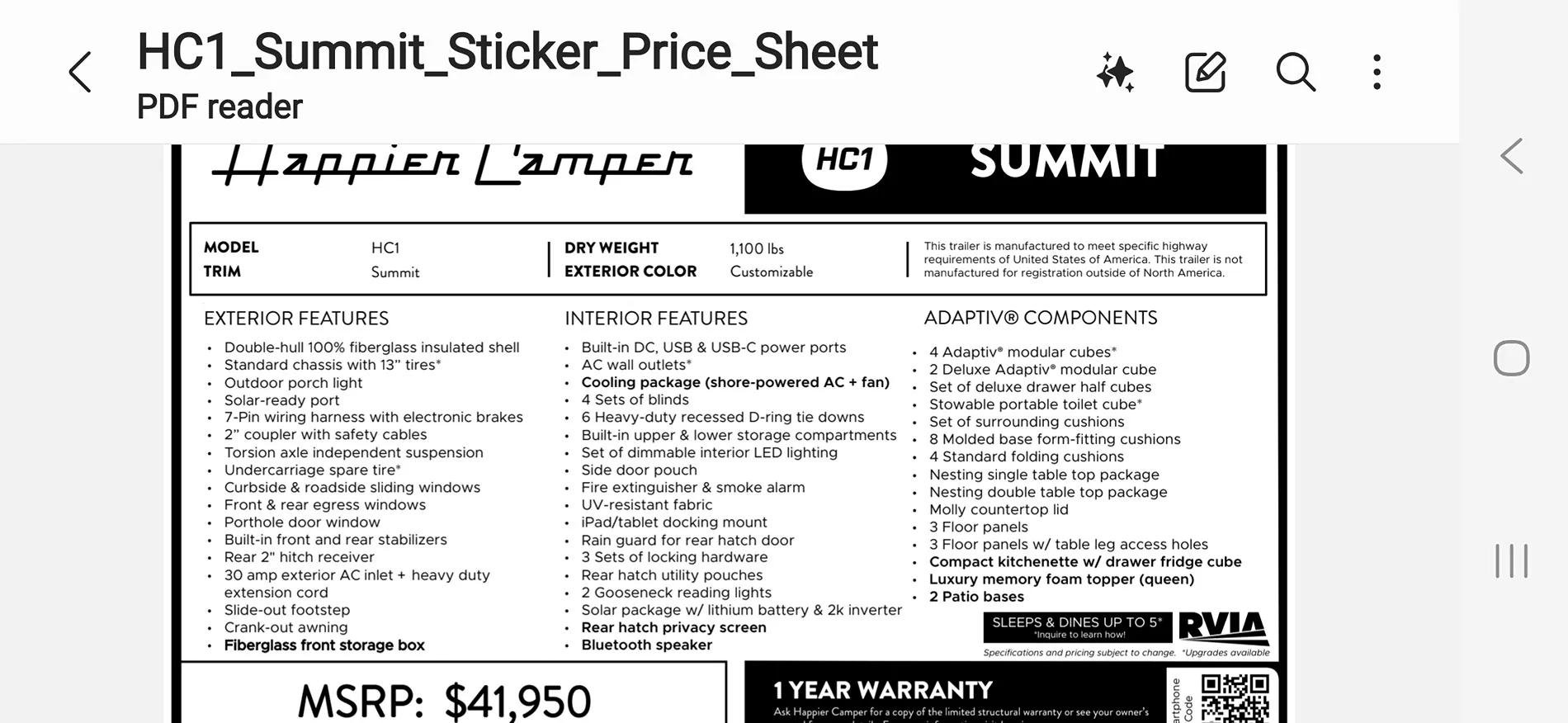

Hello again, @Sire777
I just looked at "HAPPIER CAMPER" trailers, and they look very nice! I know I have camped in much lesser trailers over the years.
Here is the info sheet on one of the more expensive models.
Have a good one
Andy

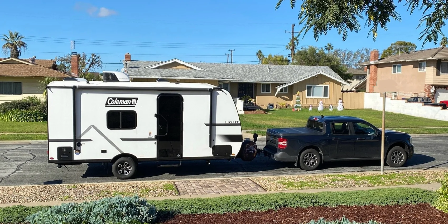

Under 2,000 lbs is tough to find.
Under 3,000 lbs opens up many more possibilities.
Contrary to what some will say, you CAN tow 3,000 lbs with your truck if your trailer has brakes AND you add a trailer brake controller AND you always keep your speed under 65 MPH.
The 2022 FWD Hybrid does well for me at up to 65 MPH and I like to keep it about 62 MPH ( 100 KPH ).
This one is 2750 lbs unloaded and has flush toilet and full size shower. Only sleeps two adults and possibly a small child or two if you fold down the kitchen table.
A great option for a couple.
Works for us.
The build quality (and price) for $15k is definitely entry level. But gets the job done.
It's a 2025 and I've used it five trips in western states mountains and pulled it about 3,000 trouble-free miles so far.
Air drag is worse than the weight.
Good luck on your search.
If it's your first trailer you might want to start smaller. I've been towing for 25 years and am comfortable with this setup and the truck does well.
I added a brake controller. Ford does not provide one for a FWD hybrid but there are $100 to $200 after market options.
