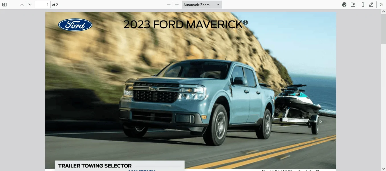

Thank you.Ford publishes a towing guide that contains all calculations and limitations for every model. Go to Ford website under towing and download it.
