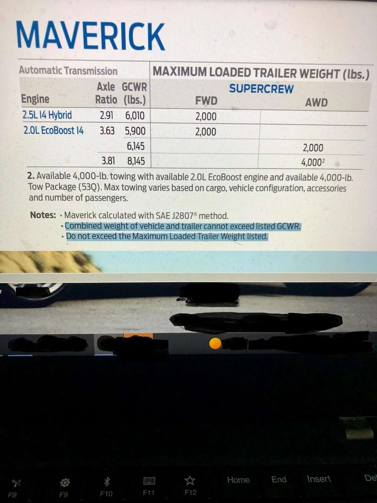

If we are looking for actual facts, here are the factual Maverick Tow Ratings from Ford. Not what the truck might be able to do, not what someone's brother-in-law or friend told them 20 years ago, but the actual published Maverick Tow Ratings from Ford.
Page 38 of the Ford towing guide: https://www.fleet.ford.com/content/...-guides/2022_Ford_RVandTrailerTowingGuide.pdf
The advertised base curb weight for a Hybrid (with zero accessories, fuel, occupants, etc.) is 3674 lbs.
Plugging in a few weights:
3674 base curb weight
180 (1 driver, zero passengers)
100 (14 gallons of fuel)
2000 loaded trailer on its tires (trailer weight)
200 (10% tongue weight of 2200 trailer on ball becomes truck payload)
6154 total on a zero option XL (54 lbs over stated GCWR)
Ford notes below:
* Combined weight of vehicle and trailer cannot exceed the listed GCWR (6,100 lbs)
* Do not exceed the Maximum Loaded Trailer Weight listed (2,000 lbs)
Ford Maverick Can low trailer wind resistance increase towing weight? xGUsVP
Not my numbers, wishes, thoughts or hopes, these are directly from Ford.....
You don't have as many fried foods where you live, do you? I haven't weighed 180 since before I joined the Army 20 years ago.
(Yes, I get the point of the math. I just found that number funny.)

LOL, I WISH I weighed 180, LOL .
I just chose a random low number. I don't really care how anyone tows provided they don't hurt me or my family, but it's important for those new to towing to know the OEMs actual ratings.....
