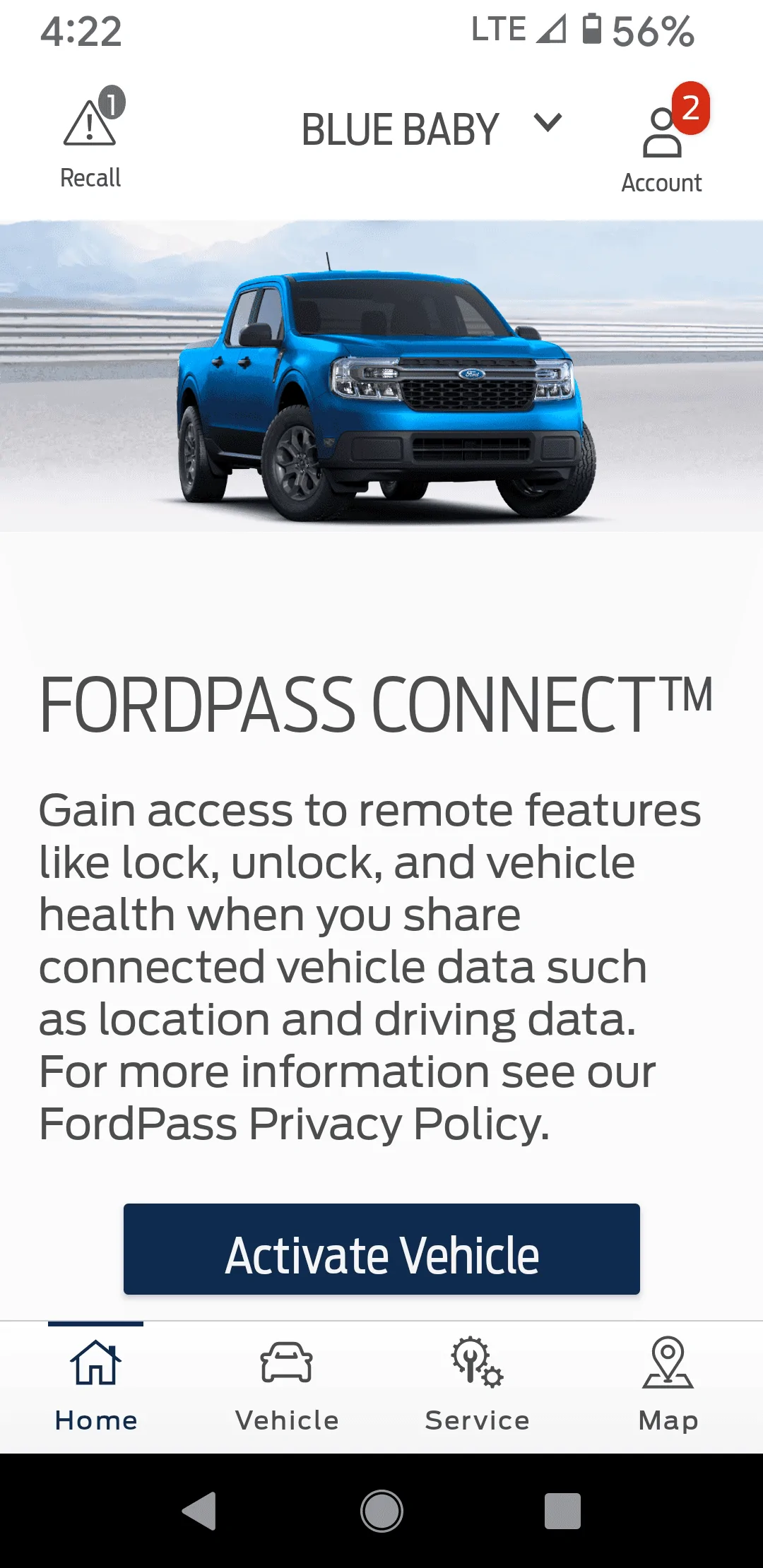

My Fordpass app just inform me about the recall. Hopefully they'll do it as soon as it arrives.
Ford Maverick Trailer brake programming Recall 22S17 Screenshot_20220404-162228
