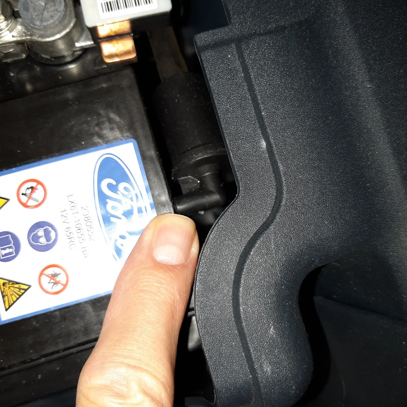

All of a sudden I'm starting to see SLA instead of flooded battery.
Are we still referring to the oem Motorcraft batteries
From my understanding an SLA is a sealed lead acid battery and contains no venting whereas our flooded batteries have to be vented.
Venting tube on my OEM Flooded battery👇

Mike,
I'm a little confused.
From the internet👇
Contrast to the flooded battery, a sealed lead-acid battery requires no maintenance and do not require venting which is a large selling point for those that do not want to deal with battery maintenance.
I was using FLA also, and reminded those have the vent caps that can be removed.
We have SLA, which is still FLA, but sealed. You better believe it sitting in the cabin.
They have pressure relieve valves in them in case overcharged. They don't vent.
And I'm betting the "valves" are nothing more than thin plastic area that is designed to give at certain PSI. Eh, maybe they close again once pressure relieved.
ETA - when was the last time you added distilled water to a battery? We have maintenance free.
Pry that cap off with vent tube, and you'll see the real sealed caps and the pressure relief valve.

Mike,
Venting tube on OEM Flooded battery👇
From the internet👇
Turn that battery sideways or upside down.
It will not leak, because it's sealed.
If the pressure relieve valve should blow due to overcharging - that vent tube is required for the gases to not be in the cabin.
That wimpy cover can come off exposing the sealed covers and PRV.
That vent tube on the wimpy cover is not the PRV.
